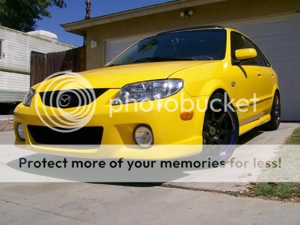

Just bought a DG lip today! Who knows how long it's going to be before I get it painted and installed but just figured I'd share. How do these things attach anyway? Mine didn't come with any hardware and there aren't any pre-drilled holes in the lip. It can't all be double-sided tape, right?
dgftw!
^^^ Very nice although I have to admit it's hard not to stare at altspace's RX8. I plan on getting some bronze wheels and red lugnuts in the future so my P5 will have that same theme going on. Man, I should really try to make it up there for some of your meets. If only it weren't so far...

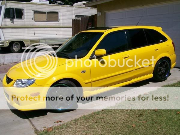

Jeff, did you forget to paint one of your amber bumper markers. Your drivers side is either dirty or kinda painted and the pass side looks unpainted.
And holy height!! ;)
the thing has 205/50s on it now lol they've been on there since we've had it...they just look so damn chunky lol
