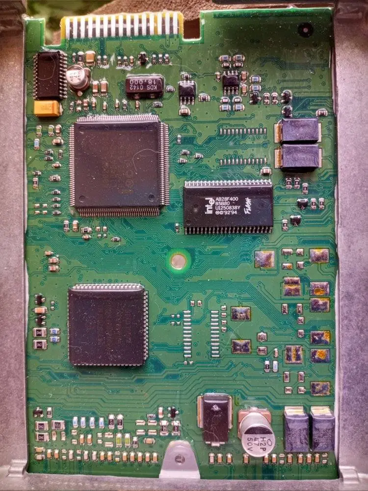

I put in a MP3 ECU this morning. I had the battery unplugged and the ECU will now need to relearn. At this point, I can't tell any difference with the new ECU installed. I haven't done any supporting mods for the intake/exhaust/VTCS, but I am at least running 91+ octane as my JDM FS-DE wants it.

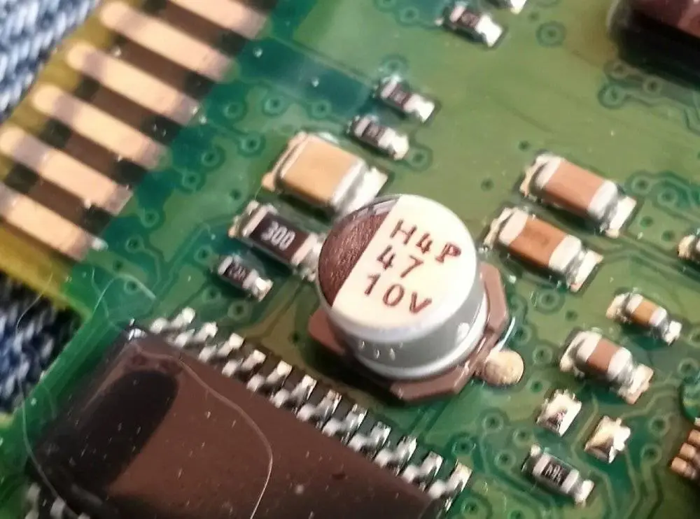

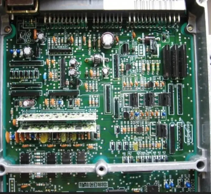

My wife's '93 Civic ECU Arced out to the cover due to old leaking electrolytic capacitors on the main-board that failed due to age/high humidity conditions.
I don't remember that being an issue with our ECU's.
I only recall a couple if people that fixed their car by replacing the ECU.

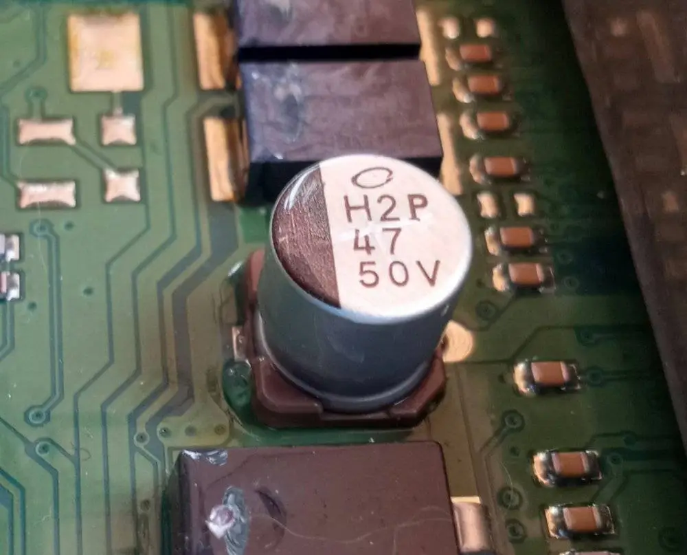

Our ECU's only have two capacitors, (they look to be electrolytic?) and the entire board itself is dipped in a coating before the capacitors are plugged into the board. (the capacitors aren't coated.)
I suppose the capacitors could still fail and affect the ECU, but the board itself looks acid proof.
When the ECU blows nothing goes...and everything else seems to get looked at/changed out first.

Oh, and I ordered one of these this afternoon. I had asked the local technician about flashing it to the latest release and he said he believed he could, but the part I ordered is already the most recent, a "C" revision.
Just wondering,...
Is this the ECU that you just installed ^^^ ??
Is that an MP3 ECU or is that another one ?
Did you install a flashed ECU ?

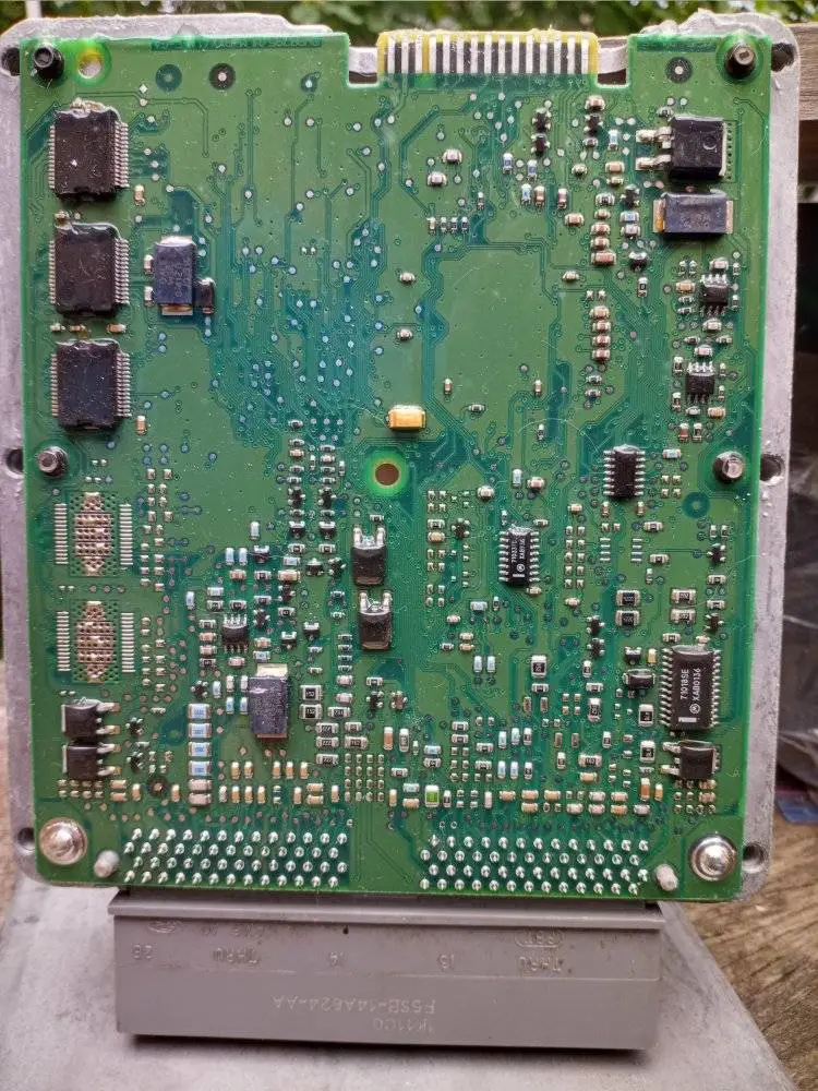

That was indeed the one I installed. I found it on car-part.com along with a pic of the donor car, so I knew it would be an actual MP3 ECU. (Some of the parts listed on that site with MP3 ECU part numbers may not actually be MP3 ECUs based on engine size or the Description provided by the seller.) I would have been equally happy with a flashed ECU, but got lucky and stumbled onto this one. It sounds like you put one of these in your car if I'm reading the above correctly? I'm not planning to do any supporting mods at this point, so I guess I'll just go on faith that the new ECU is helping at least a little based on what I've heard from you and others.

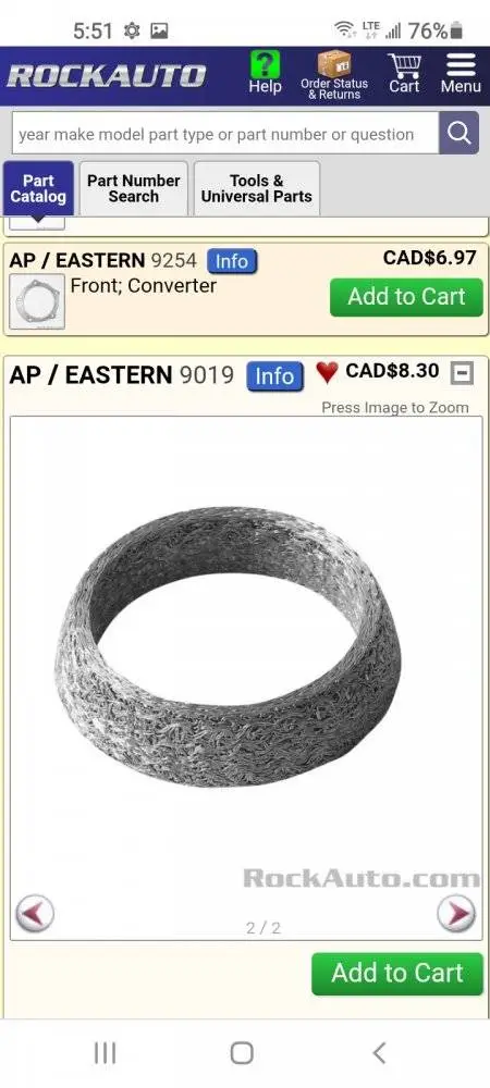

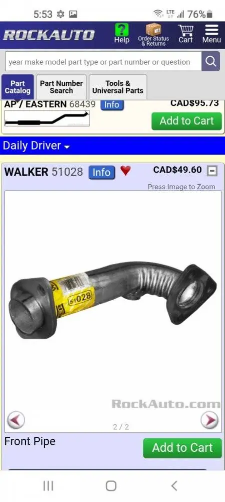

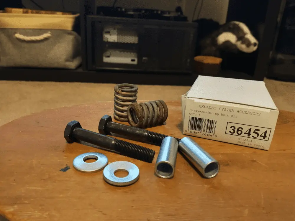

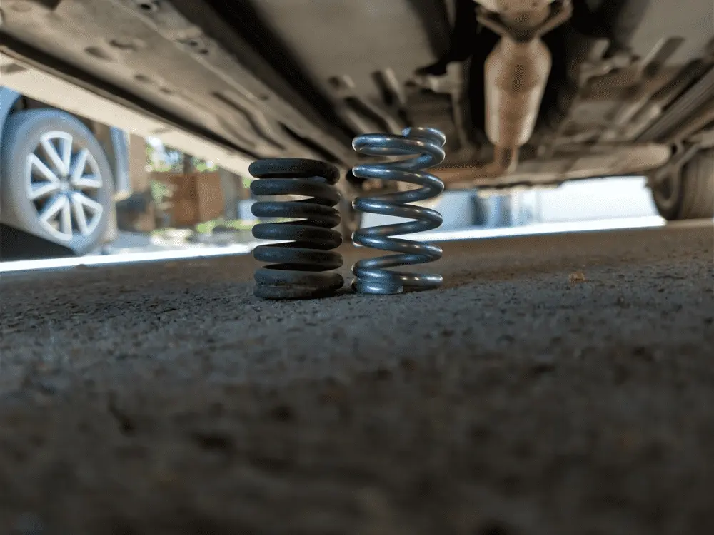

I was still getting a little bit of clunk from my exhaust pipe union, so I got the Walker kit shown below (available on Rock Auto and Amazon) and I've replaced just the springs so far. It still makes noise when I go down a ramp, so I will attempt to replace the bolts and collars next. Wait... Can I actually remove the bolts shown in the third pic below, or are they welded to the mid-pipe?
New parts along with old springs:
Can't really compare old spring length to new one since they're spec'd to work with different bolts, collars, etc., but here they are:
Original springs, bolts, nuts, etc.

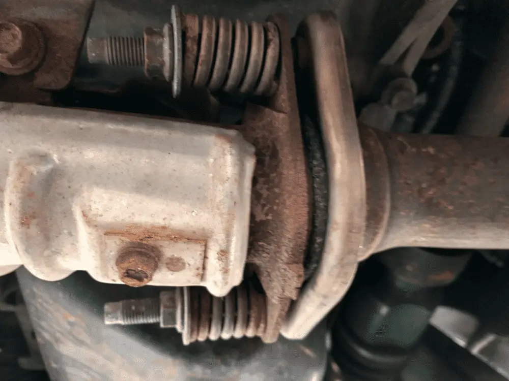

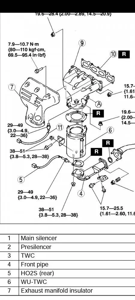

I'm pretty sure that they are bolts. (It's been a few years)
In my case, my bolt hole flanges rusted off the front pipe, so I couldn't attach the springs/bolts.
I could have just replaced the front pipe for $50 ...
But it wouldn't have ended there.
The front pipe attaches to the bottom of the pre-cat, and I would have had to cut the nuts/studs off to get it off.
So then I'd need a new pre-cat.

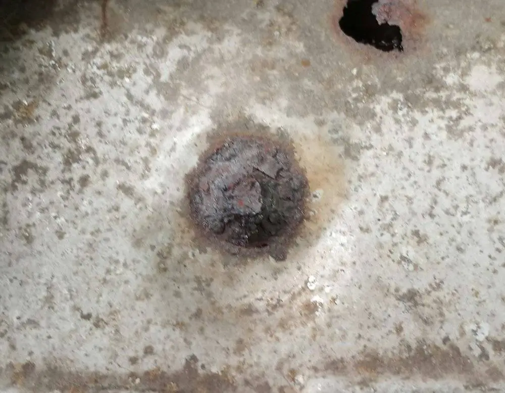

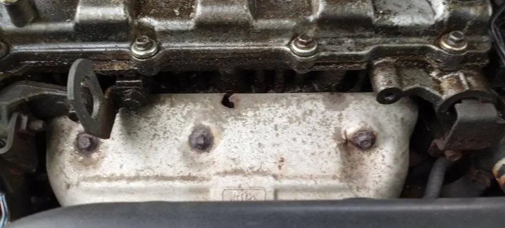

To remove the pre-cat, I'd have to remove most of the exhaust manifold, including the exhaust manifold insulator, and this is what I've got...
Does anyone know what size bolt this is ?? Lol
Every nut, bolt, flange, and connection is rotten and rusted.
I would have ended up have to replace the entire exhaust system and maybe the whole damn engine,... and the whole rest of the car. Lol

You might need a new one of these in that connection.
I coated mine with high heat copper RTV silicone to help seal it...

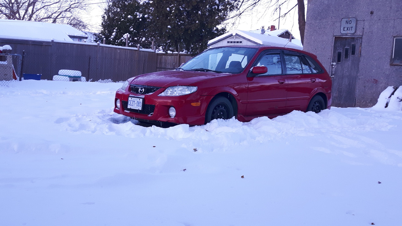

I still really like my car.
She still looks good under the right light.
(Just don't lift up her dress and look underneath... Eeewww. Lol)

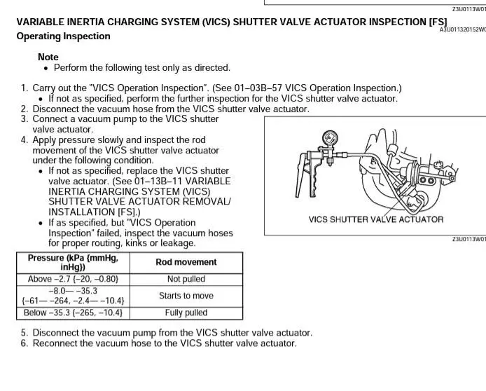

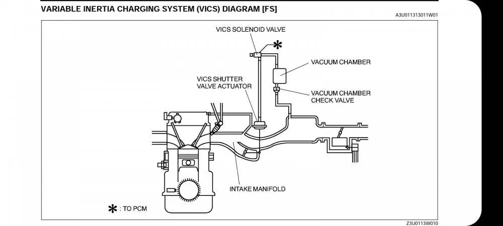

The ECU, kicks in some power at around 3200 RPM, then the VICS kicks in around 5000.
The Variable Inertia system opens (or closes ?) the butterfly valves to provide a straighter path for input air at high RPMs.
Some Honda Civic Fried Electrolytic Capacitor Images

There's too many parts soldered onto the circuit boards, as far as I'm concerned...
These boards are loaded with capacitors, resistors, diodes, and almost no solid state circuitry...
Our circuit board is almost completely solid state.
This is Mazdas version of resistors, transistors, triacs, and integrated circuits...
The Mazda boards look a lot more resistant to age/high humidity conditions and they're dipped in goo to make them acid/humidity/water proof.

She never gets hot enough here in the Great White North to pop her gage off 🙄
She's cold until spring unless I shovel her off...

Man I love that red. Still looks good no matter how much of a rust bucket you say your car is 😂
