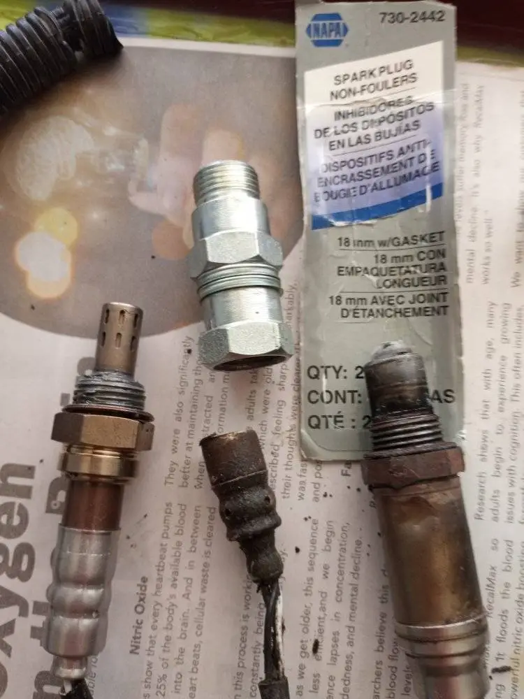

These are my 3 downstream O2 sensors...
The one in the middle is my original one from my DD.
They get REALLY seized and can be brutal to remove.
I stripped the hex with my open ended wrech, so I cut it with a grinder and cutoff wheel so that I could get a socket on it.
They have O2 sensor sockets, but I don't have one. They have a slot in them for the wires but the socket can open up and strip the hex too. (O2 sensors are nasty!)
You can install the new sensor with an open ended wrench, but put antiseize on the threads so it doesn't seize.
Regular grease can cook from the heat and glue it into the bung.
I think I'm just going to remove the resistor and capacitor from the wiring of the O2 sensor that was just on the car and reinstall it.
It's the easiest way to do it.
I can always rewire my new one if it doesn't work.
Or I could cut all the wires off of it and install it to plug the hole and put some tape over that damn CEL. It really is annoying. Lol
Another FYI,...
This is the Non-fouler that I made years ago.
I remember somebody made one and realized that his O2 sensor wouldn't fit into the Non-fouler because it was too big, so he had to buy a new one.
I think it was the DENSO that was too big ?
The one from my parts car is too big and won't fit, but the new one does.
I don't need the non-fouler, I was just curious at the time and made one.
They have new ones now that are already extended so you don't have to drill the one out and put two together.

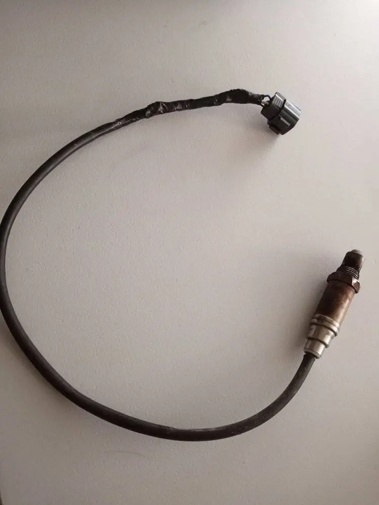

EDIT:
The refurbished O2 sensor is ready to be reinstalled.
I think it will work because it worked before.
I'm figuring that it was the circuit that caused my problem.
If not I'll rewire my new sensor, or cut the wire that illuminates my CEL. Lol
EDIT:
I installed my O2 sensor and went for a drive.
My CEL cleared itself and the light went off.
I didn't want to clear the code with my OBDII reader because I didn't want to have to go through all those drive cycles again.

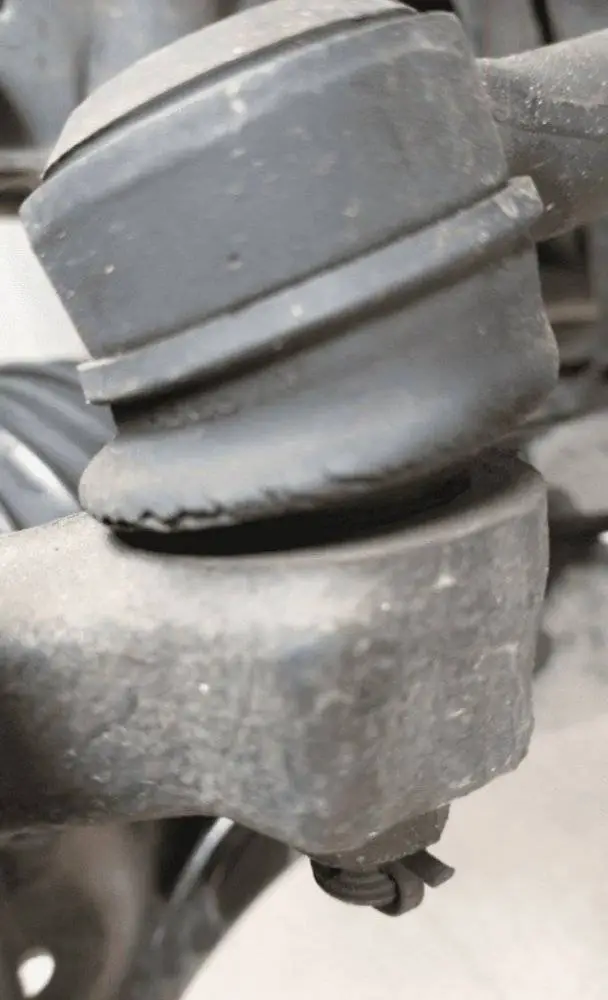

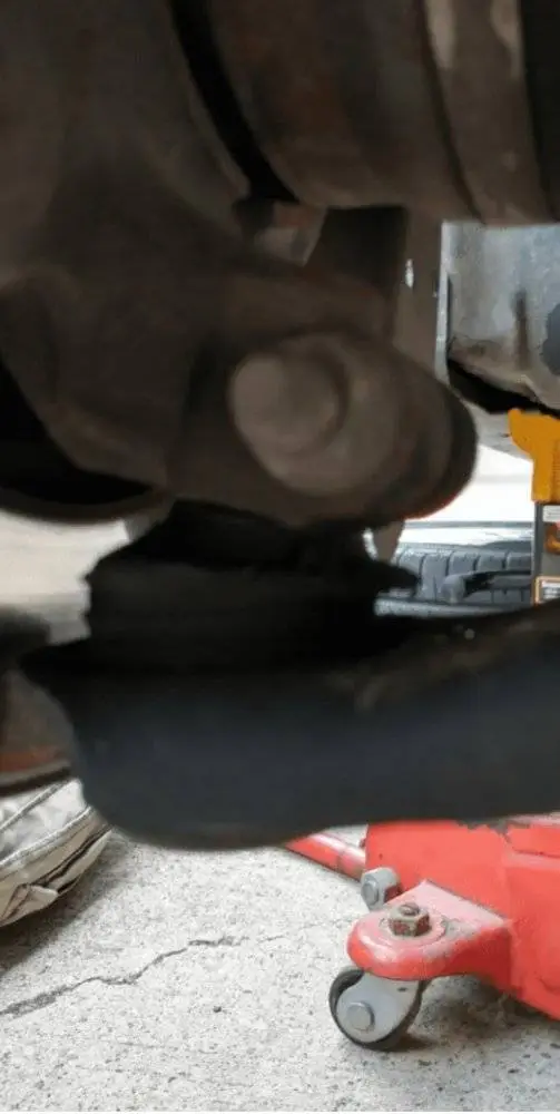

... I noticed that my LCA and outer tie rod ends had cracked bushings/boots. They weren't completely split like the boots on my end links, but they will get there soon. Honestly, if I've eliminated the clunking by replacing all my end links, I may not worry about them.
That looks broken to me.
That ball joint is really important.
They don't measure it by how much slop/movement is in the ball, they measure it by how much torque it takes to rotate the ball.
And it's standing with the pin up, so any water/dirt sits right on top of the ball and works it's way in. It doesn't drain out.

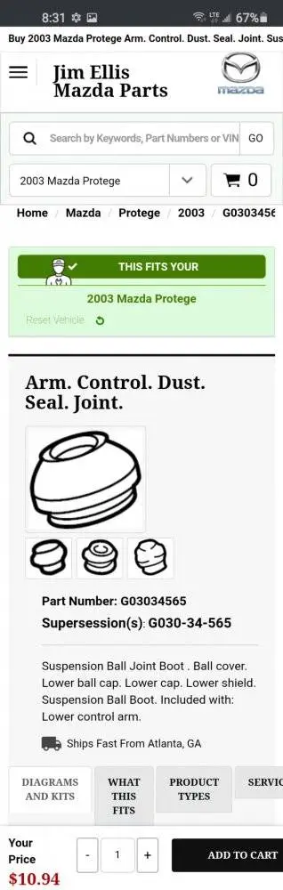

Replacing the LCA's is a PITA, but I found this...
(Nice drawings Eh? They look just like my boots.
I think Mazda gave a grade 2 class free pizza and crayons to make all their diagrams. Lol)

The bolt through the knuckle needs to be completely removed. There is a grove around the ball joint pin that the bolt goes through to prevent the pin from slipping out of the knuckle.
My pins were seized in the knuckle. I hammered a chisel into the gap in the knuckle. Its halfway between the bolt head and the nut.
That spread open the knuckle to allow the pin to come out.
This one isn't as critical and the pin is facing down, so water and crap should drain out.
Filling it with grease should be good enough, replacing them isn't too big of a job either, and they're relatively cheap.
The inner tie rod boots only move in and out and are much less inclined to break.
The outers bend, twist and pivot, and are more prone to breaking.

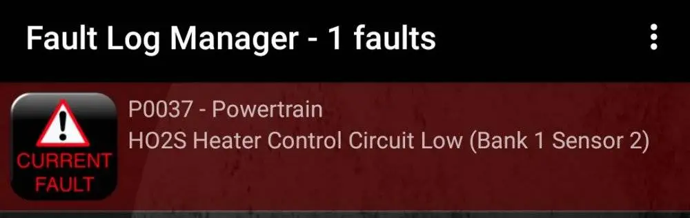

DANG IT! You guys jinxed me with your O2 sensor problems.
Saw the CEL this morning for P0037 and it hasn't come back since clearing it. I guess I'd better pay closer attention to the recent posts here if I'm going to need another O2 sensor.

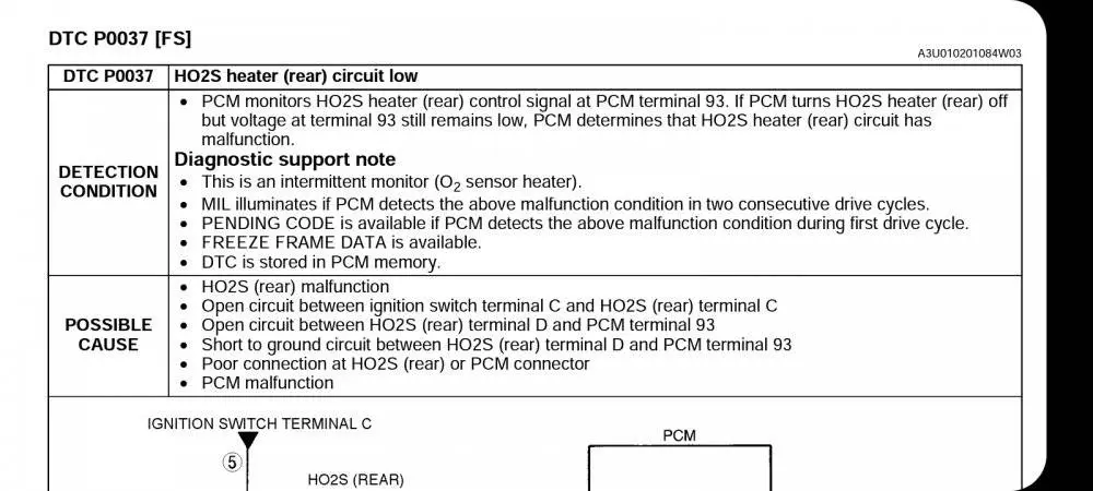

Here's some more info about it.
It needs two drive cycles to pop the code again, if your O2 heater is actually burned out, and it's an intermittent monitor, so it may take a while.
That code is WAY better to have than P0421.
That's the one that means your pre-cat is fried.

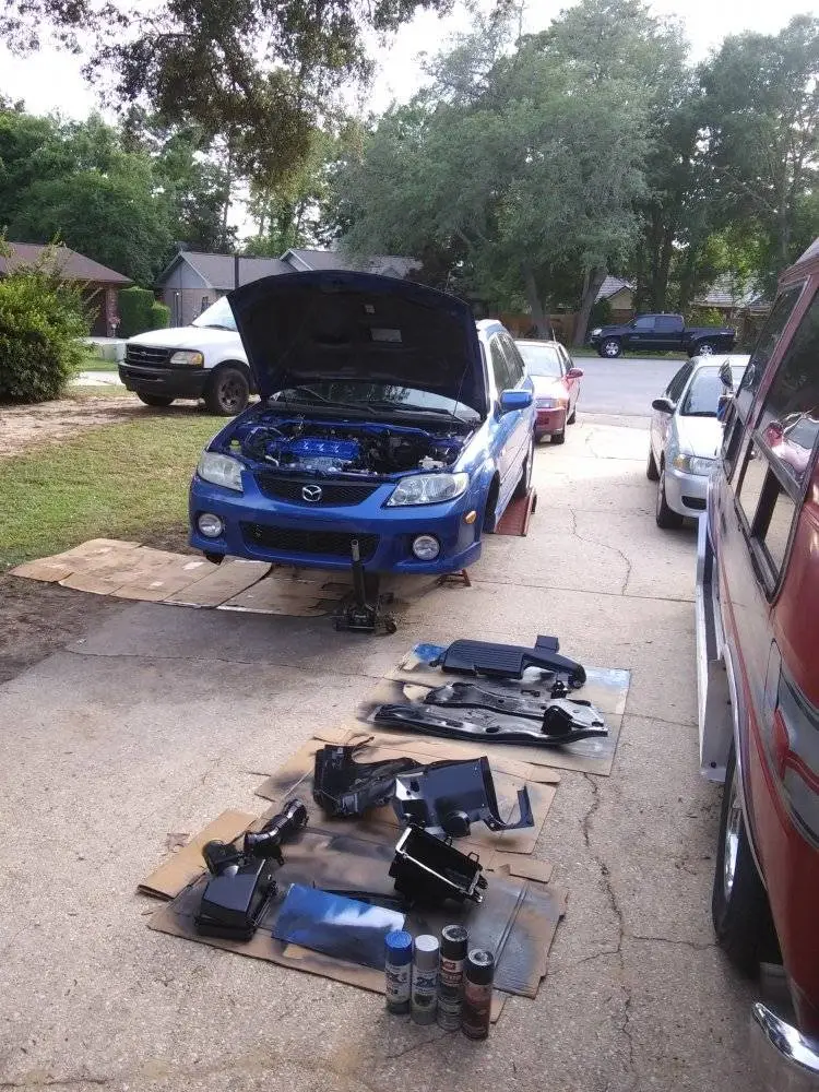

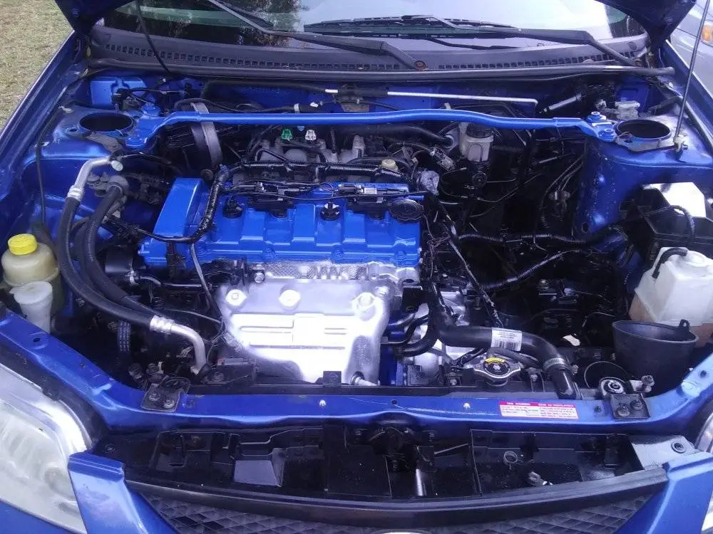

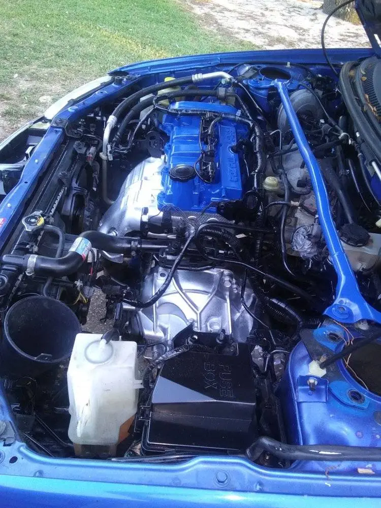

Speaking of sensors (and cats), I've been busy changing the clutch and doing some underbody and engine bay rattle-can painting this week/week-end.
So now most of the sensor connectors (and their connector wires) are black. :eek:
It looks like my son may have to learn some serious electrical system trouble-shooting when he gets his "$750-" car back. :devilish:
Attached are a few pictures - none of the cat (yet) but next time when she 'helps me out" sleeping under the car while I work.
Photos of some of the car work I did today and earlier this weekend.
-03 Mazda P5 Engine Bay Before
-Engine Bay Current with Transmission Re-Installed (so far)
-Some other parts getting painted while front suspension removed to get the transmission clutch parts changed.
-I'll try to show some transmission/clutch change-out photos later on with another post.

In a year from now, your son is gonna be taking that thing to car shows and entering in contests with it, mark my words! :LOL:
All jokes aside, wow. It came out amazing! A little TLC goes a long way!
Thanks RPRP5. :)
I just hope it gets him back and forth to work (and home once-in-a-while).

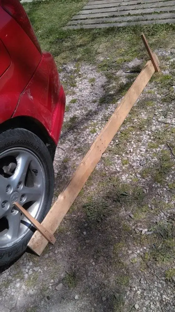

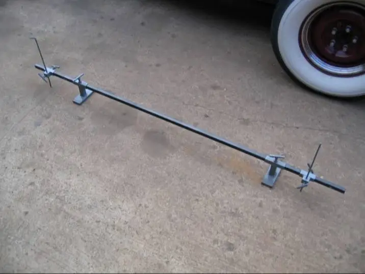

I tried that method for the outer tie rod ends on my car.
I loosened the lock nut and left it in position then installed my new tie rod end.
It didn't work.
My new tie rod end had a slightly different thread count and distance to the center of the ball.
But I made my own alignment tool, so I could set my alignment myself.
It works good enough for me.
It saved me $100. Lol

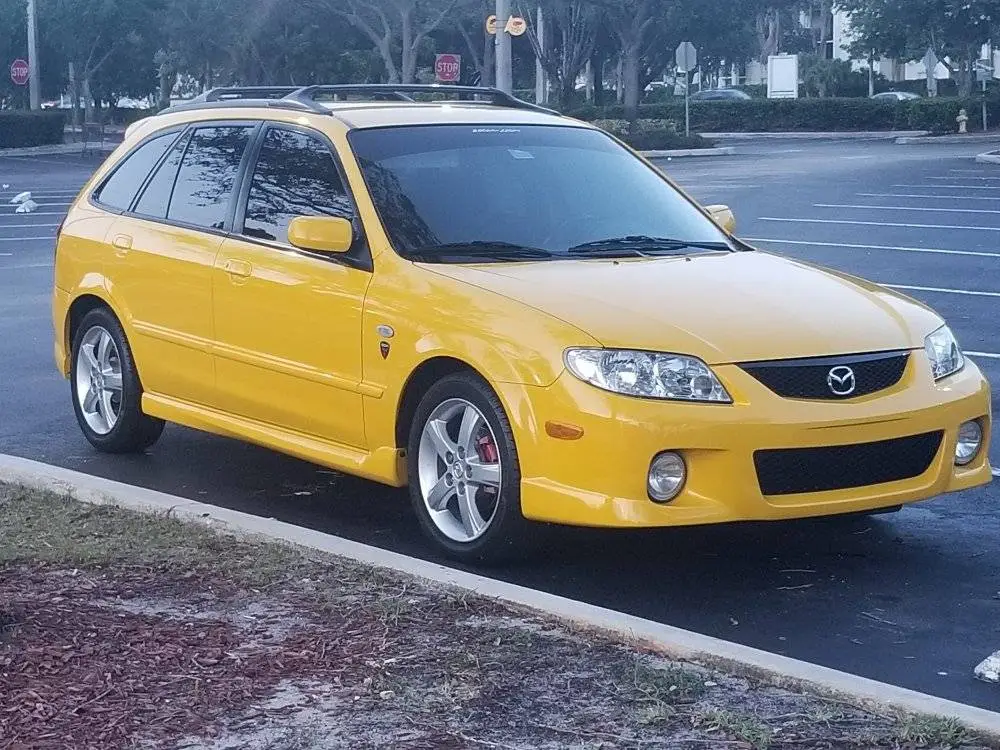

Hello, been lurking here a while, living in South FL means no road salts but u have to garage or get a good cover, ordered this 03 new with tiptronic & no sunroof , it just turned 51k miles, only drive it once in a while to keep everything lubed great cars!
Welcome - Appears to be a rarely used and un-abused BEAUTY!!:love:
Probably still has that new car smell. ;)
