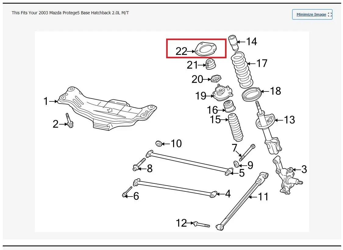

-The old struts had a super thin transparency paper plastic "strut mount gasket" installed on the top of the strut and between the wheel-well body to act as some kind of cheap (my guess) vibration isolation damper.
-I used that clear plastic gasket to make my own gasket using foil-backed rubberized "peel-and-stick" waterproofing membrane material, (stuff normally used on roof valleys and edges, and when installing exterior doors and windows) - at least twice the thickness of that plastic gasket) and installed it (stuck) it on the top of the new strut as a vibration (noise) damper.
-Why - Because I had a 2000 Maxima that had no strut mount gaskets at all and it was noisy as hell until I pre-fabricated and installed some improvised gaskets (back then used regular general purpose gasket material and they worked well).
--FYI - Mazda dealerships sell strut mount gaskets for a few other Mazda models including the P5 for about $2.50 plus shipping. Below is a link to a Mazda dealership where you can find them and other parts.
2003 Mazda P5 Strut Mount Gaskets

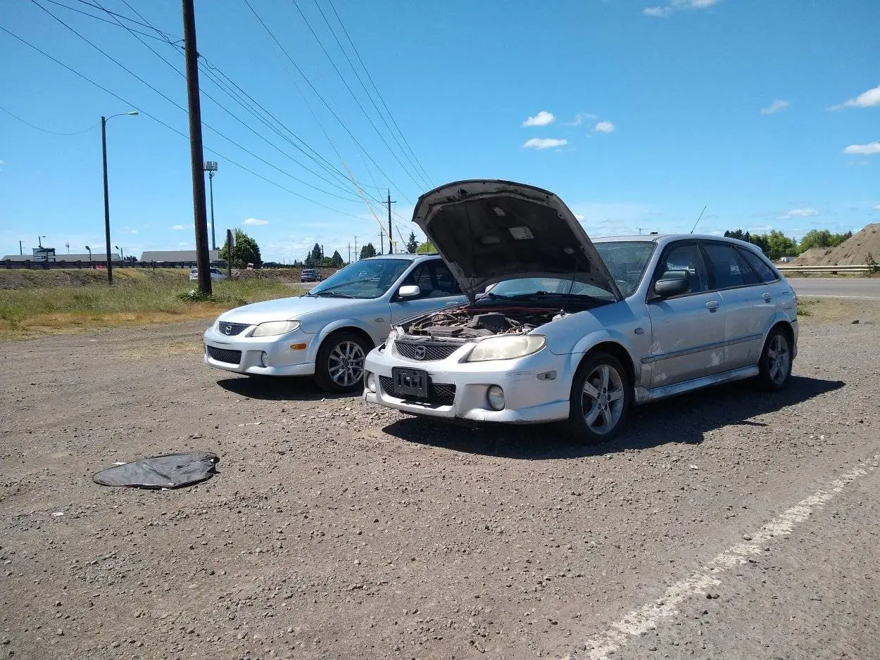

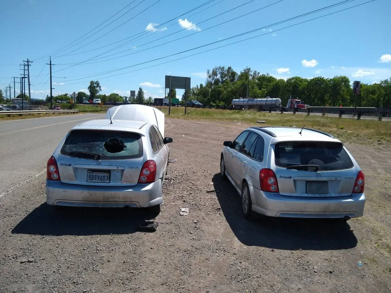

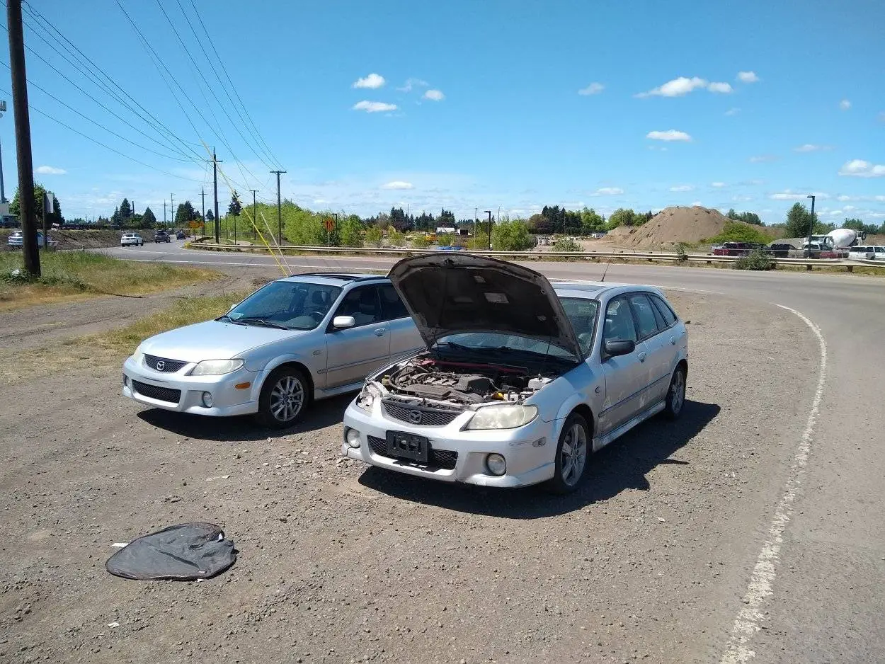

Was driving on the highway today and saw an abandoned silver Protege5, identical to mine. Had to stop and take photos. Bit sad to see another one go, especially this way.
Thing is cosmetically and probably mechanically totaled, and it's been partially stripped. Owner definitely didn't take care of it at all. 5spd with leather and a sunroof too. The temptation to take parts off it is high, but I don't want to be that guy.
View attachment 298199View attachment 298200
So sad to see one abandoned...They're awesome cars and they don't deserve that fate.

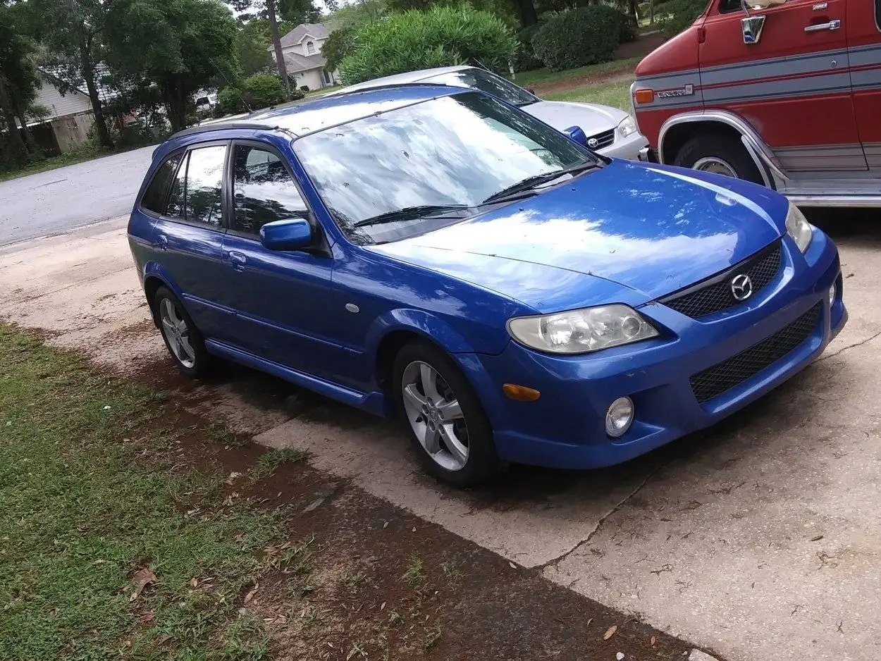

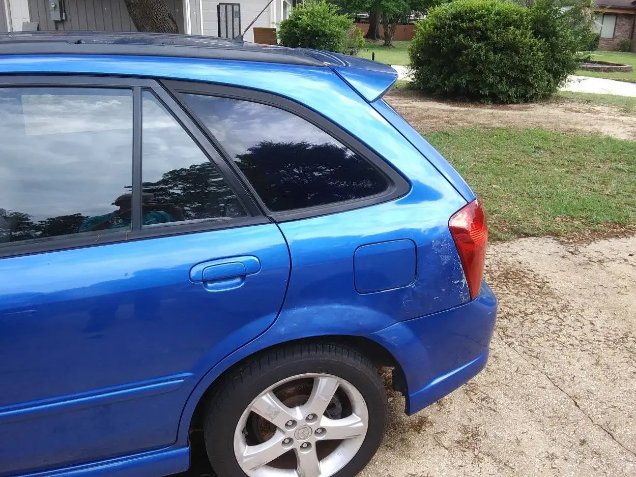

Here are a couple of pictures of my son's $750- P5 that I'm working on.
-It had been previously hit from behind in the left rear quarter taking out the tail-light, pushing metal forward and in to include the fender well lip where so far I took a coupe of sized baseball bats (NASCAR style) along with some hammering to get the dents bumped out for now.
-I do has some surface rust on drive/suspension components where I'll be replacing a lot of parts and will use a wire brush and some Ospho to neutralize the rust and paint on what I don't replace.
-Lots of new replacement parts coming in this week that I will be replacing since I'll be dropping the transmission to replace ALL the clutch components beyond standard parts just short of racing grade components along with replacing the engine rear main seal while I'm in there.
--Other parts -both front CV axles, front struts, 12 piece front suspension kit (have already installed new radiator and one new fan. Have also replaced rear struts and front and rear brakes pads along with installed new Megan short throw shifter and Exile shift linkage bushings that work great!!)
-The way I figure is the parts aren't all that expensive compared to my not -so-pain-"free" labor :confused:.
In other news, Fox Business today said used car and truck prices are skyrocketing. Highest increase since they've been keeping records since 1953. Prices rising due to stimulus checks spending and a 36% decline in dealerships new car inventory levels....
This means YOUR cars are worth more right now and replacing parts on my son's car I rationalize is an "investment". :)

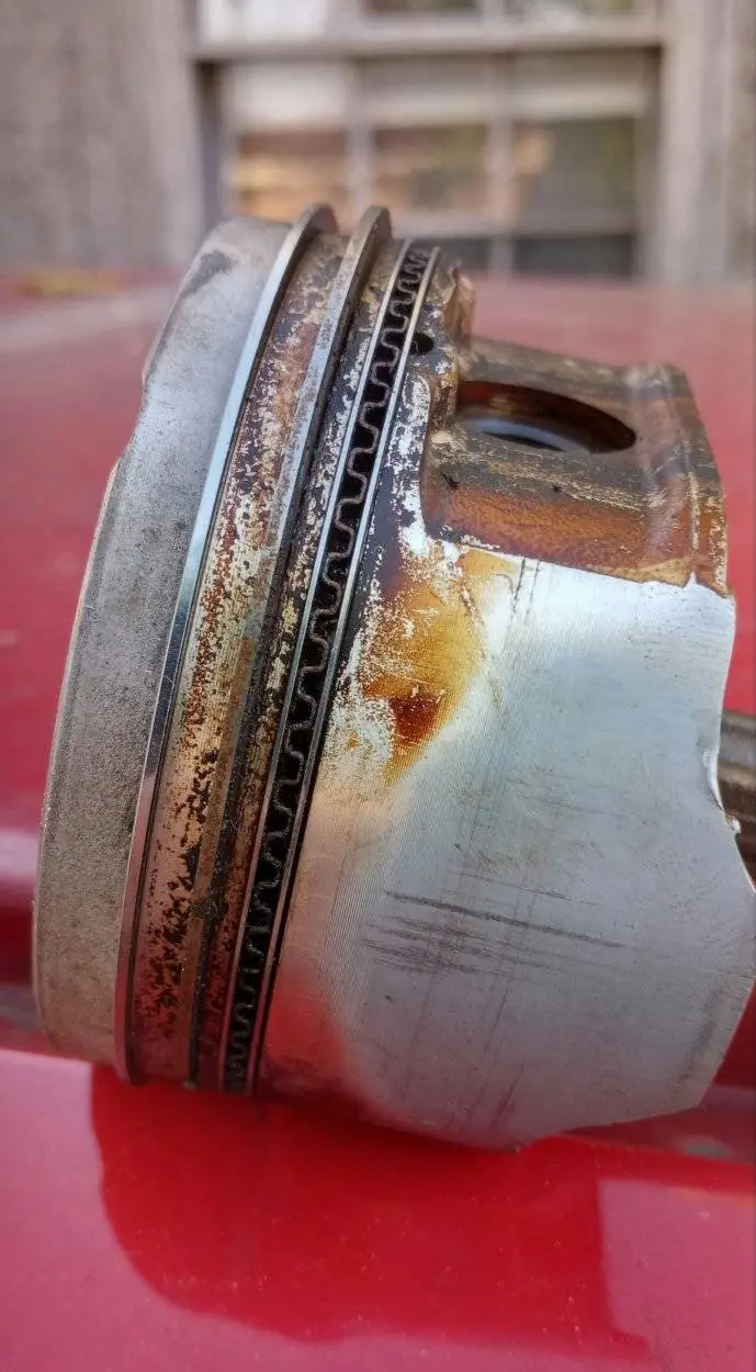

I don't know how many miles (if any?) that you've put on the car, but our cars LOVE to burn oil, mainly due to lack of oil changes.
Our FS engine has a poor design with it's oil rings on the pistons.
They have very little spring tension and let oil into the combustion chambers and gas into the oil.
I would suggest an "engine flush" to help wash away any carbon buildup.
I use seafoam and have used it for the entire time I've had my car (over 10 years) and I don't burn a drop of oil.
This is a picture of a piston from my parts car that was burning oil like a MOFO.
Some guys fog out their entire neighborhood when they start their cars.
A link to the guy that discovered the problem.
Thread ''02 Protege5 burning oil, white smoke on startup/post downhill acceleration' https://www.mazdas247.com/forum/ind...startup-post-downhill-acceleration.123864613/
Check the links and the post by gozz that discovered the problem...
You want to keep the oil drain holes clear before they completely plug up.
