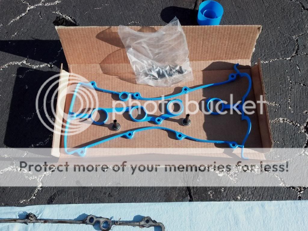

What should have taken about 30 minutes, ended up taking an hour and a half. Either this was the factory gasket, or whoever changed it last used WAY too much sealant. I spent a good hour cleaning up the head and cover with a razor blade and brake cleaner. And, as promised, some pictures:

Pretty. Hooray for no sealant needed!!!!!

Where's the blue gasket come from? Mines black and I got it from OMP. Just wondering :)

The gasket is from Autozone. I asked for sealant, but the guy said the rubber Felpro gaskets don't need it... even on the timing belt side.
^ I used the same gasket. It heats up and expands. After driving it a while, it will begin seeping out between your head and Valve cover. I changed mine in 30mins and haven't had a problem since
