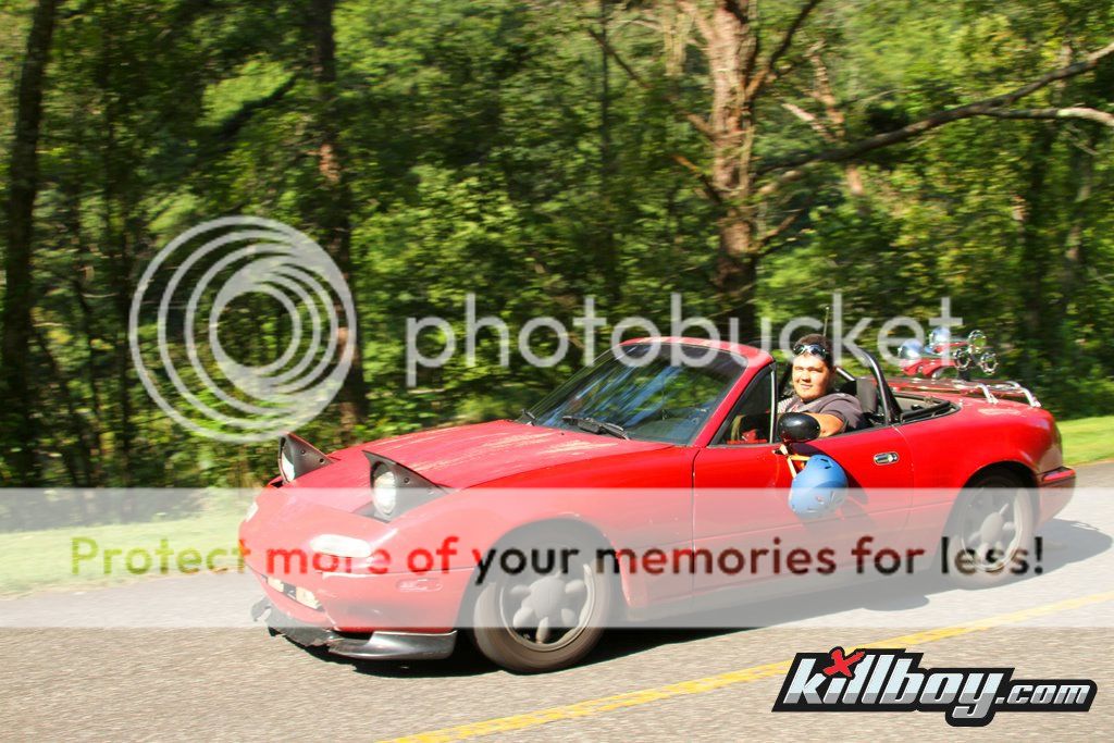

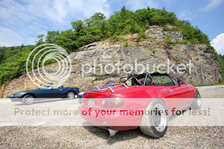

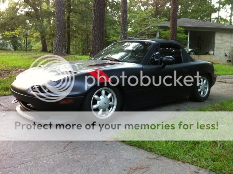

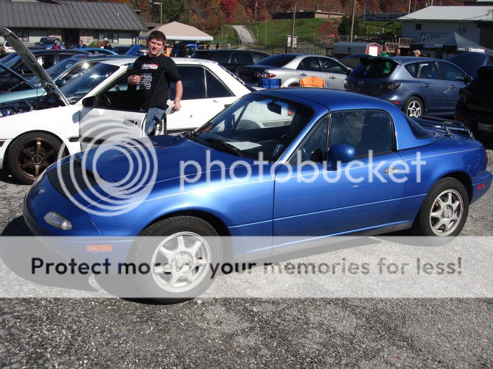

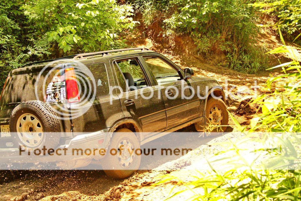

Not much, have picked up around 10 Miatas since I left, a few CRV's, a BMW, and a Speed Protege, 2 P5's, and picking up another Speed this week and another P5 at the beginning of January...As for Phen's, I needed a couple parts off of it and got to go up and meet Evan (LewisProtege) and Ivan (fishdontbounce) for a nice little 3AM breakfast at the truck stop...

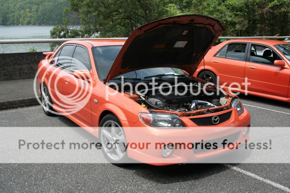

He traded BThai a spicy MSP for his Silver P5. He just bought Phen's to part out.
Yep, bought StdnDrvr, formerly known as Topher's IIRC Spicy down in Columbus, GA and fixed/cleaned it (<------IT MAJORLY NEEDED THE CLEAN PART), and ended up trading it for BThai's Protege5, was exactly what I was looking for to get back with the Protege's...

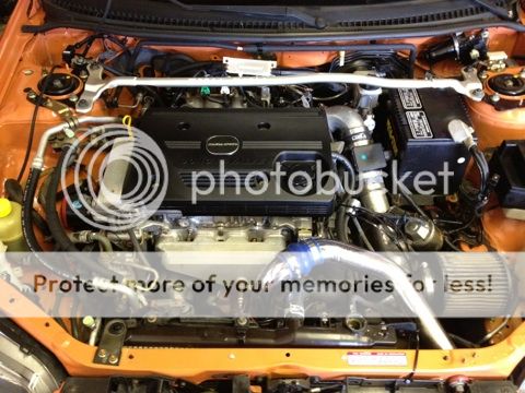

Also, finally got around to getting some work done...
  • Took off the coilovers and swapped in a set of Tokico Illuminas and Tein S-Techs
  • Corksport Exhaust
  • Rear Wiler Delete
  • Speed3 Seats
  • JDM Armrest
  • 03.5 Floormats
  • MSP Doorsills
  • MSP Engine Cover
  • HKS Intake
  • Dave B's

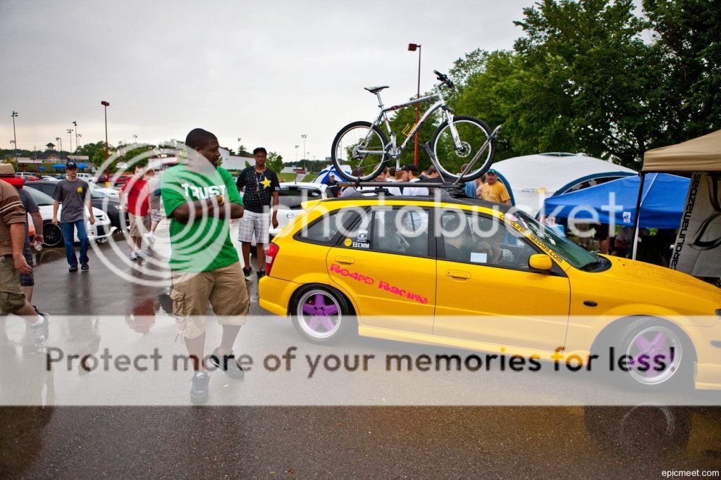

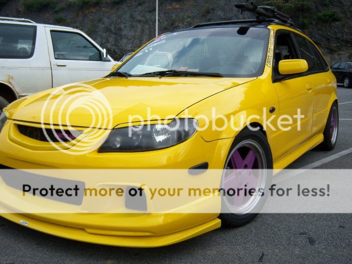

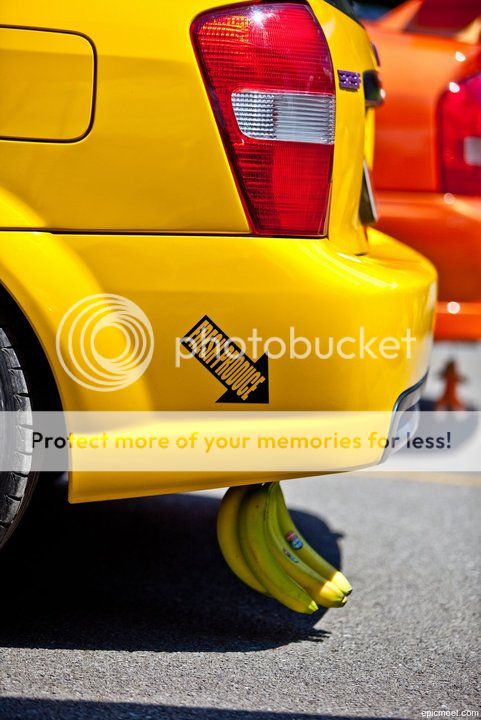

New P5 is coming along nicely...lol...and for those that never saw the old P5, here are a few pics in its glory...
