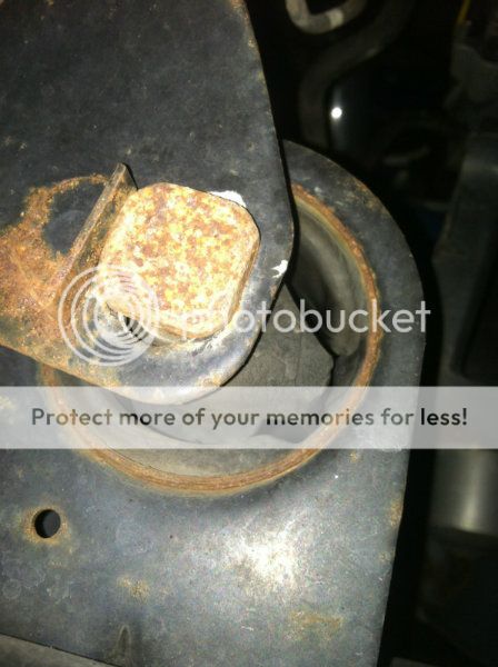

I tried to change a foglight bulb but the nut holding the assembly on was stubborn and I was lazy. Instead, I stumbled upon my front motor mount:
is this bad? once again, bear in mind, this is my first car, I know nothing, yada yada

^Yep, it needs to be replaced.
anyone have a ballpark idea as to how much it will cost to have a shop change the front motor mount?

If you have a socket set with either a 14mm or 17mm you can change it yourself in about 15mins. Seriously, it's that easy. You can use your scissor jack to gently raise the motor just a pinch while to take some weight off the front of the motor. Then unbolt the 2 17mm (I think, or 14mm) bolts under the motor mount and the 17mm bolt that goes through the mount itself. Remove old, torn mount and replace with the new one. Tighten everything up, remove scissor jack and reward yourself with ice cream or beer for a job well done.
Or expect to pay about $70 for a mechanic to do it for you. I'm sure there are some cats in MA that would help you or do it for you.
id try and do it yourself if you can. But im not sure how much a shop would charge...
Thank ya thank ya thank ya, doesn't sound too bad. I found the duralast mount for $113. Is that high?

Reinstalled the fog light housing and got everything working. I'm picking up the mount tonight, and I have a buddy that used to work with me that said he'll help me out with it on Monday or Tuesday
