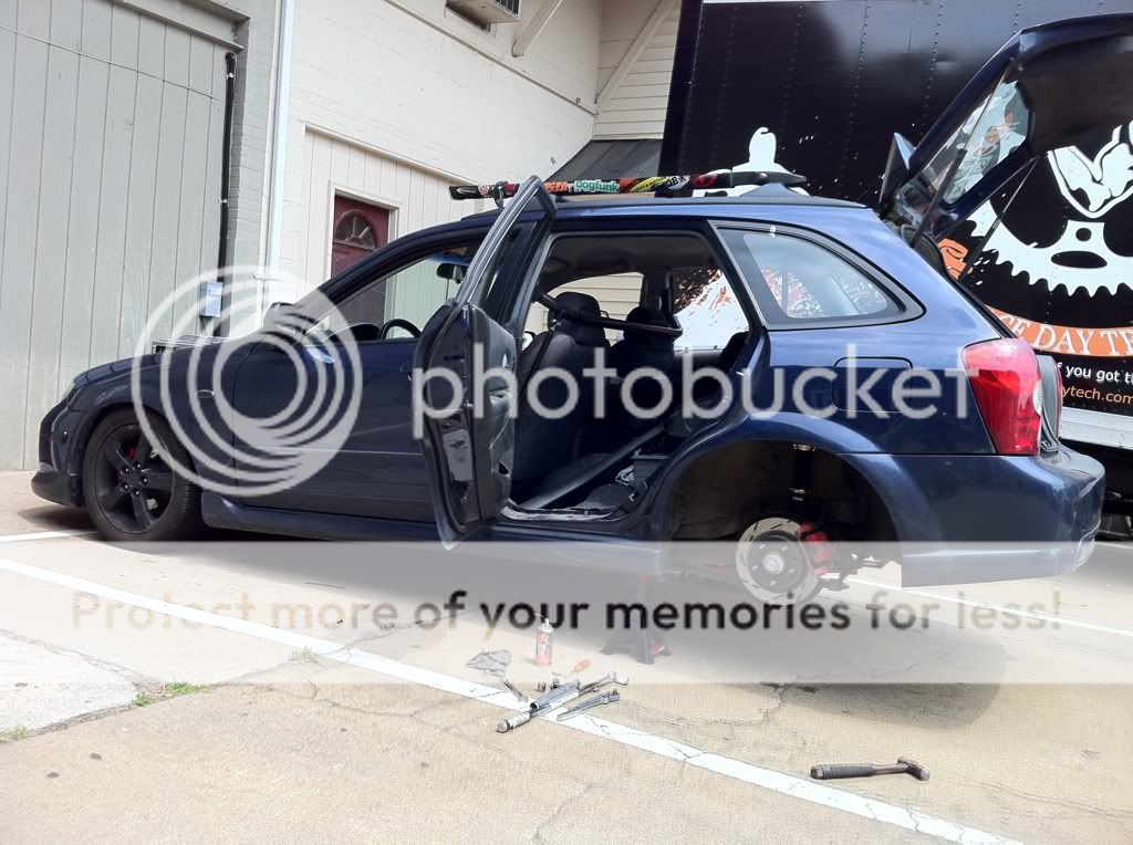

And while I was under the car I saw this...
attachment.php
attachment.php
thats either an axle seal or the rear main seal is leaking. Axle seal is cheap and relatively easy to replace (depending on how much the rust hinders you) so i would start there first and clean the area off then recheck it
Thanks and will replace the axle seal first and go from there. Meant to grab the manual from the garage before I left work but forgot. Oh well, I'll have to peruse it tonight.
