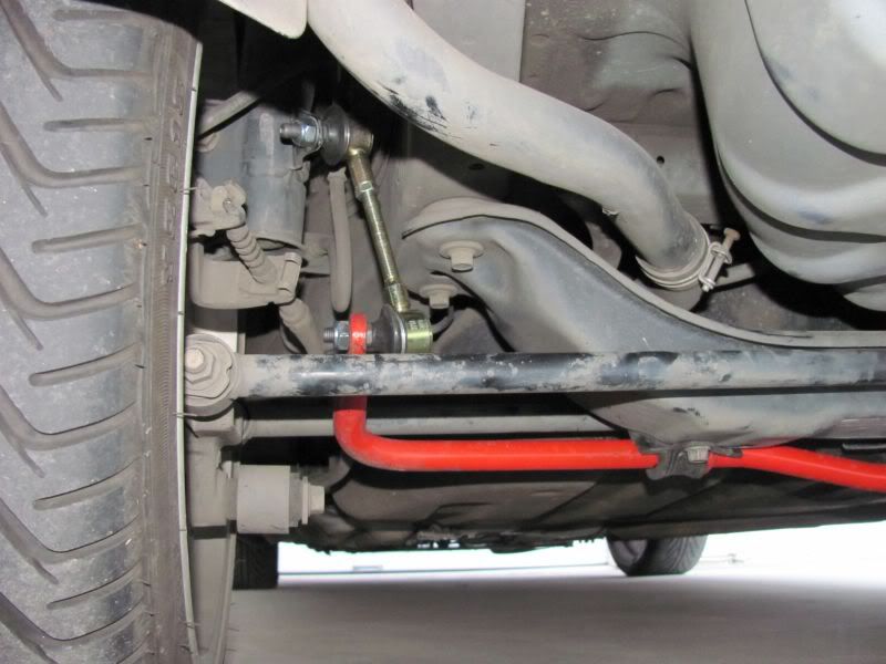

ok peeps, I installed a 21mm AutoExe Rear Sway bar about 5 weeks ago, and for the past 4, I have had a clunk :(
So this is what I have done
Wheel Alignment
Replaced endlinks with 20mm shorter ones then factory
tightened all hangers/bushes/rubbers
reseated both rear springs
added washers to top struts
removed everything out of rear of car
And I still clunk :mad:
So in saying that, friend of mine has suggested flipping the bottom endlink so its on the out facing inwards, but will I still get a clunk? (he thinks that the endlink is hitting up against the lateral link)
Here is what it looks now:
Cheers
Marc
check the lateral link, and see if its hitting
if its not hitting then its just the endlink
i had an AWR 21.5mm sway on my car for like 7 months, i tried everything to get it to stop clunking, new endlinks, new bushings, grease the bushings
i ended up selling it and putting the stock back on, fixed the clunk lol
So how much longer then stock? i think the best thing to do is remove and put the stock one back in and buy another endlink kit :o
