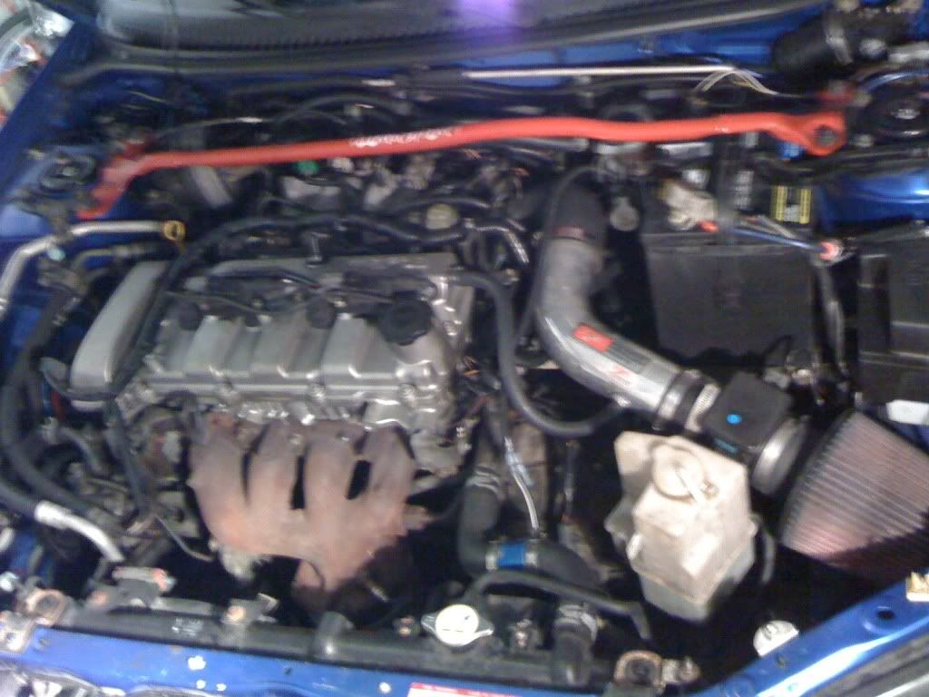

went home sick, but, couldn't let the car sit there in it's sad state....
So, wheels are back on, MSP lip is back on, mazda6 wiper on, DaveBs on, Tribute stalk on
ALSO, pulled the center console to find out what happened with the shifter. It was turned around
While the car was up and they disconnected the shifter linkage, the shifter itself managed to get rotated, so, removed bottom bolt and flipped it around and she's good as new.
Also reconnected the gauges, the dindo didn't wire the grounds back up
SO, reattached the ground and got oil temp and coolant temp gauges to work. Now, i'm not sure what's wrong with the oil pressure.
It had been pinging out to max PSI random, so, i am thinking i got either the gauge going bad, or, i need to reiwre without using wire nuts. lol
