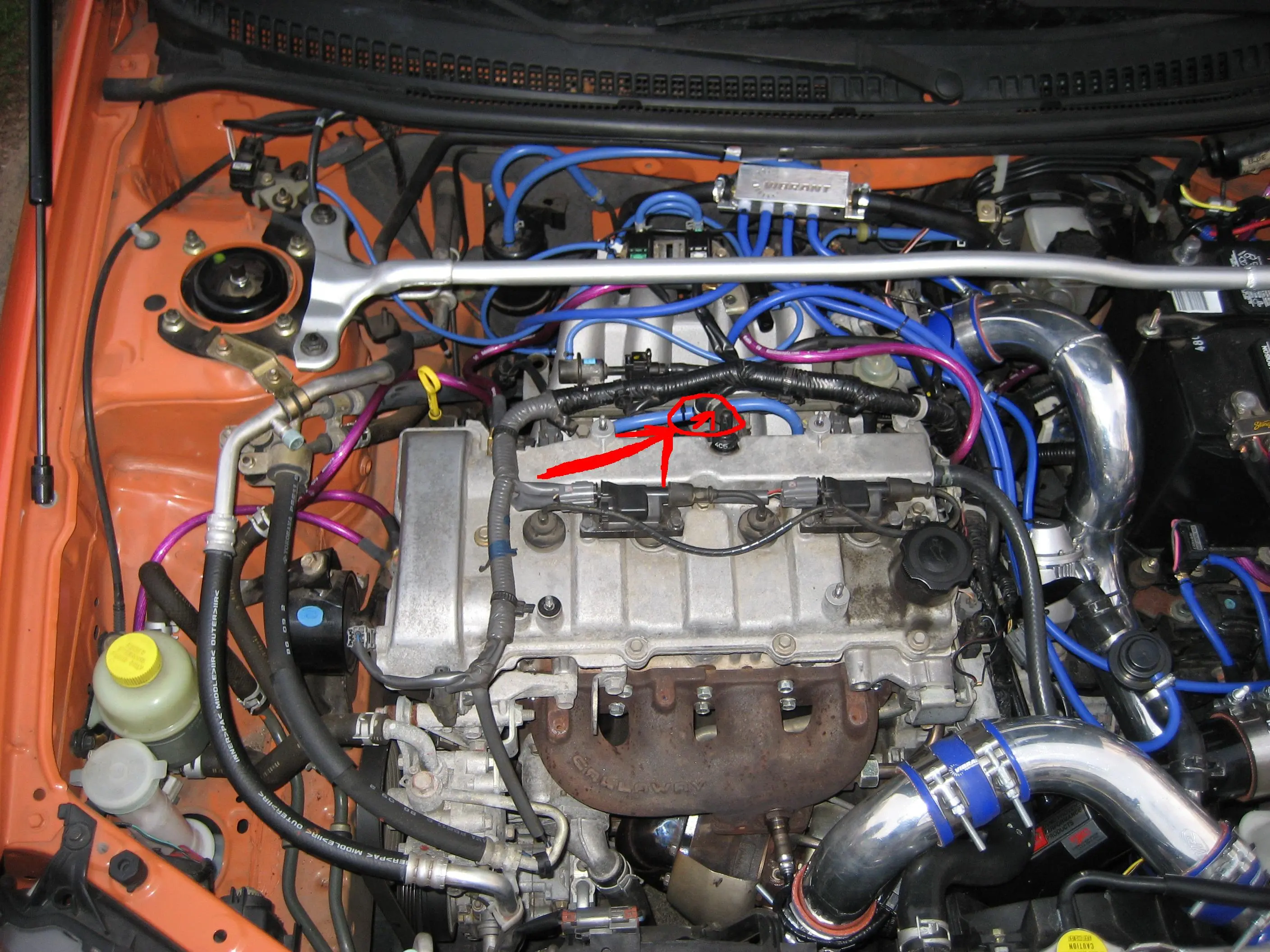

Speedadiction the only problem I see is that you put it in through the pcv vacuum lines. Those vacuum ports only feed cylinders 2 and 3, 1 and 4 got nothing. There is a vacuum port on the top of the intake mani that is right after the tb and it will get into the plenums.
The idea of seafoam is to remove the carbon and any other desposits in your engine. Did it in my rx7 not too long ago, I think my neighbors hate me.

ya a sea foam bottle was only like $5-$6, and it is around the size of....I don't know like a gatorade bottle kinda, so maybe 16-18oz? didn't really read it too much except for the instructions, it's just 1/3 in the fuel, 1/3 in the crank, and 1/3 in the pvc/intake hoses (I just connected a larger vac hose to the angle connector that would usually connect to the PVC and just sucked it from a cup with the sea foam poured in there.. just make sure you suck it up slowly and the person behind the wheel really keeps it reved while your doing it, the person I had didn't realize it would die so quickly and it died, took a few cranks to get it going again, but after that, it was all good.
Edit: and shadow, really, I thought that going through those pvc lines ensured that I got them all, that's what I read on a couple of the other thread.. people that used the BB line said they didn't get all the cylinders.. here is where i connected it, right after PVC part in the pic
