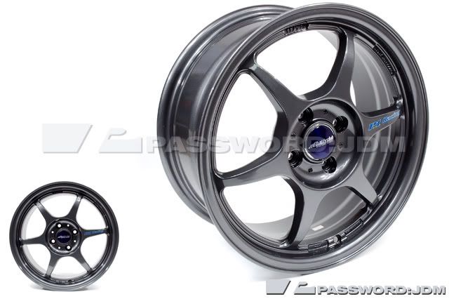

Alright, I didn't murder it out. I went with the gut and decided on gunmetallic.
Should be on the car by the end of the week.
