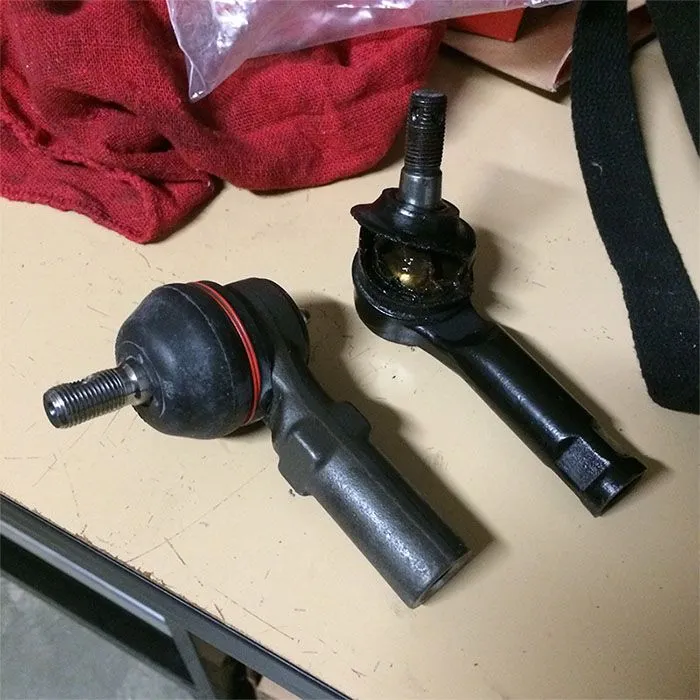

replaced passenger outer tie rod with a deeza
attachment.php
I just thought it was funny we told him to do the exact same thing. Experience counts for something, I guess!
Sure does haha. when you've owned as many proteges/p5s/msps as me (and you i think), or worked on even more you tend to get the little secrets haha
