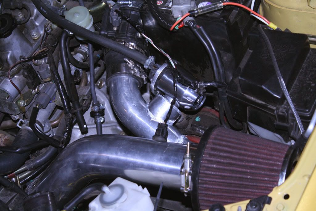

not much, personally I liked it on the hot side just because it is not tucked down in the bottom somewhere on my fmic pipe routing on the cold side, and I would rather have it further away from the MAF to reduce any turbulence when the bov goes off, just easier IMO and I didn't want to worry about how close the bov was to the MAF, and I personally thought it looked cleaner on my setup
I agree with all this. Mine's on the cold side because its easier.
its kind of an ordeal to take the valve apart without pulling the section of coldpipe its on. if i get motivated though ill get in there and take the insert out, and take a video.
my valve is tucked between the battery and the fuse box. a perfect little pocket for it.
what's the difference with the valve anyways? what's it keep it from doing, or allow it to do, mine has a slight flutter in low boost but once it hits 4+psi then it's great, just curious, might try playing with my valve it it's worth the time
flutter is the valve not opening fast enough at low or no boost to relieve back pressure. it has nothing to do with the insert. i just drilled couple small holes between the chambers and it blows off real fast now. side effect is without an adjustment screw, it opens at the slightest foot movment. if your cruising in second and your running in vac, if any pressure builds up on the turbo side it will blow the valve and sound all weezy. been meanign to drill/tap and adjustment screw in the back, which would basicly make my v2 into a v1 ha.
the insert serves no purpose other than the sound. removing it doesnt have any effect on the sealing of the valve, even though it may look like it presses against the rubber piston seal. its a metal cored shim thats coated in rubber. no worries.
ah, ok, then I will just keep it the way it is, it works great, and I usually don't go real low boost to make it flutter anyways, if I boost it is usually past the flutter point haha
I'm thinking I may just keep my dual setup since I have it working with a relocated MAF. I don't want the damn turkey, and I'm not too crazy about drilling holes in my new V3 valve. I already scratched the cover and I'm pretty pissed about it lol. Maybe I will paint the cover black for a 2 tone look.
doesn't need to be "in boost" to flutter. sitting at 0 on the boost gauge it is moving enough air to pop the valve, and leave a noticable flutter. hell, as low as 10 hg you can still get it.
read all over the places that these valves suck for many turbo 4 bangers and somone at the evo forums suggested this. i double checked with a user here who has done the mod and is also turkey less, and not running dual valve.
the only downside i guess is that my valve is now a perm fixture to my car and fmic setup. pretty sure i ****** the stock one pulling it all out many times to do repairs anyway.
