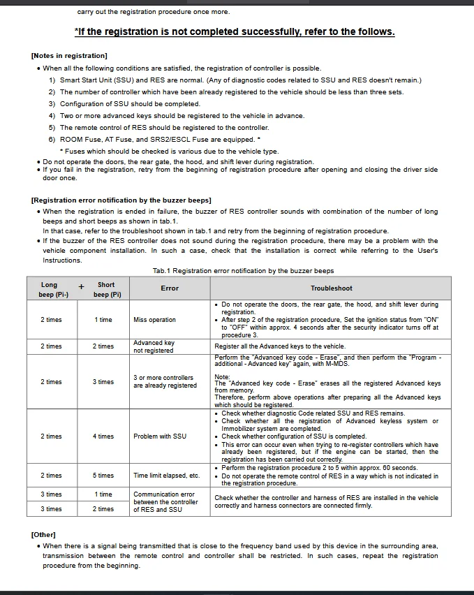

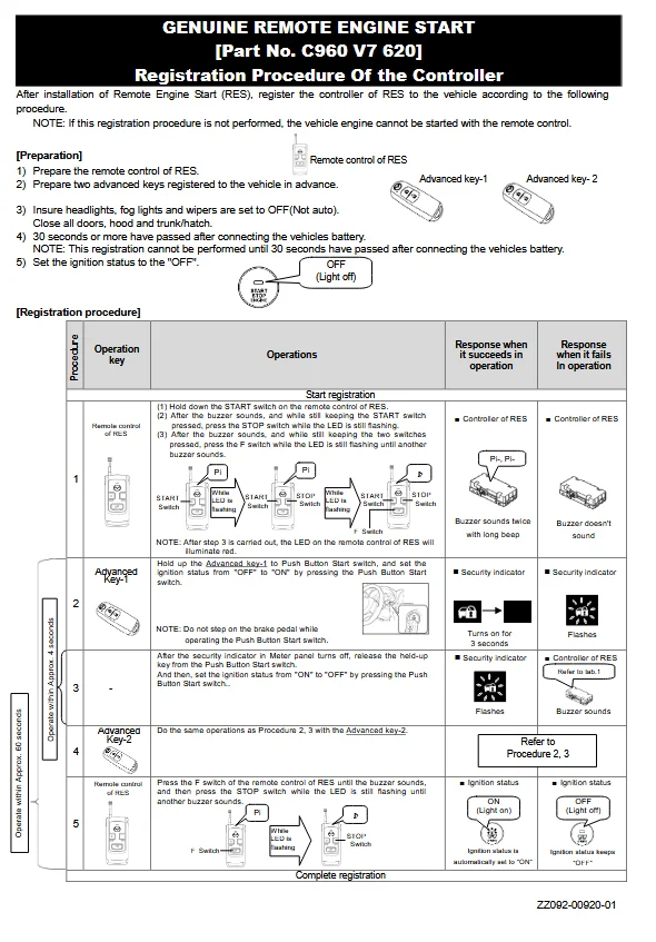

I have run through the registration procedure as described here:
Registration Procedure Of the Controller
Upon the final step, I am given three long and four short beeps from the C960 module. The vehicle attempts to start (cluster lights up) but then the message above is displayed.
