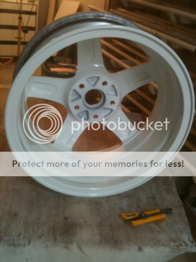

inside of wheel painted white. you dont really see it that much after installed so i just finished it with a few good coats of paint and didnt worry about fixing any chew marks from the weights ect.
how you see the inside of the wheel now.

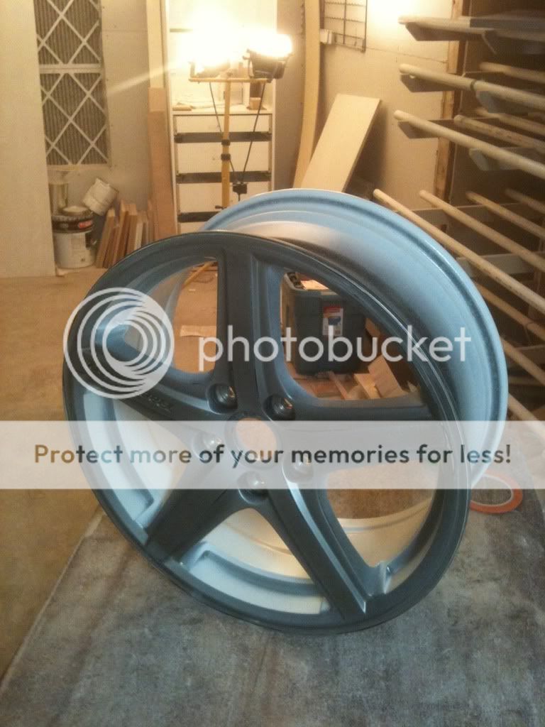

taped that all off and started working than the face.

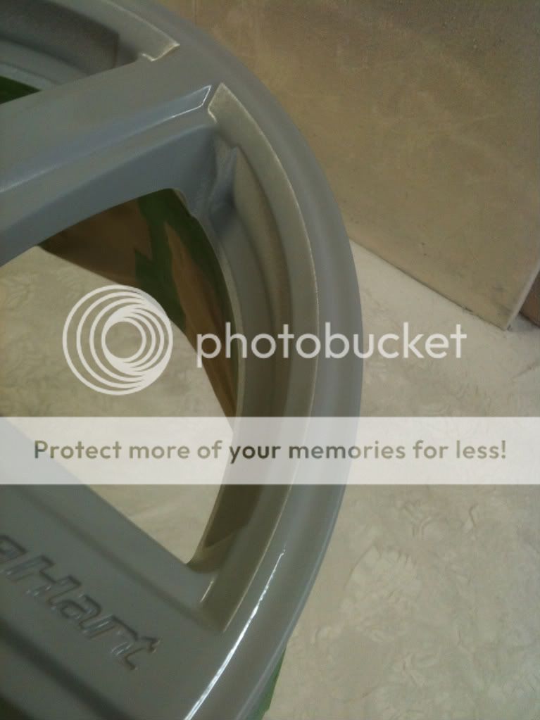

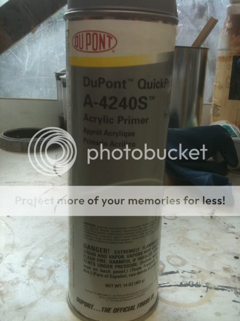

Filler primer over the repaired rash to even it out. worked quite well i must say.

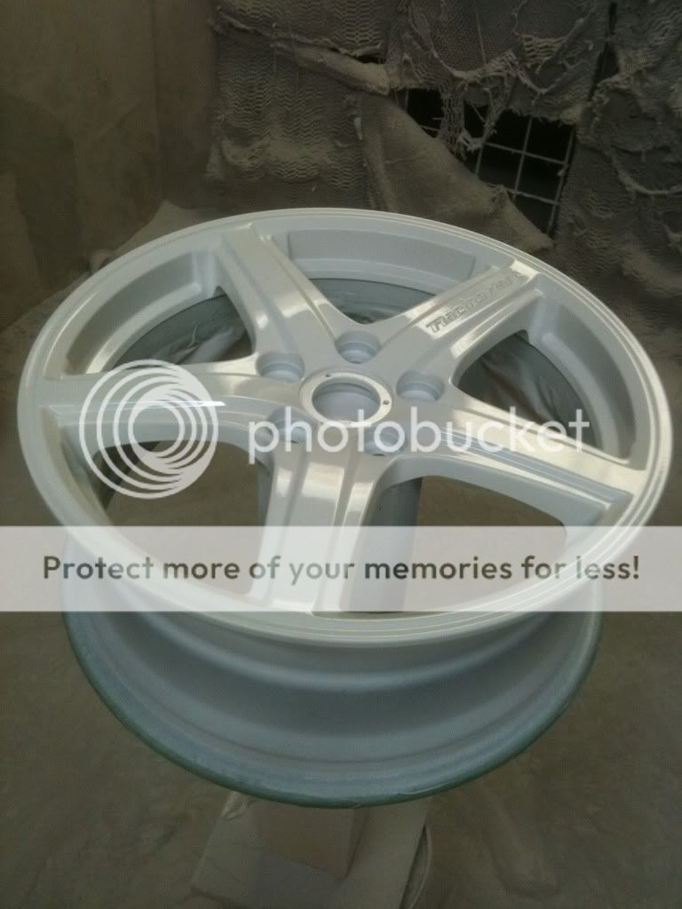

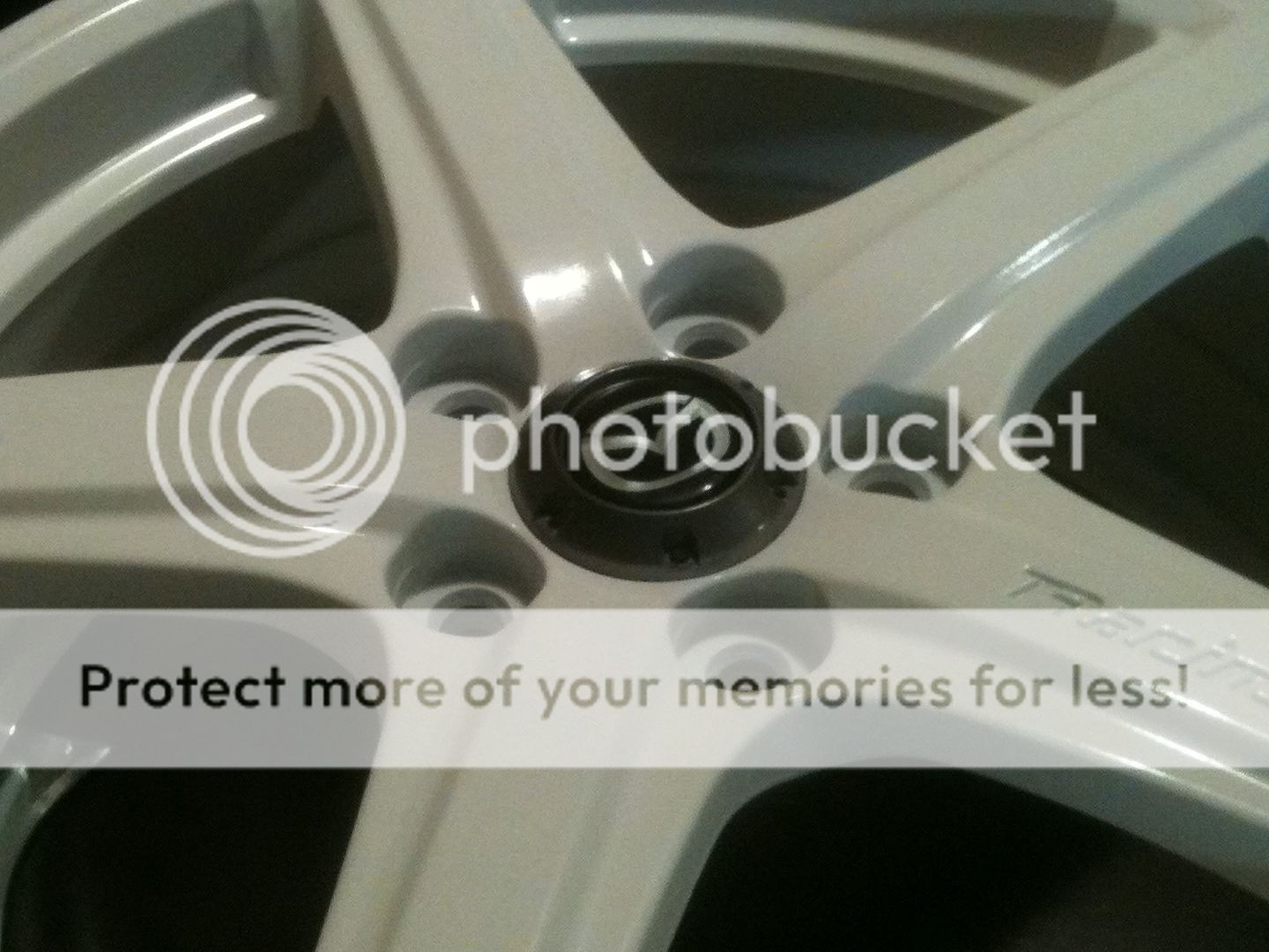

and after all that masking, sanding, primer, sanding business, got to put down white on the faces.

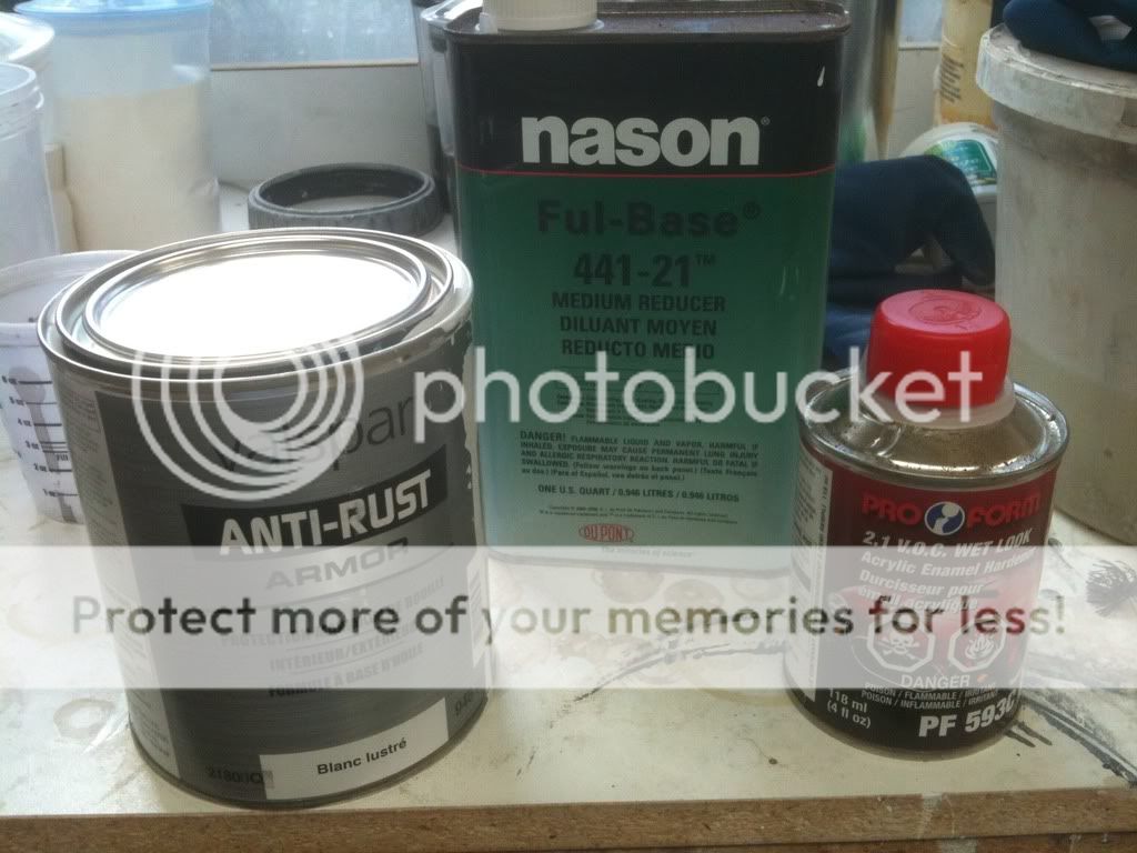

Products used;
using the gloss enamel as a base because its very cheap, finishes hard when used with the enamel hardener, sprays beautifully and when used on the inside of my wheels, covers them up beautifully and doesn't need a clear.
faces will get a dose of autoaircolors 4301 pearlized white.

Should i paint the center caps to match or leave them alone?
I raced a cobalt that should've taken my stock MSP down but, it didn't I won clearly. Then, they did the ricer fly by. Really wierd that they didnt beat me because im running 5psi. I think it was a girl driving so that may be why.
there is nothing else that fits ha. pretty sure there arent other caps that fit. I might leave em. kinda like the look. though i think one of them had a chip out. nothing saying i can strip em, paint em again the same color. decided ill do somthing different for pearl cause the auto air colors i was gonna use for pearl white would make the finish pretty almondy. I wanna dust the pearl on, so ill be getting a small jar of silver and orange pearl effect from the body shop when i buy my clear, just mix it into the clear.
the center caps were just rattled last year cause tehy were all scratched ect. I still have the paint to do them again, though this time i would use the same urethane clear as the wheels. i painted them originally with some old school automotive lacquer.
I say leave'em unless you want to match your brake calipers and lugs
ah. im not doing that painted brake stuff. ill buy better brakes that come anodized already ;)
