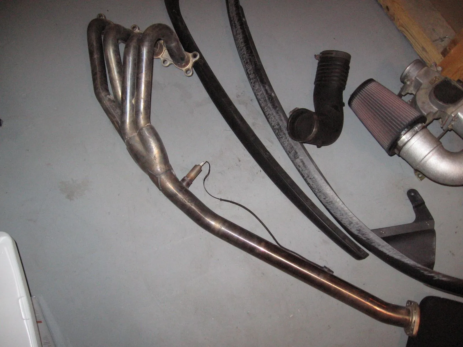

Got a start on removing the transmission to replace the rear main seal and all the other fun shwag back there (clutch, resurface flywheel, trowout bearing and pilot bearing, pressure plate, etc). All stock parts per STS2 rules. Speaking of STS2 rules, I love how little droop she's got in the rear lol
When we took the header off (needs to be removed to pull the tranny), the heat wrap pretty much fell off in chunks. The previous owner of the header put it on wrong anyway, so I guess it's a blessing in disguise. I'm going to be picking up a header blanket to keep underhood temps in check. This should do a much better job than the wrap by itself. I'm also going to wrap the portion of the header between the bottom of the blanket and the flange to keep that temp contained at least up to the cat.

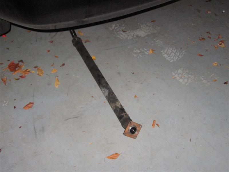

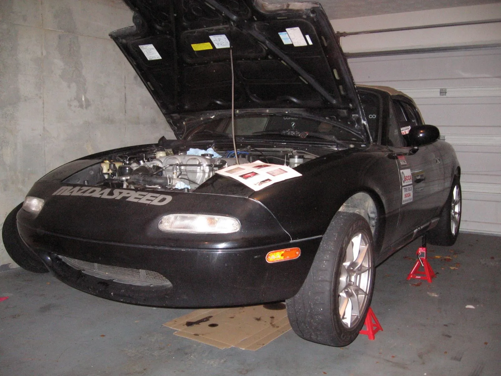

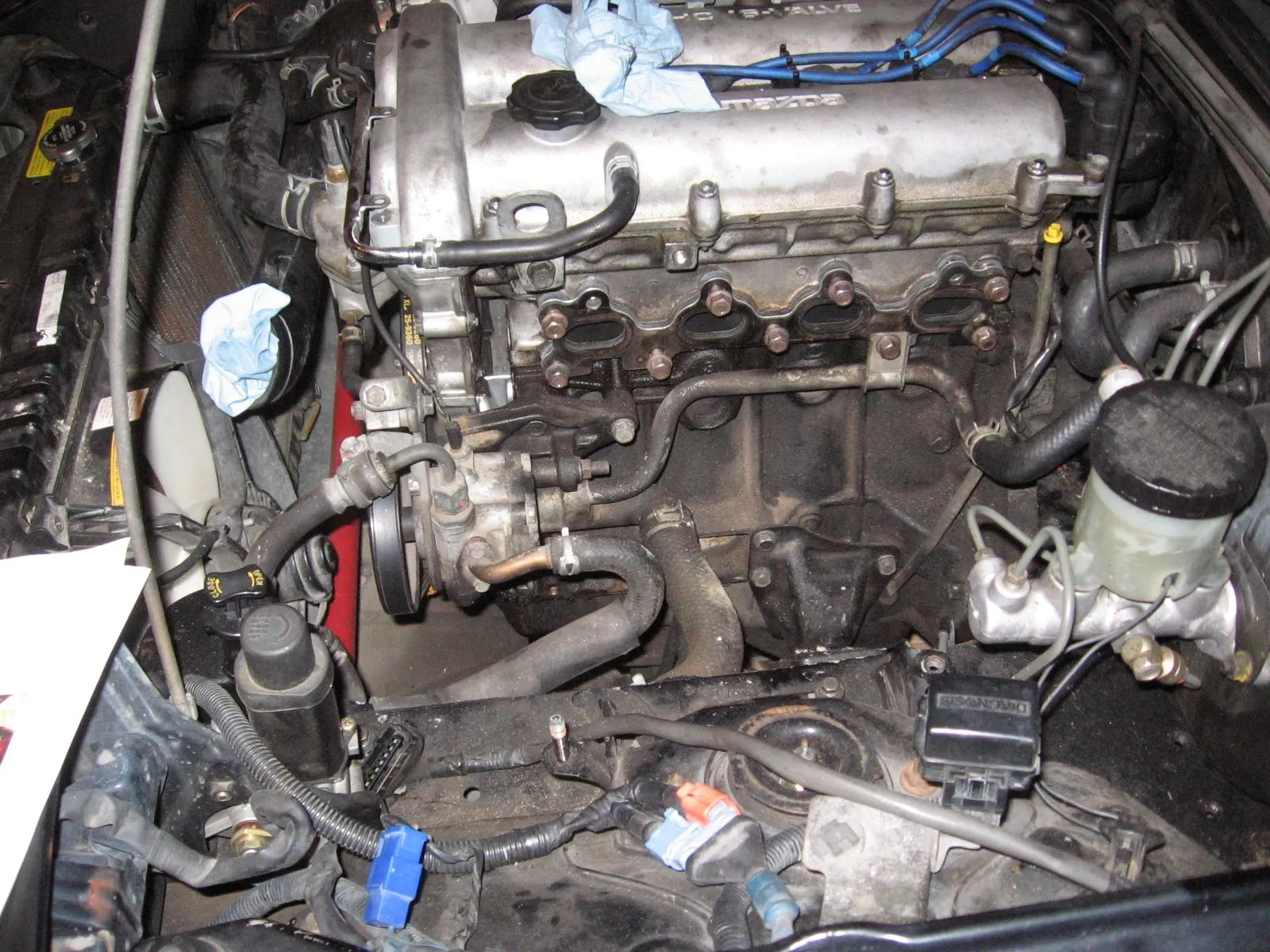

Got all but 2 bolts on the transmission off (just to hold it in), the drive shaft and broke all the bolts for the power plant frame loose. Next step is to get some taller jack stands (so I can actually get the thing out from under the car. Did a test fit w/ the spare, totally won't get under there :(

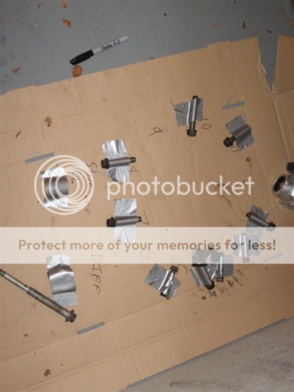

Organization ftw!
