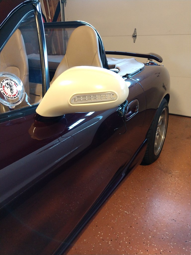

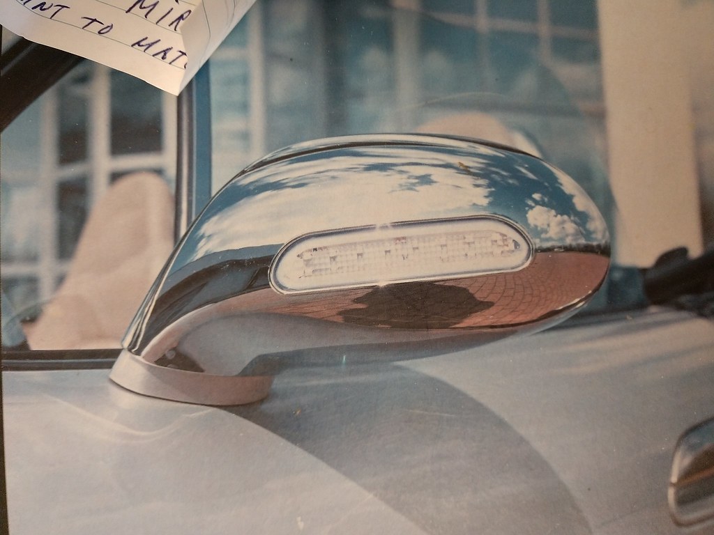

My latest eBay purchase showed up yesterday:
I sat on the fence undecided about this for a while but went ahead and pulled the trigger. More visibility is good, right? I've been trying to obtain a set of mirrors to paint and use for these (you have to drill a hole in the mirror housing to pass the wires through) but so far the used part resellers I've contacted have not responded.
I like those mirrors Mike! More visibility in a Miata is always better!

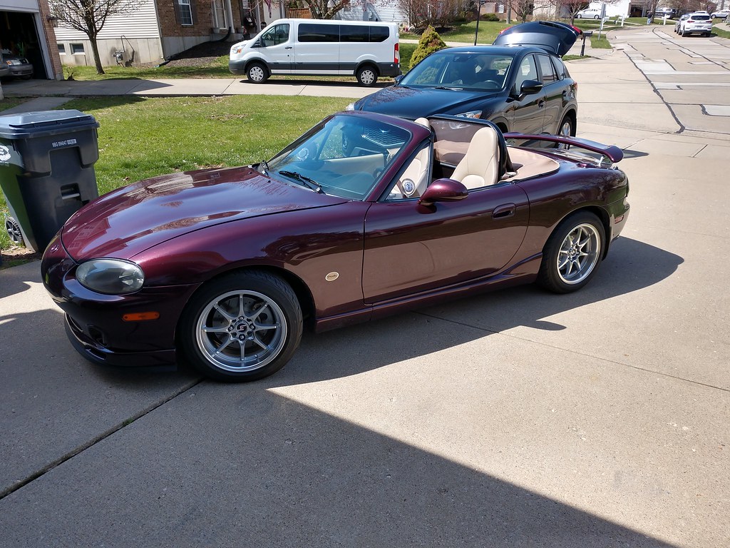

Finally got her out of the garage after about 3 months of winter storage! Took her for a fabulous drive with my wife. Top down. Oh yeah...

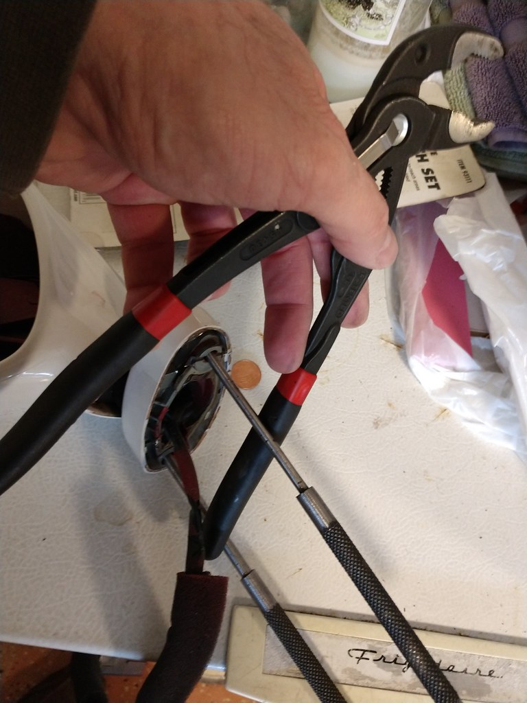

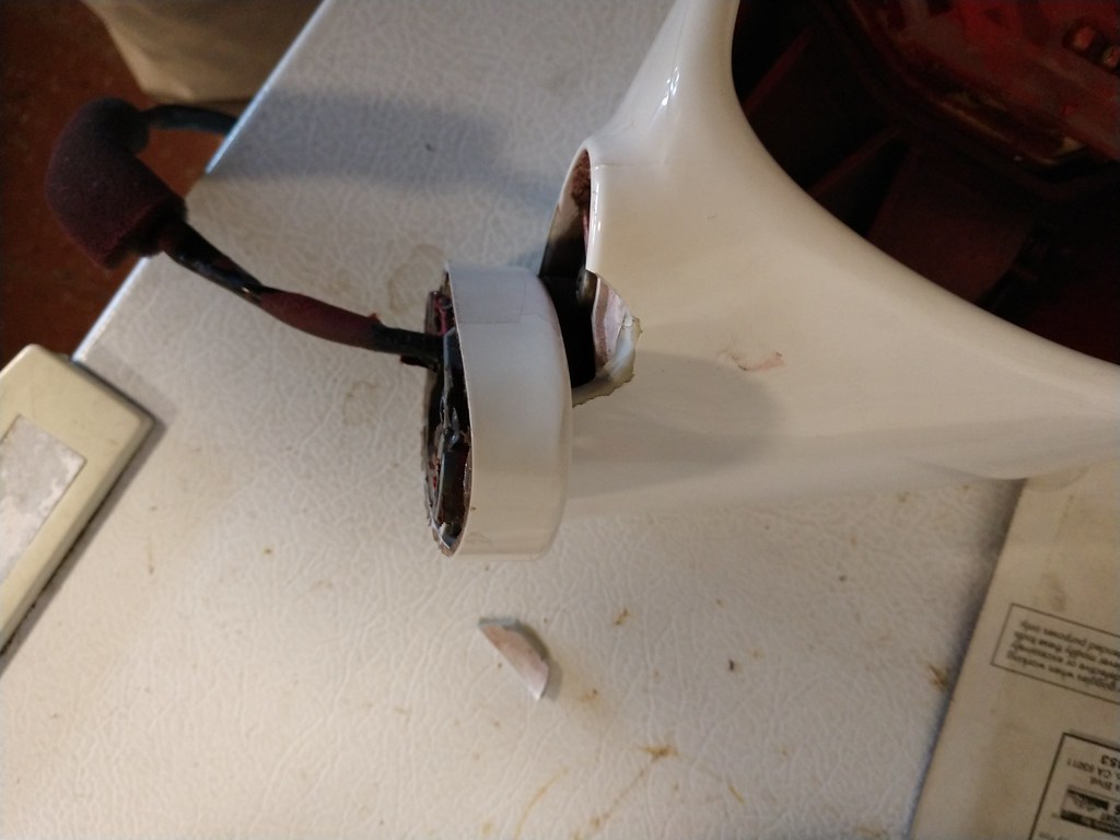

I wanted to try and remove the motor fixture from the interior. This required moving the mirror housing on the base to access the screws. I was not able to physically move the two pieces with just hand power (they are tough to do on the car, off it nearly impossible). I don't have any spanner wrenches so made one up with a couple of pin punches and plier handles:
That worked well, however I needed to move the base in the opposite direction so I could remove the other screw. Didn't pay enough attention, one of the punches moved too far into the base and this happened:

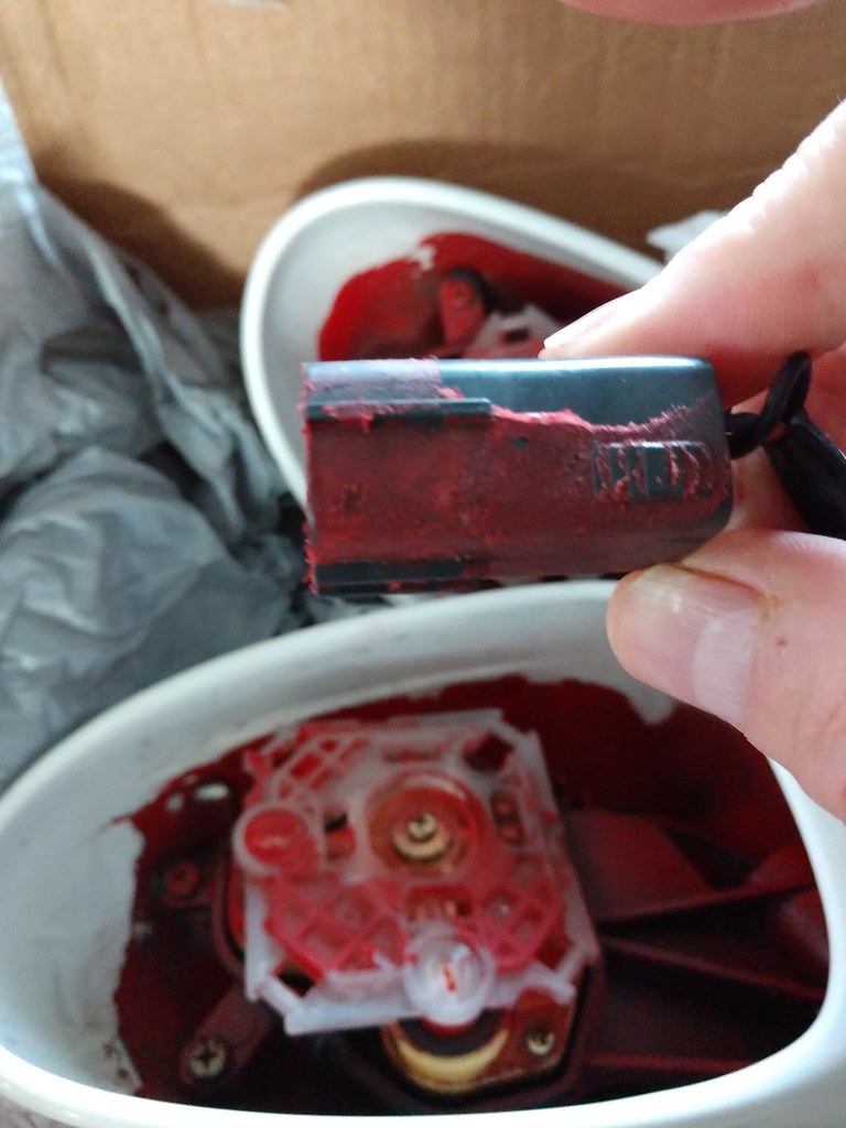

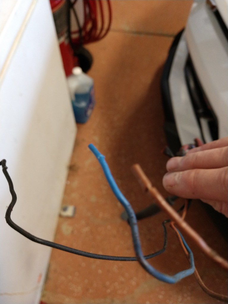

Disappointing. After doing that I figured out I wouldn't be able to remove the interior bits in one piece due to how there is a pivot connecting the base and housing. I don't see any sort of circlip so I'm guessing it's a press fit. I did remove the motor and found something interesting about how the wires are connected. You would expect some sort of connector, but no:
In case you don't know what you are looking at, Mazda used a vamp clamp arrangement.

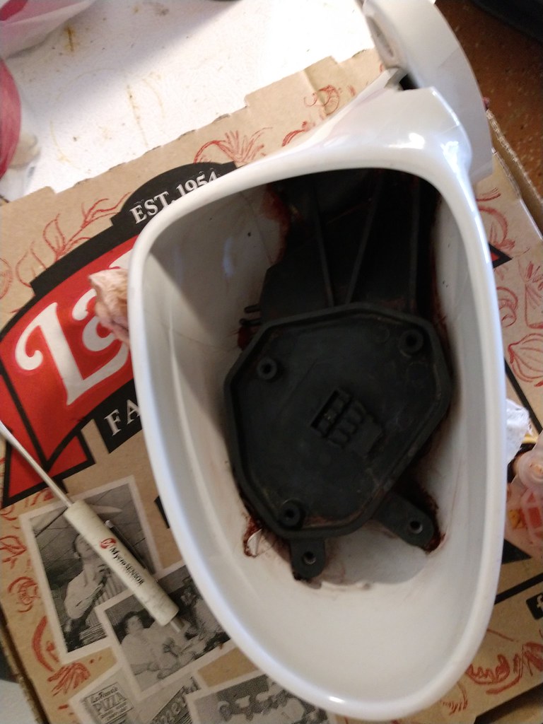

Next up was cleaning as much of the Plastidip from the interior as I could. Peeled what I could then used BrakeKleen for the rest, like I did on the wife's car's wheels. End result:

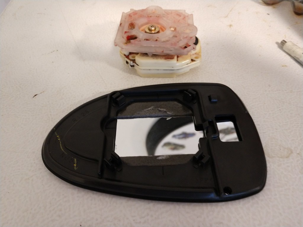

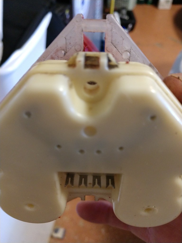

Here is a shot of the back of the mirror and the motor showing the four attachment clips that keep it together:

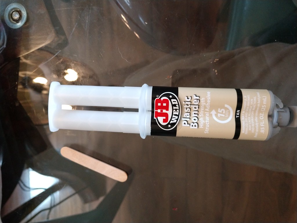

Finally, what I used to glue the broken piece back in:
Once that sets I'll fill in the cracks and prep everything for paint. I'm going to do these one at a time so I don't have too many parts floating around to get confused.

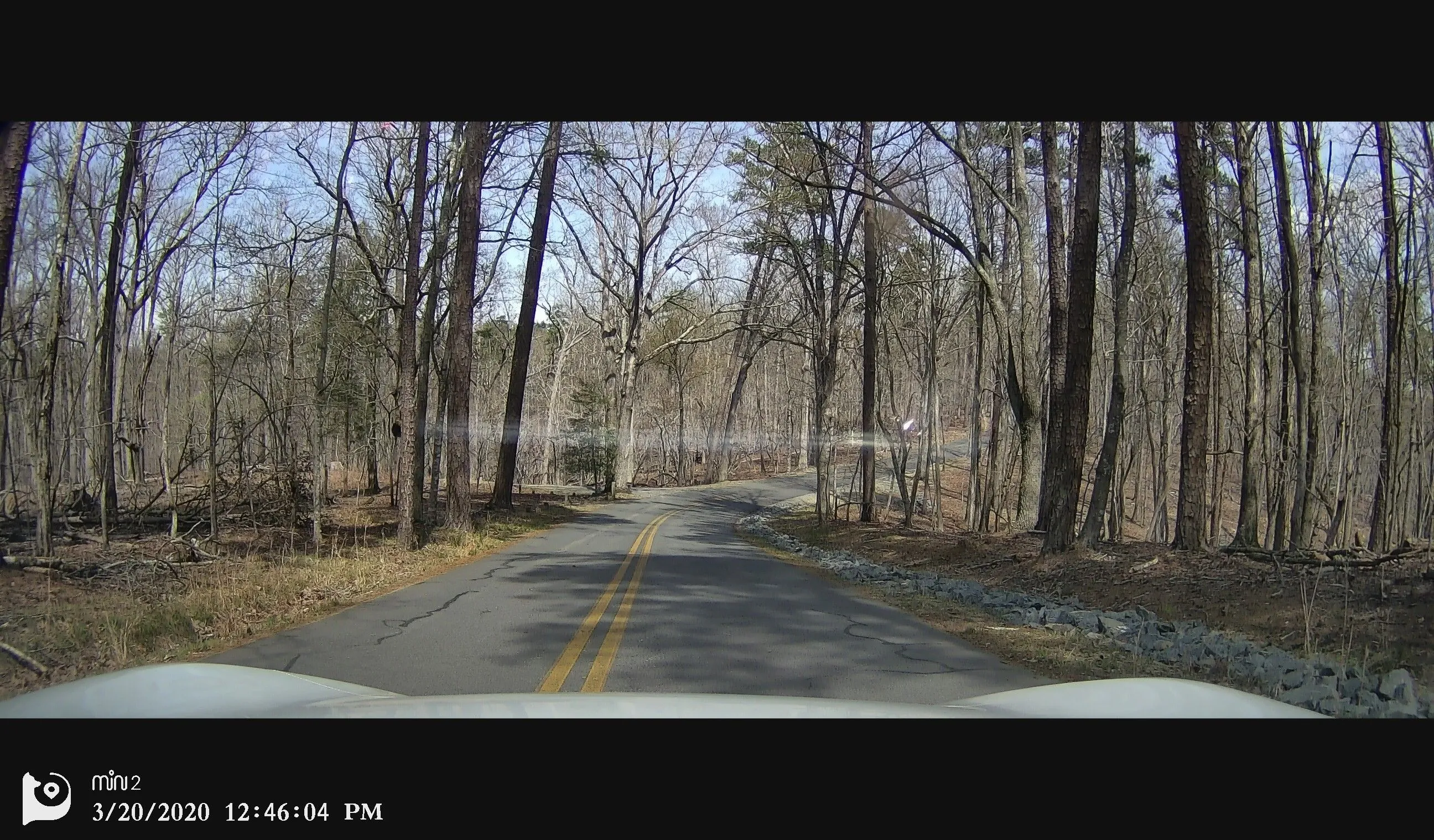

Got a drive in today on one of my favorite local roads. First since upgrading the Sport brakes, love the stopping power.

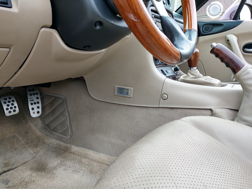

Then I finally installed the LED footwell lights I've had sitting around. Almost done, didn't connect the power wire yet as I didn't want to wrestle around under the dash any further and it's gonna be a PITA.
