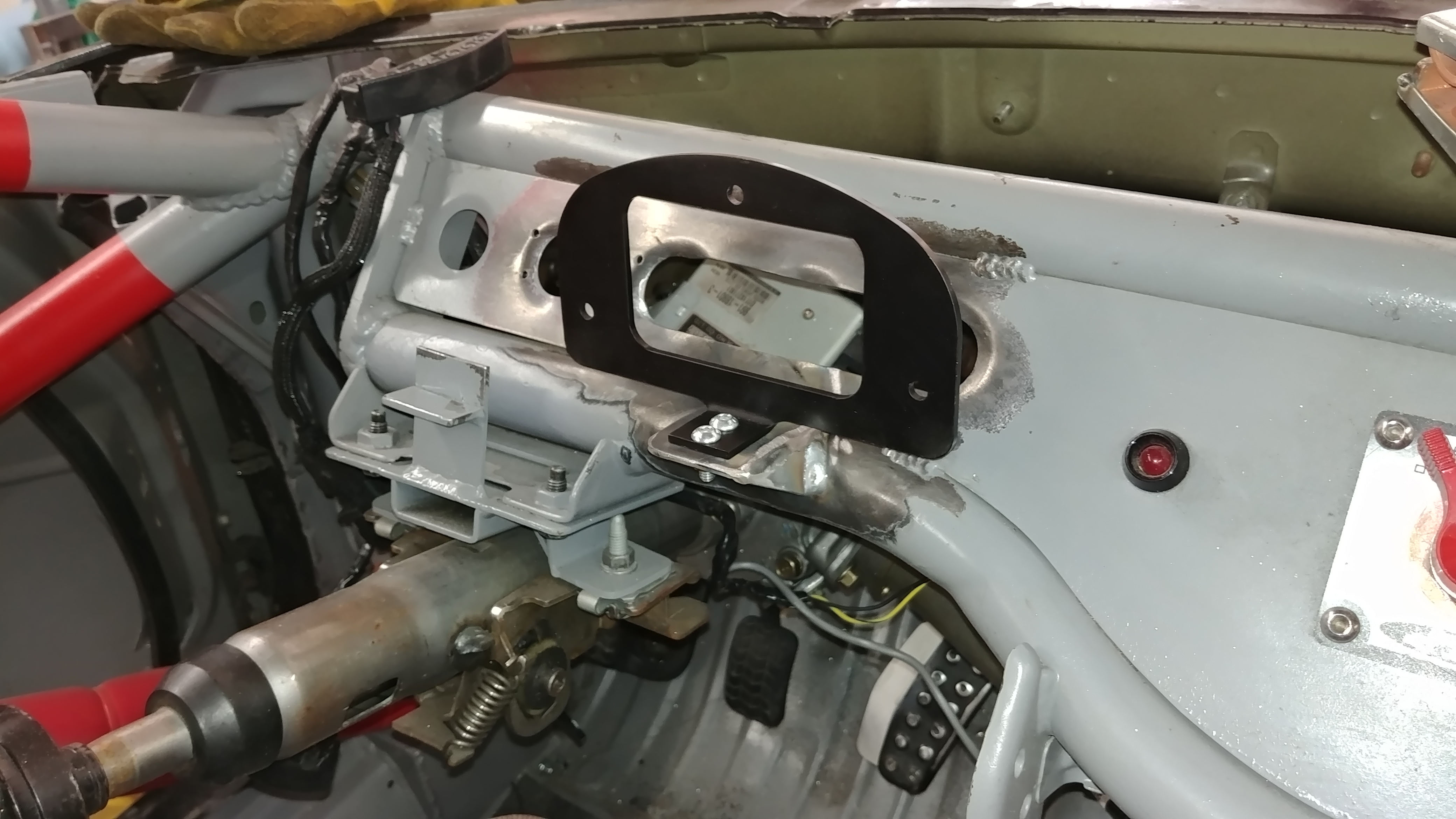

Finished up the RacePak dash mount with a gusset & finished welding it:

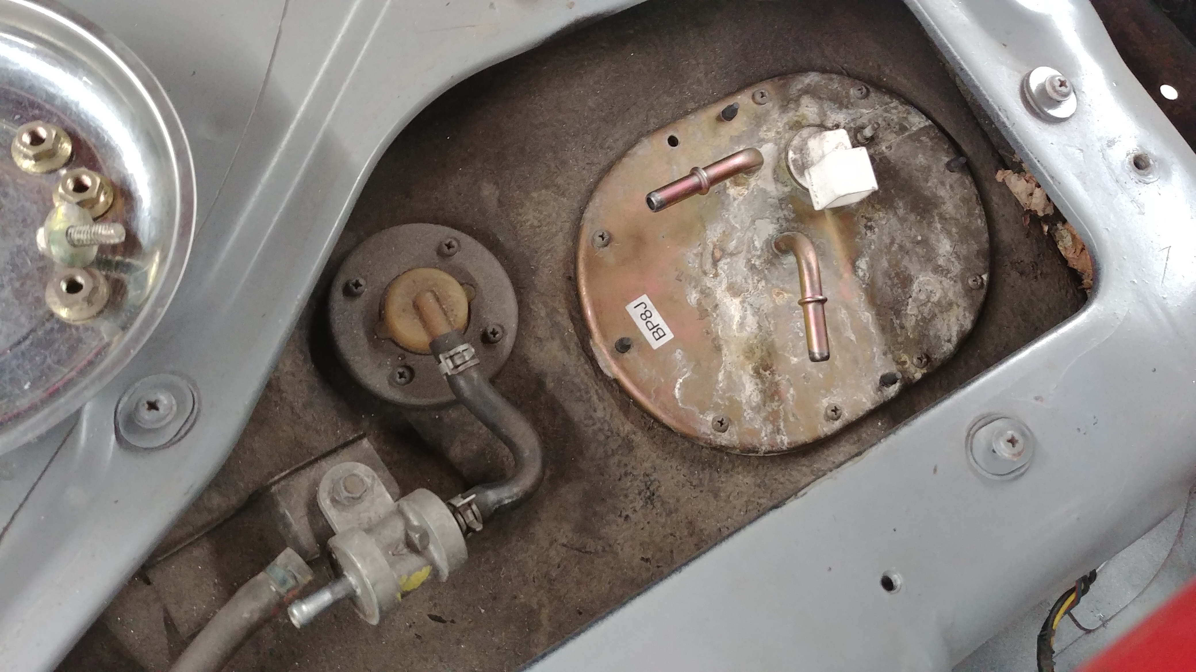

Installed a Walbro 450 pump and swapped from the NA 1.6 to NB 1.8 fuel sending units. The main reason for the swap is that it's WAY easier to adapt the NB's quick-connect fuel fittings to AN fittings, because these exist: https://www.summitracing.com/parts/RUS-644113
I could probably do that with the hardline that runs under the car, but there's enough space & access that compression hardline fittings are fairly straight forward:
