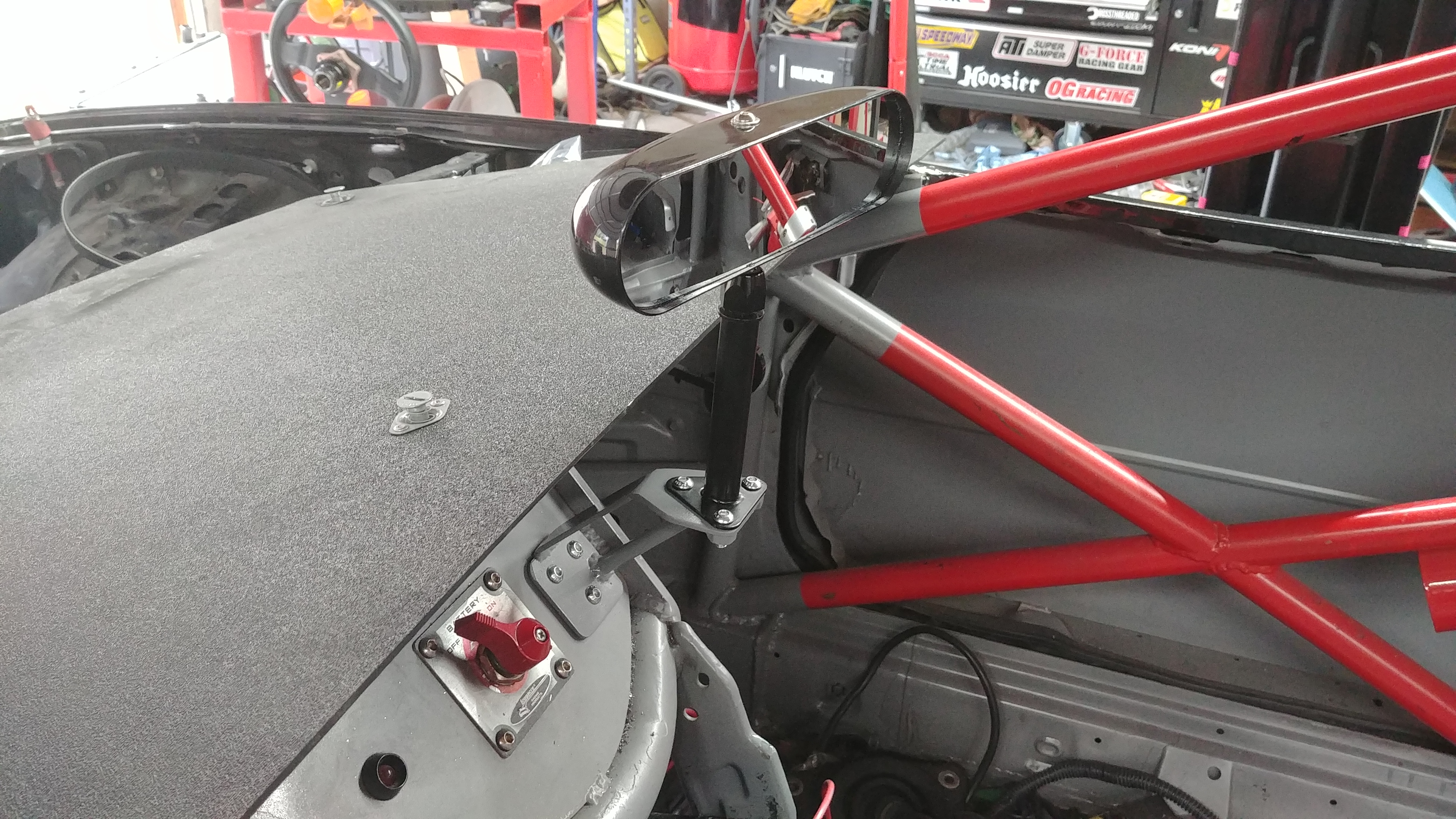

Built myself a bolt-on mount for a center mirror for track work :)
Also the 2nd element for the wang came in :D
