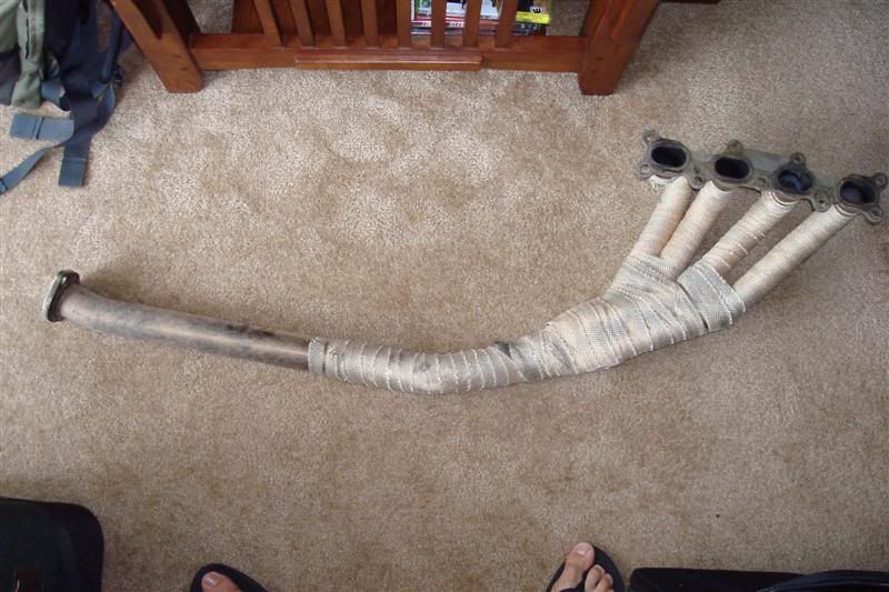

Scored a deal on a use Racing Beat header. It's the new design (4-1 as opposed to the tri-Y of the earlier headers). This header makes better power / torque than the last one, so I was happy to find someone selling it used :)
Only 1 problem: it's wrapped backwards. Anyone know if it would be a big deal to re-wrap it using the same tape, or would it make sense to get new stuff? Also, does anyone know how to undo those metal straps that secure it in place? They look like metal zip ties (but no teeth on the strap). Is there any way to re-use these? If not, I'll probably just install it as-is and suck it up ;)
