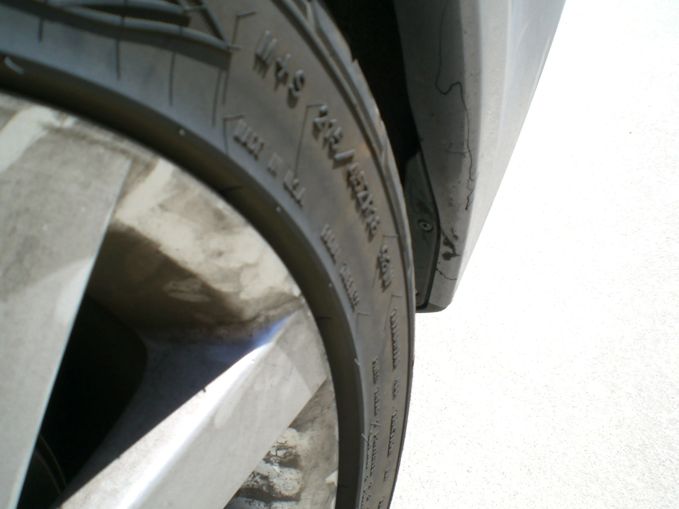

actually this 215(goodyear) is Much wider than the stock 215?? i showed this to Chris(batou) in person just to make sure i wasnt crazy.. and I asked our local tire guy and he says its not the same with every Mfgr?? the good years have the same numbers.. but are physically much different tires.. no idea how thats supposed to work.. but, when i asked the Goodyear guy about the 225-235 size? he laughed and said theyd be way too wide and rub the fenders really hard!!

Seriously, Im not trying to start an argument on this.. thats why I made Chris check for me? i appreciate your info.. but, 215.. isnt always 215..
I took a shot that helps a little.. thats a 1/2" overhang on 215 tire.. on my bridgestone it was flush to the rim.. and thats how i got my curbrash.. the goodyears wont let that happen so easily..

That's a rim/wheel protector, not a wider tire. Some tires have that (like my Blizzaks) and others do not. The OEM Bridgestones didn't have it.
uh.. its hard to picture... but the tire itself is at least one-half to one inch inch wider than the comparible bridgestone.. thats not just the lip.. like i said the tires just way bigger.. believe it or dont.. i know what im seeing.. and

k im not gonna get into an argument here.. im a ASE certified technican.. tunersteve already explained that there are DOT standards for all tires.. the measurements of the stock tires compared to the eagle gt's u have are the same 215mm.. the extra width your seeing is a wheel protector and many tires do not have those.. they may look wider but they are not. every post from you has been incorrect or false.. what more can i say.. (attention) and youd learn more from people who are experienced and know alot more about these cars then you do.
Are you measuring this with a metric tape? Calipers? If not, a "calibrated eye" is no way to judge width.

So, to clear it up:
Stock size is 215/45/18
Common replacement sizes are 225/40/18 and 225/45/18
By going to either of those, here are the dimensional changes:
On a stock wheel (18x7, +50 offset) From my post in the MI random thread:
215/45/18 (stock) tire diameter : 651mm
225/40/18 tire diameter : 637mm (14mm shorter than stock)
225/45/18 tire diameter : 659mm (8mm taller than stock)
215/45/18 sidewall height : 97mm
225/40/18 sidewall height : 90mm (7mm shorter than stock)
225/45/18 sidewall height : 101mm (4mm taller than stock)
215/45/18 revs/mile : 787.3
225/40/18 revs/mile : 804.6 (17.3 more than stock)(2.19% change)
225/45/18 revs/mile : 777.7 (9.6 fewer than stock)(1.21% change)
