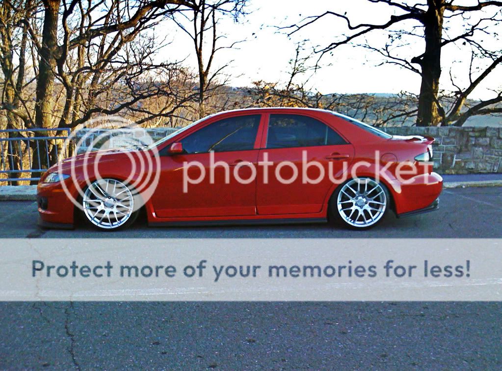

I'm slammed & the only issues I have are tire/fender rubbing up front on a sharp incline.
