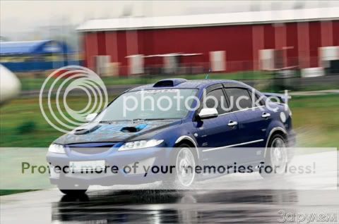

Put my car back to stock as it will be parted out then sold... Soon I'll be picking this up:
Just kidding, lol. But dear god, I cried a little when I saw that.
What I actually did today was shined up my engine bay, looks real nice and clean now :).
- Riced out photo
ideas to clean that car up.. lose all the chrome, lose the roof scoop, unless its functional by getting air into the cabin, paint the front grille inserts (white) black, replace hood, replace gas door. different wheels.. done!! its a better car. the wing doesnt look that bad from that angle, ive seen way worse.
