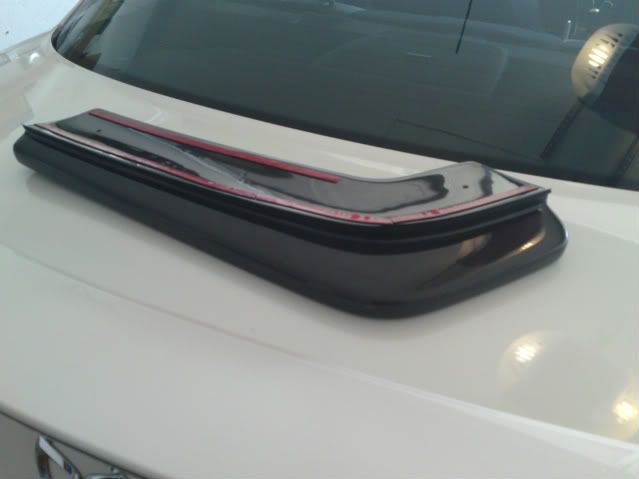

Got my AutoEXE carbon fiber rear splitters
The left one was actually slightly mishapen on the inside so it was a B to install and did not line up perfectly. so it was a little bit crooked.
:) good times
I like those rear splitters. Eventually I am going to make my own mztune style front splitters. As soon as I get some foam in a block large enough to make a mold...
