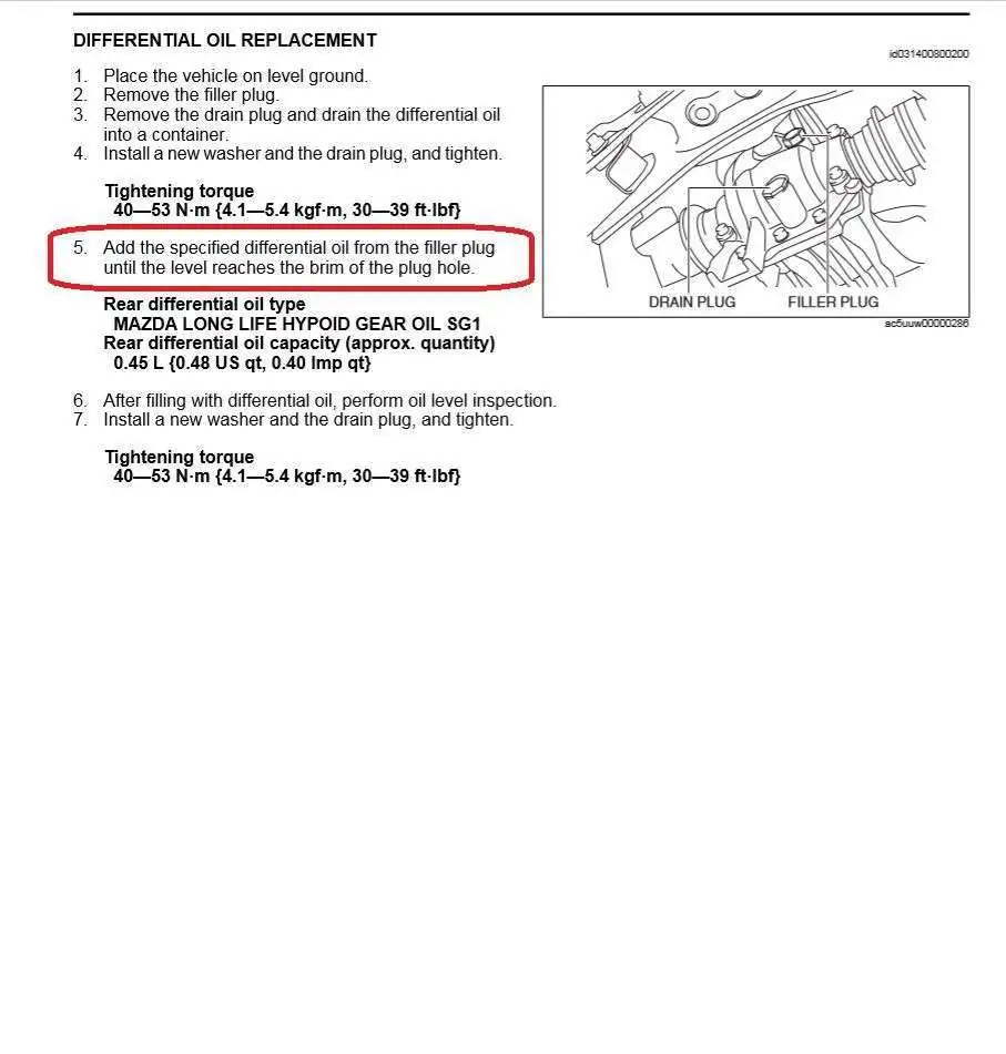

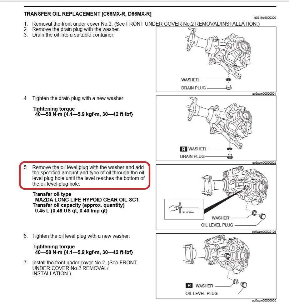

Gotta love contradictory statements by Mazda:
"The level is normal if it is between the MIN and MAX marks."
"If it is near or below MIN, add enough oil to bring the level to MAX.”
Here is from Mazda Workshop Manual:
This’s fine with 0.48 quart of gear oil to fill the front transfer case to the brim of the fill hole.
But:
For rear differential, you do need about 0.75 quart of gear oil to fill to the brim of the fill hole, not stated 0.48 quart (or 0.37 quart specified for gen-2 CX-5)!
So which Mazda way do you want to follow? ;)

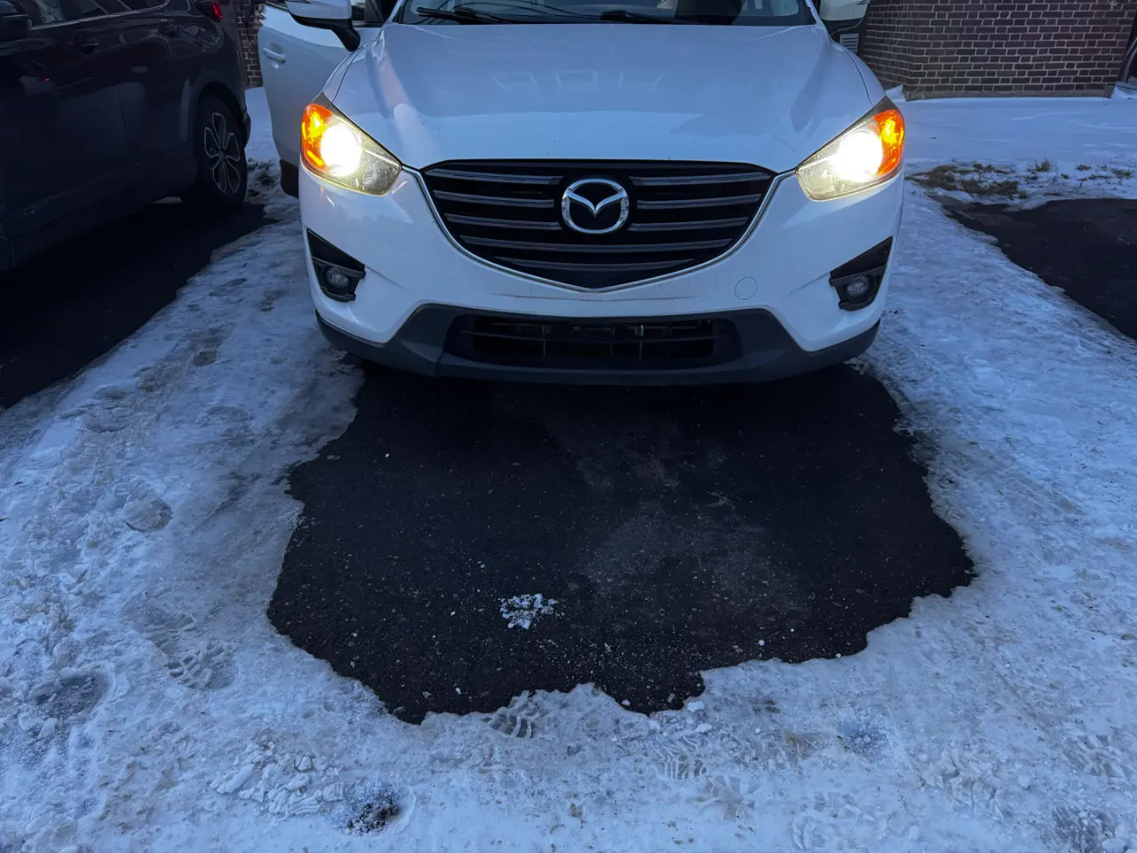

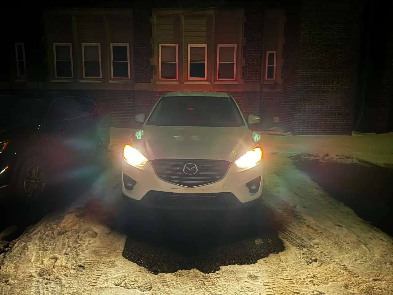

Today I “downgraded” my headlights from LEDs to halogens (One set Sylvania, the other Phillips) and I could not be happier. This car came with LEDs when I bought it used, and while I never got flashed for blinding anyone from the projector cut off, the actual light pattern and intensity is lacking compared to a halogen. Another annoyance was while using the brights, road signs got absolutely blown out late at night. Process took all of 5 minutes.
View attachment 333102View attachment 333103
How some people think installing PnP LED bulbs is an upgrade baffles me. The added foreground makes it worse for distance. Heck, a simple bulb upgrade yields better results than the expensive LEDs.
