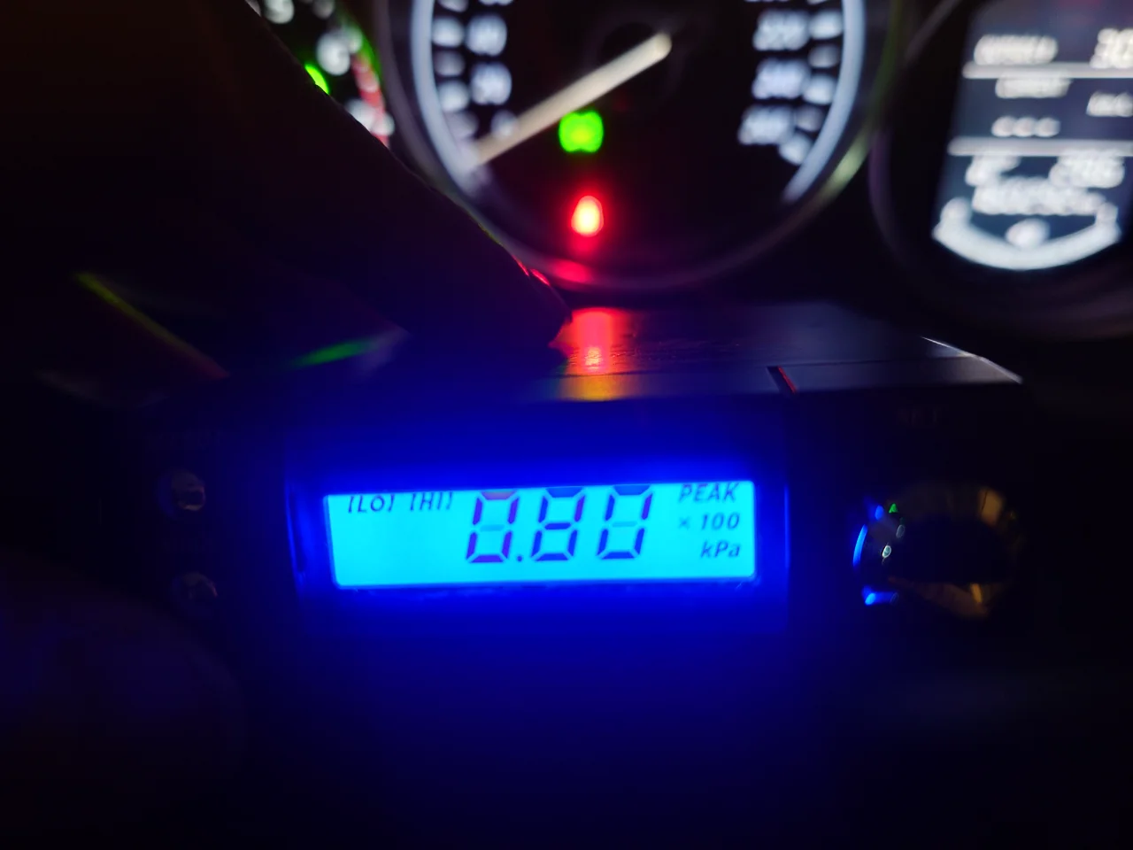

I tried to get the 2.5n/a to 14.5psi boost and it won't survive or will explode. 🤣🤣🤣🤣

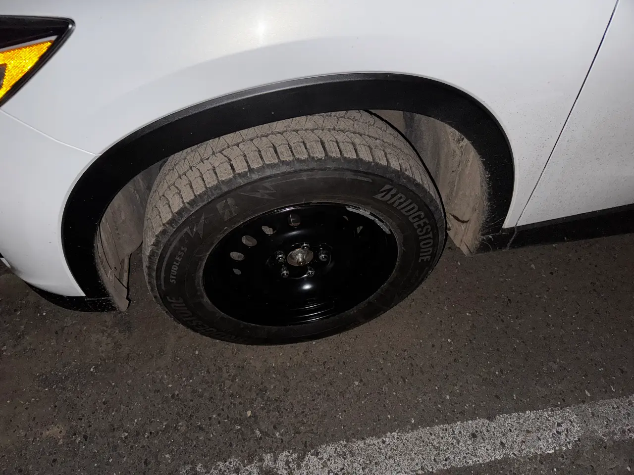

Winter tires are on steel rims (finally). First impressions are steering seems heavier. Glad to have these on before the snow starts really falling!

Just out of curiosity: what's the deal with the steel rims? I learned to drive on snow ( manual transmission - long time ago) but I never knew or nobody told me anything about this. Is it better for the car to have steel rims in the winter?
Far cheaper than alloys, bend instead of crack in cold weather (it can be hard to see curbs when there’s snow banks blocking view), and they sort of protect the brakes from snow buildup. Lots of times driving between Duluth and Houghton in 8”+ of snow I’d arrive at my destination with the inside of the wheels absolutely caked with snow. It can cause weird vibrations until cleared.

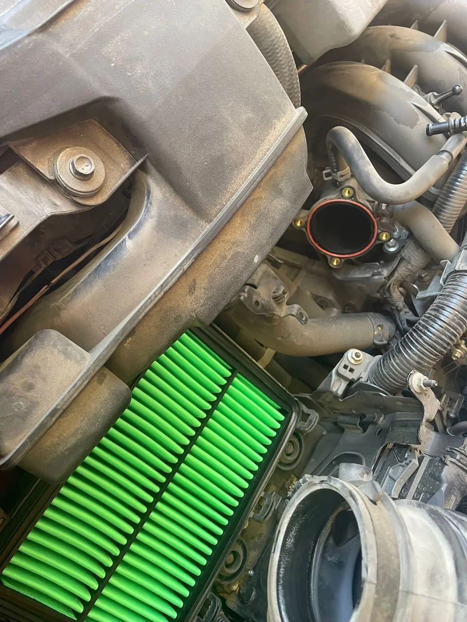

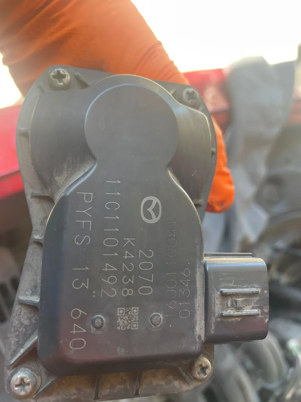

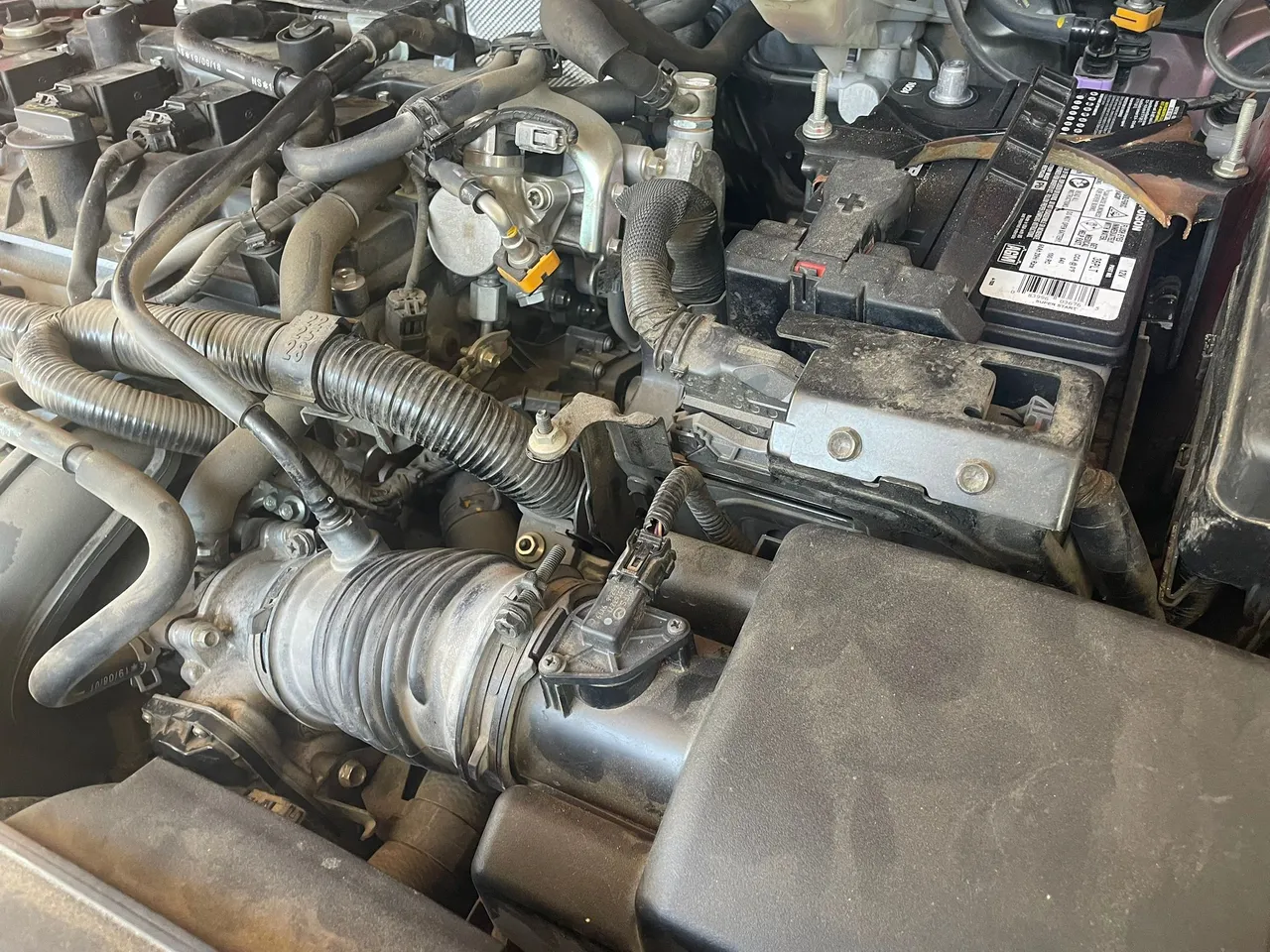

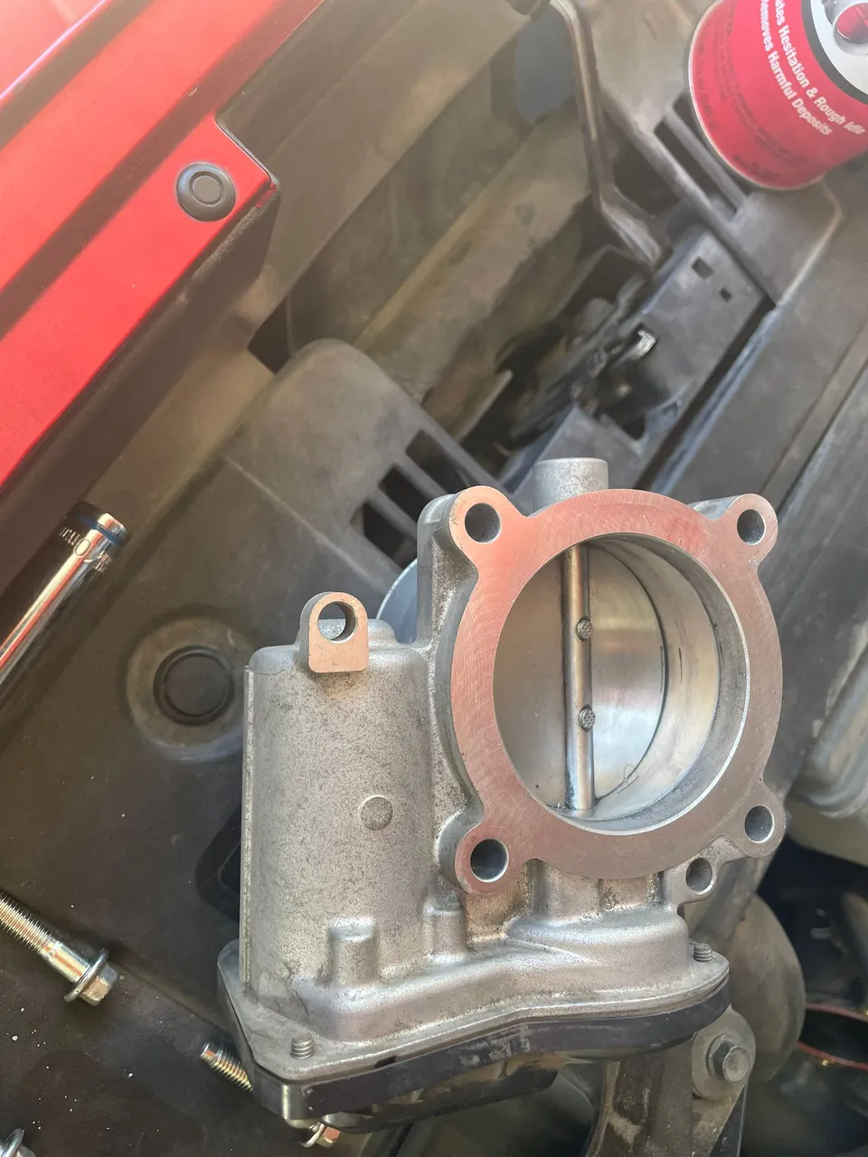

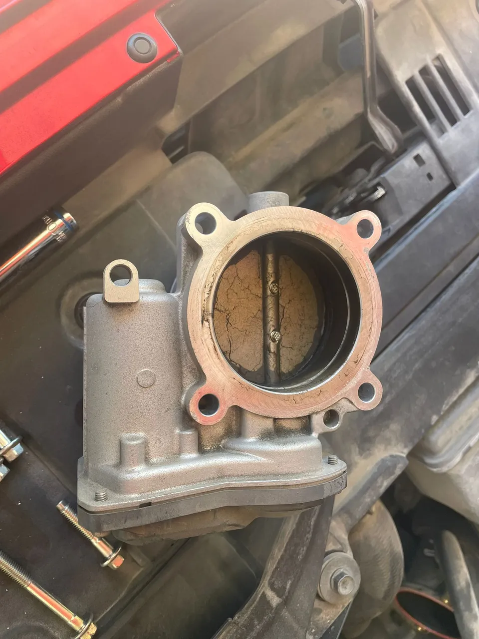

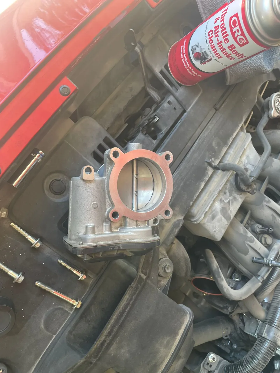

Cleaned the throttle body today. Never cleaned it so I was curious to see how dirty it was. As many other people pointed, once you remove the assembly as I did, do not force the valve open, leave it the way it is or you can damage the whole assembly.
View attachment 332536View attachment 332537View attachment 332538View attachment 332539View attachment 332540View attachment 332541View attachment 332542View attachment 332543
That's something I would like to do....also the MAF and MAP sensors.
