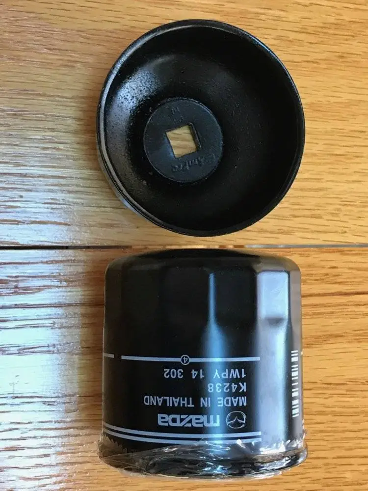

I purchased my 2020 Signature at the beginning of October last year. For the last month, the dash has been telling me it's time to change the engine oil, which I did yesterday.
I purchased the Mazda 1WPY-14-302 oil filters six months ago to check that the filter removal cap I used on my previous 2000 Camry would fit. The cap fit fine. 5W-30 full synthetic ILSAC GF6A oil purchased from Costco.
After draining the oil out of the pan and installing a Fumoto drain valve I was quite surprised to find that the oil filter removal cap did not fit the factory installed oil filter; the filter was too wide!
WTF? I've been reading this board since mid-summer last year and can't believe I missed the fact that the factory installed oil filter is wider in diameter then the current made-in-Thailand ones being sold!
Fortunately, the old "hammer and screwdriver" method for removing an oil filter worked. But color me surprised that this was needed!

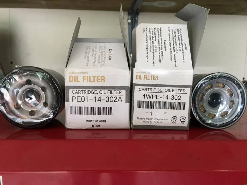

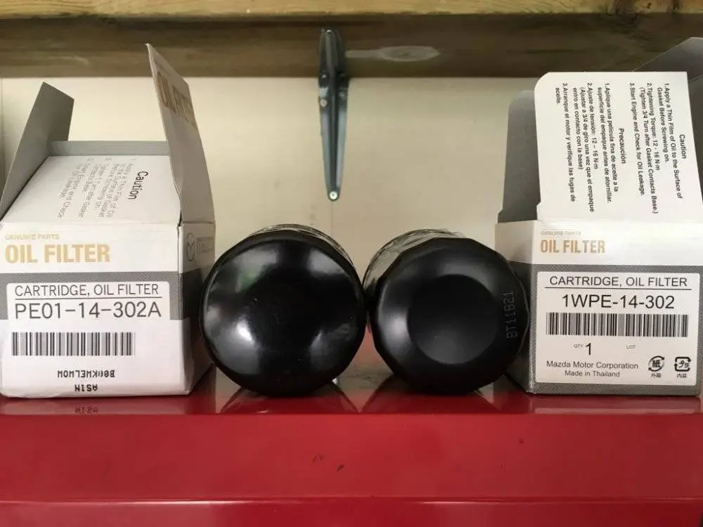

Yes, Thai made OEM Denso oil filters are a bit smaller in diameter than Japanese made OEM Tokyo Roki oil filters. The stock oil filter on 2.5T is Japanese made Tokyo Roki PY8W-14-302, but Mazda North American Operations had stopped supplying PY8W-14-302 a couple of years ago and it’s superseded by Thai made Denso 1WPY-14-302 which is smaller. Usually it isn’t an issue unless you use cap wrench on the oil filter. I ordered a "Genuine" Mazda Oil Filter Wrench A255 for $10.20 from Med Center Mazda along with oil change kits years ago but it ended up exactly the same as https://www.amazon.com/dp/ (commissions earned)https://www.amazon.com/dp/ (commissions earned) The sizes of CTA A255 cap wrench are 65 & 67 mm with 14 flutes. It fits Mazda OEM Japanese oil filter perfectly on 67 mm and OEM Thai oil filter on 65 mm size.
Here is the size comparison between Japanese and Thai oil filters for my 2.5L. The sizes of OEM oil filters used on the 2.5T are the same as on the 2.5L.

This makes sense, as Mazda 1WPY-14-302 oil filter is made in Thailand by Denso (Toyota).

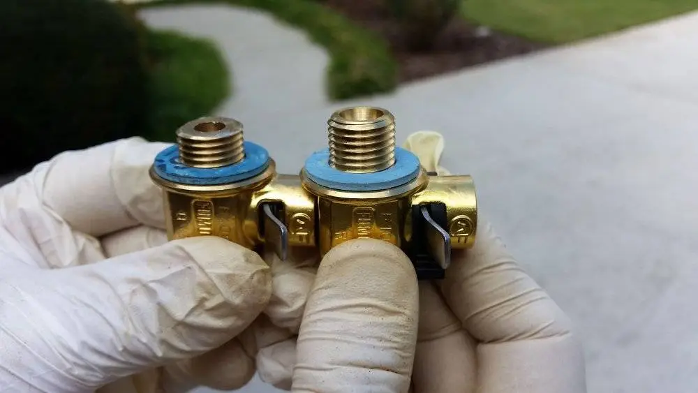

⋯ and installing a Fumoto drain valve
Fumoto drain valve has its drawbacks too. Once installed, the threaded part of Fumoto valve is too long and extended into the oil pan so that it is not flush with the pan inside. This causes good amount of old oil (and debris if any) can’t be drained out. And it could allow more build-ups of unwanted particles inside the pan. Not to mention it’s slower to drain as the oil drain speed is restricted.
Above is a very informative link about
Fumoto drain valve although this "Mythbusters: Fumoto Engine Oil Drain Valve" is for a 2008 Subaru Impreza WRX STi:
NateCal said:
Myth #1- The Fumoto Engine Oil Drain Valve, once installed, extends into the oil pan so that it is not flush and could allow for build up of unwanted particles inside the pan.
So as far as Myth #1 goes, it is:
The Fumoto valve extends aprox 1/8" to 3/16" into the oil pan.
Myth #2- Due to Myth #1, metal shavings and other particles will remain in the oil pan when using the Fumoto Oil Drain Valve to change your engine oil.
Plausible!
Also this observation is consistent with the statement I saw for the CX-5 with a Fumoto drain valve:
NateCal said:
To me, that says the 1/8" to 3/16" of the valve extended inside the pan is NOT stopping the oil from bringing all the crap out with it when it is draining.
However, I cleaned my oil pan again, and planned to remove the Fumoto valve and flush a full quart of fresh oil through just to see what else would come out without the valve installed.
When I removed the valve I was kinda of shocked by the amount of oil that was still in the oil pan. There was probably a good 10 second stream of oil that came out once the valve was removed.
Then I ran the full quart of fresh oil through (without the valve installed). I then repeated the process of carefully dumping the oil, leaving the crap behind, to examine the oil pan. And the was NOTHING. The pan was clean as a whistle. Everything came out when I initially drained the oil using the valve. Even with the little oil that was trapped in the pan by the Fumoto valve.
nutcore said:
thank you for some actual evidence Nate. It's good to know that Fomoto lies to your face claiming that the threads don't extend into the pan.
Q. Does my Engine Oil Drain Valve protrude into the interior of the oil pan and prevent full drainage of my engine oil?
A. No. The threaded oil drain plug hole is always reinforced to accept the threaded bolt of the drain plug. In most cases, the Engine Oil Drain Valve will not extend past this threaded portion of the drain hole and will allow the oil to be properly drained. Your Engine Oil Drain Valve will let you drain your engine oil while it is hot without burning your hands and it is much more effective than trying to pump the oil out from above.

Thank you for the replies regarding the difference in diameter size between the factory-installed oil filter and that of the currently available made-in-Thailand oil filter. I'm still surprised that this isn't common knowledge.

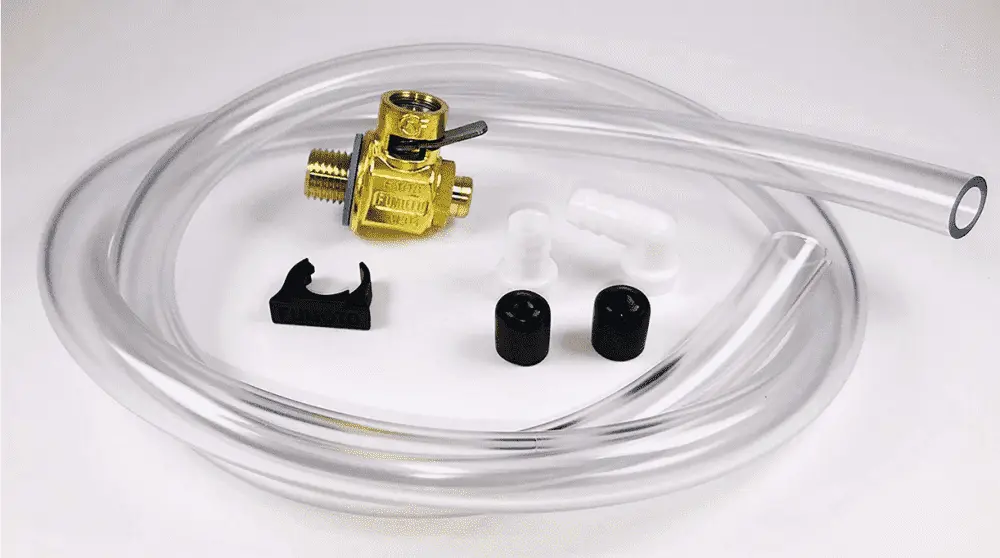

Exact part no. for the Fumoto valve? Did you get the short or long nipple? did you need their exender adapter or does everything clear the pan okay. Thanks
2020 CX5 Signature
I purchased an F106S short nipple with included locking clip, right angle and straight plastic attachment and drain hose, and two nipple covers off of eBay. No adapter needed, even though the Fumoto website said it might be necessary. I can see how the valve sticking out a little ways though does take up a bit of room where the oil filter is located, but the cap tool I have to remove the filter still easily fits in the space.
If I had to do it again, I might purchase the F106N with the longer nipple, now that I see how protected the valve location is.

I've used them on my last 5 cars. Never needed the adapter though they usually say "may need adatper" - smh, they should know if it does or doesn't
The Fumoto claims it is unlikely that the Fumoto valve would be sticking out inside the oil pan, and Fumoto valve would allow you to drain just as much oil as your original drain plug. But we all know these aren’t true for CX-5 and many other vehicles unless you modify the valve by yourself.
Does my Fumoto valve stick out inside of my oil pan?

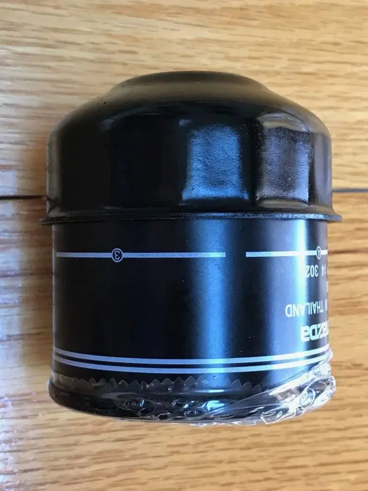

Yes. One of the good things of the OEM Thai made Denso oil filters is there’re —①——②——③——④— marks on the metal shell, so that you can tell easily how much partial turn you have made with these marks as the reference point after contacting the seating surface.

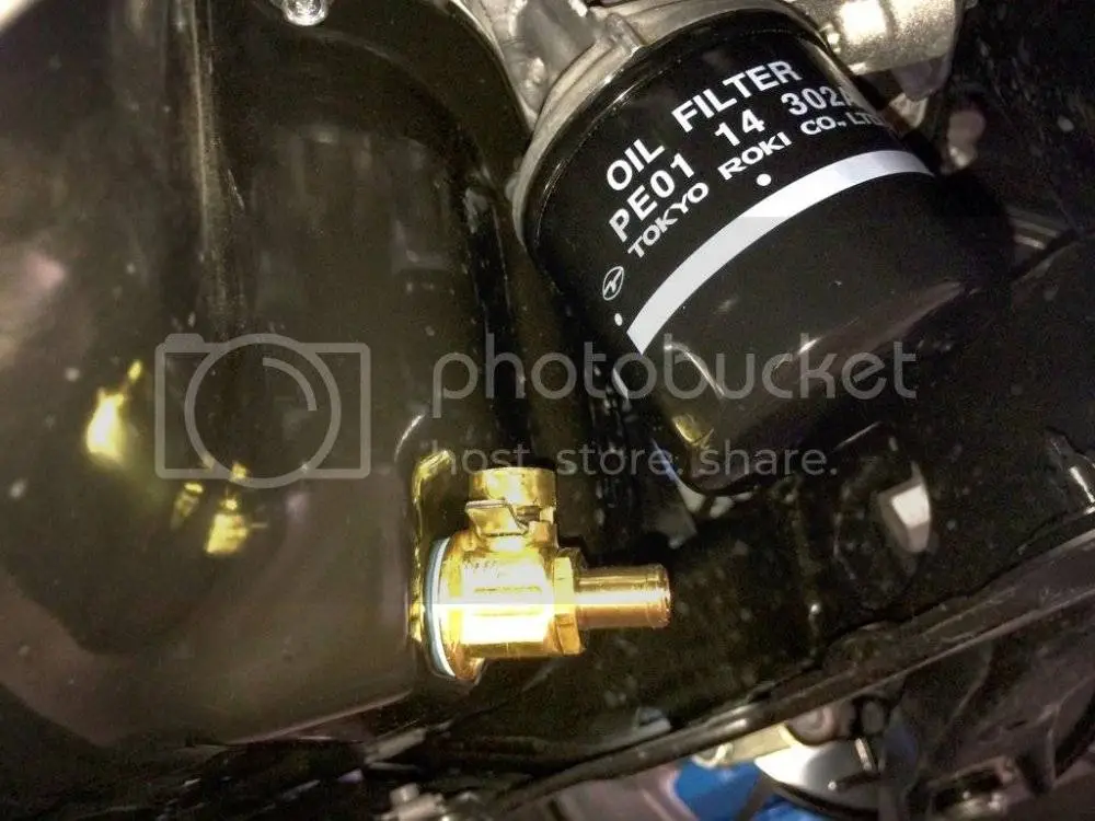

Just changed the oil yesterday on my (new to me) 6 and in the process installed a Fumoto F106N (long nipple). It fit just fine and I like having the longer hose attachment. There were no clearance issues of any kind. Bought on Amazon for $23+.
I also bought 10' of drain hose at Home Depot for $3+
I am looking forward to doing away with the stupid drain pan! Now if I could find a nice substitute for the plastic push-fasteners on the access panel ... ;)

Given the concern for not getting all the oil out of the oil pan, I cut about 1.5 threads off the valve after doing my best to measure how deep the threaded part of the pan is. The brass is soft and I was able to clean it up using a small file. I'm looking forward to the next oil change as it should be easy.
Thanks to whoever suggested using plastic shopping bags around the oil filter. That worked great!

Hey guys, I came across a review on Amazon that brings up an issue with this valve. Below is the key part of the review:
A few months later, I went to replace the oil pan gasket so I drained the oil using this valve and removed the bolts around the pan. I noticed that when I tilted the pan, more oil drained even though the drain is located at the very lowest point in the pan. Then when the pan was removed, I saw why this was happening. It did not drain all of the oil. The valve extends into the pan.
The drain valve threads into the hole in the bottom of the pan, but it also extends through the hole, in my case by about 3/16". So when you open the valve, all but the last 3/16" of oil is drained, not ALL of the oil. Also, any thing heavy (carbon chips, metal chips) stays in the pan instead of draining out with the oil.
I was going to get this valve for the convenience factor, but not sure that's more important than getting all the old oil and fragments out. Your thoughts?
Bingo! Oil drain valves are a solution looking for a problem.
Anyone who finds it too difficult to remove a plug to drain their oil a couple of times a year probably shouldn't be changing their own oil. You let the plug fall into the drain vessel as you unscrew it and after the oil has drained, you pick it up with your rag and wipe it off. That's why all oil drain vessels have a screen or obstruction big enough that the drain plug cannot fall into the vessel.
The other potential issue with a drain valve is failure. A properly torqued plug is not going to fail. Failure could happen from hitting a rock or other hard debris on the road at speed or it could simply leak due to a faulty valve. Of course drain valve failure is very rare so that alone is not a big reason to avoid them. And the fact that they don't allow a complete drain is, in the bigger picture, not a huge deal. The best reason to avoid them is that they are an unnecessary expense. I say "unnecessary" because a drain plug works very well and poses no issues. Besides, you don't have to buy the drain plug - it's included with the car for free!
Put the money in the bank or retirement account and let it grow, compounding every year for 20-40 years. You might be surprised how much it actually improves your life.
