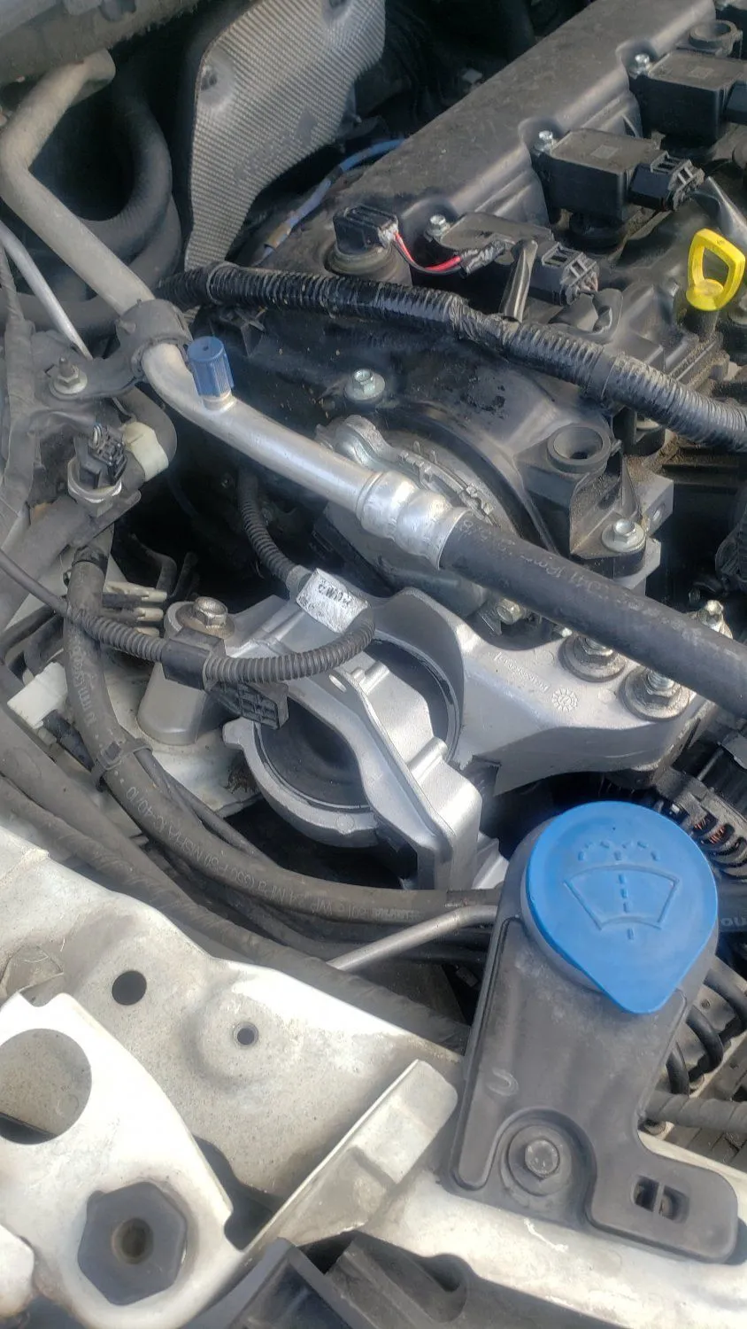

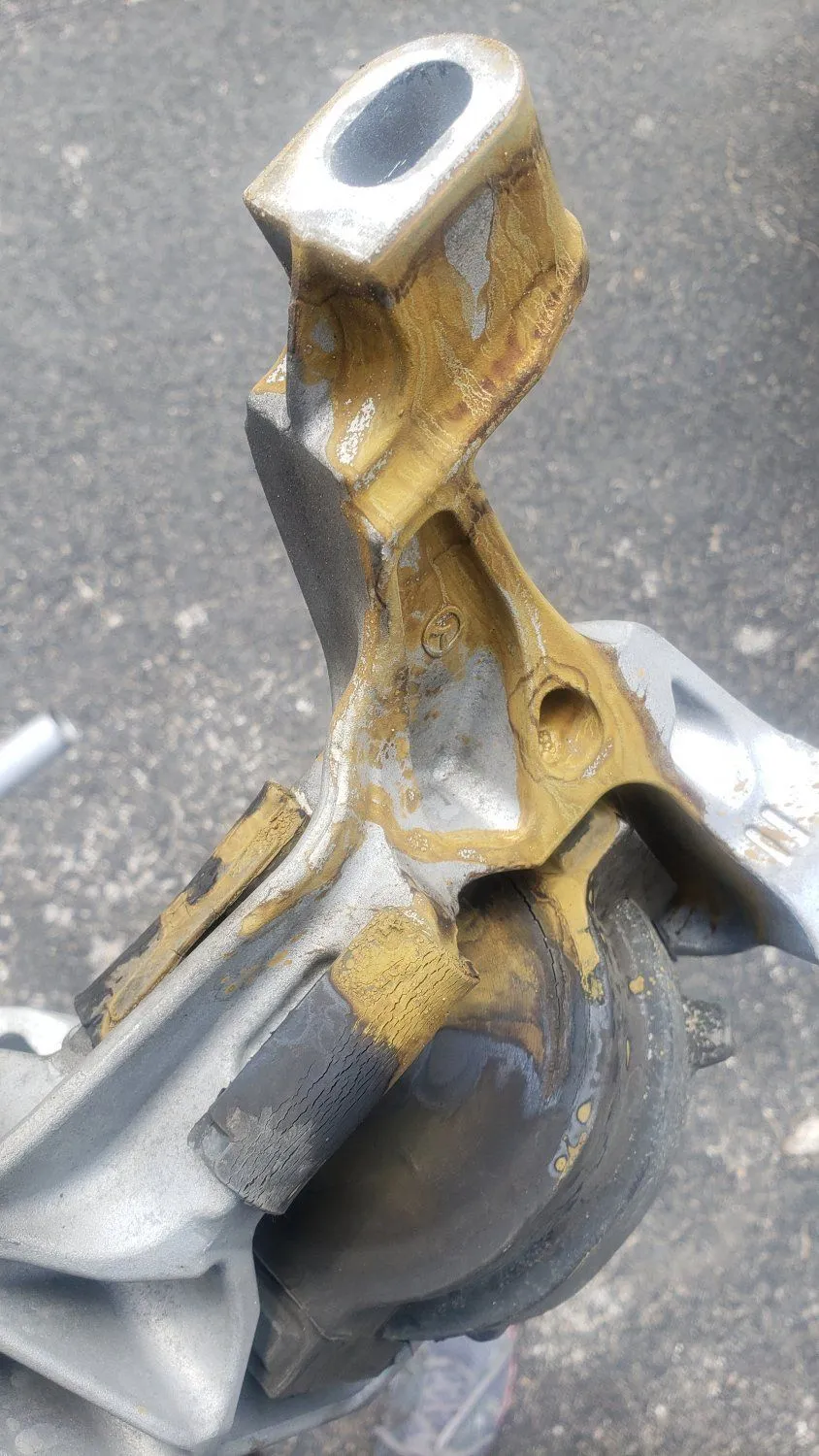

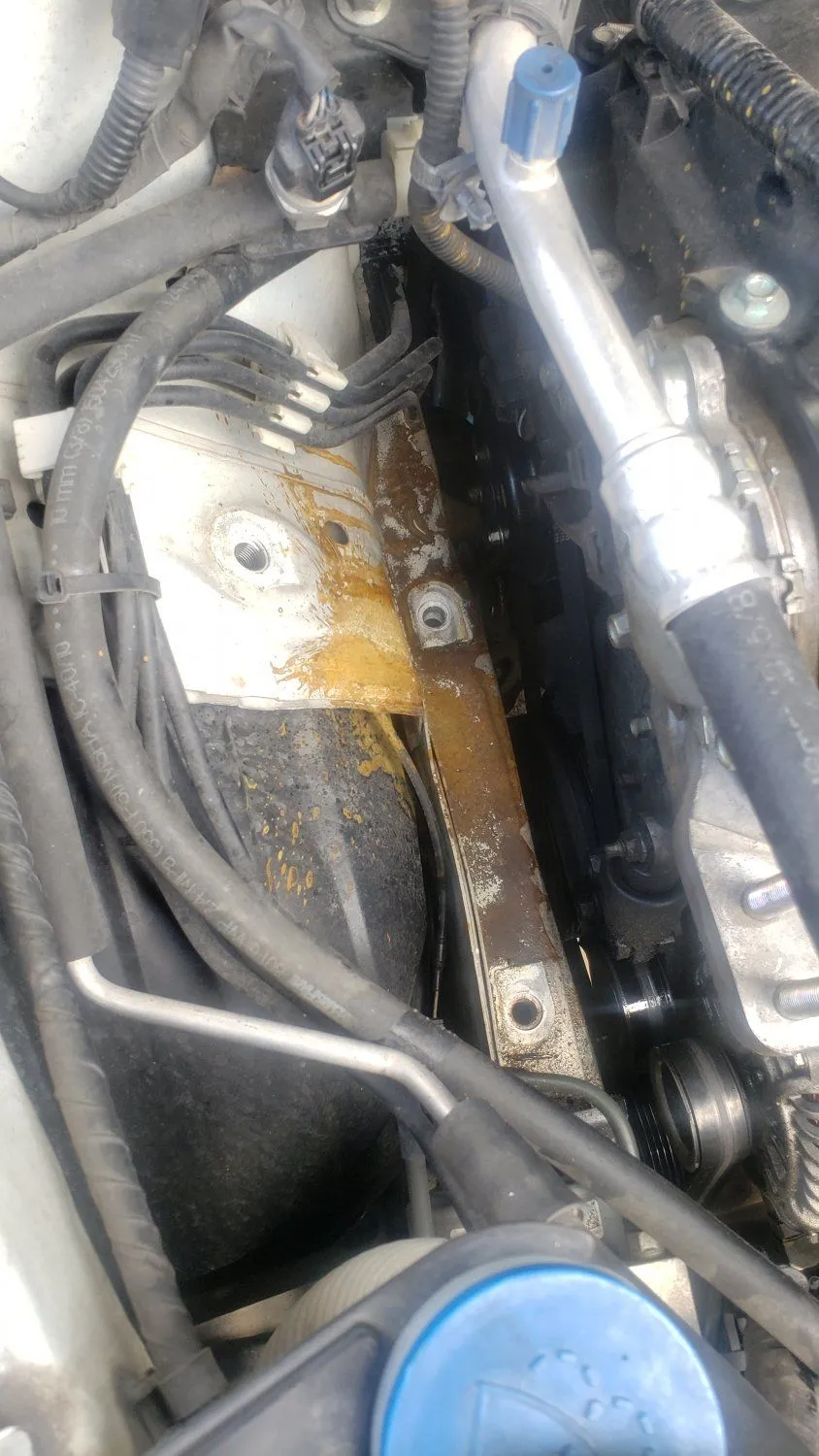

Come to find out Gen1's have a hydraulic engine mount because mine is leaking. Rip. I'm hoping a "cheap" aftermarket one is actually solid.
Interesting. Curious how the aftermarket one will be. I feel like the stock engine mounts are pretty good: not a lot of vibrations or movement from the engine.
I ordered a new one aftermarket for $50. I'm hoping they "cheaped out" and made it solid rubber. Either way, I'm likely going to cut a clean the old one and fill it with poly.

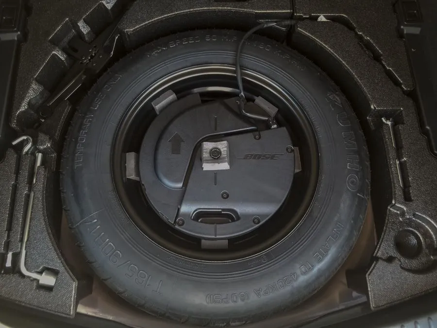

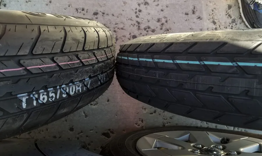

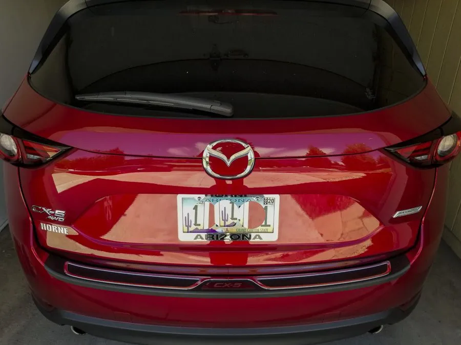

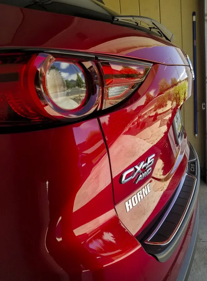

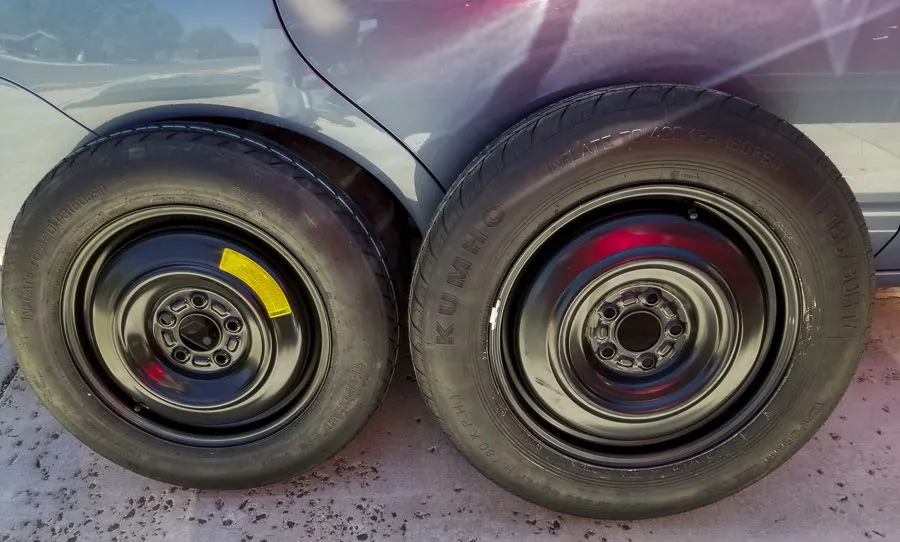

Installed a bumper guard and replaced the sad, sad, stock spare with a 165/90R17.
Bumper guard looks great.

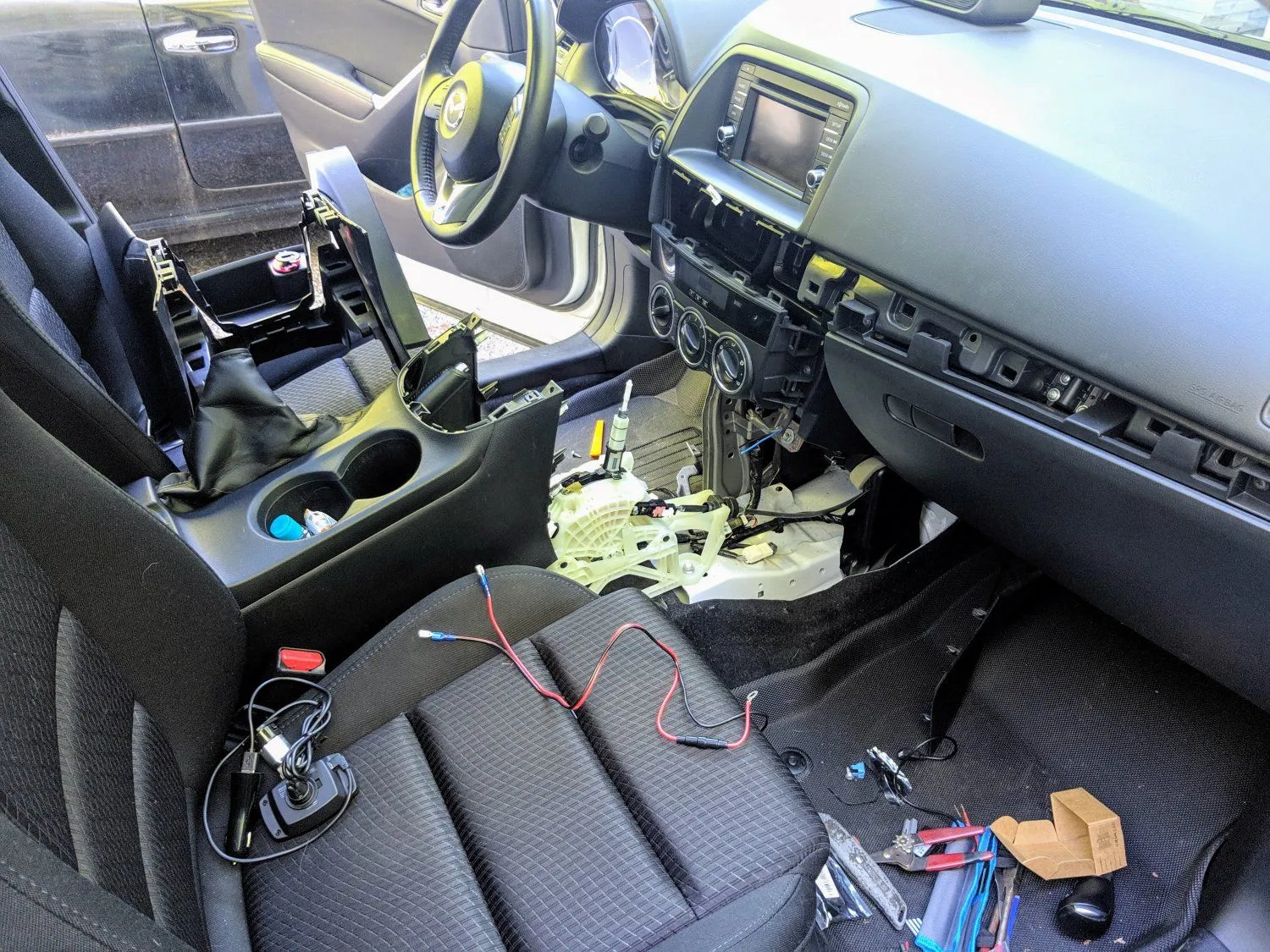

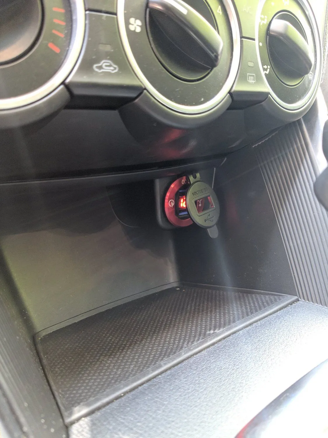

Hardwired my Scosche wireless charger/mount and added a USB adapter that supports quickcharge 3.0 and has a voltmeter:
Didn't realize I was going to have to remove the ENTIRE center console going into this. But it actually wasn't too bad to disassemble and reassemble, considering everything. Took me about two hours to complete.
And this helped:

Went back out today to install some of the cut-off foam from the deck cover around the subwoofer and under the too-long bolt until I get the bolt cut shorter. I snapped a pic of the installed tire this time. It would be nice to be able to get the 185/70R17 regular driving tire that's available in Mexico for the CX-5. There is definitely room for it.

Replaced the old engine mount which tore and leaked (184000mile). $50 new from ebay and less than 1 hr said and done. Going to try and fill and cage the old one with urethane.
You can do it within 1 hour for such job? Nice!
3 nuts and 3 bolts , 17mm in size. Dealer would probably charge $400 said and done. And likely convince customer to replace something else that is "worn out".
I changed leaking rear liquid engine mount on my VW before. The engine needs to be lifted a bit, and the space is very tight. It took me entire afternoon, and I was 20 years younger!
On the other hand, the front rubber engine mount on my 1998 Honda CR-V was so much easier to replace it.
Yea the rear motor mount is a tight fit, esp with AWD. When I put my poly on I had to jack the engine engine so much. It probably would have made more sense to undo the other mountts given the difficulty
I have just replaced the lower rear and it went easy. 2wd though. Man, my car shakes like crazy between 60-80. Even the gas pedal vibrates many times. This motor mount was so soft, that I could move the center metal bushing with my fingers.
Did you have any issues with the transmission mount? I haven't even seen it yet how it looks.
