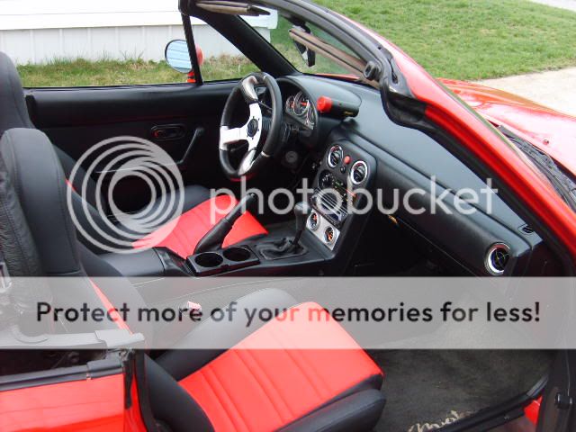

How about an interior shot? In this one, you can see the recovered seats, some bling, and my old floor mats. I use those for daily driving. A new set is used for shows.
