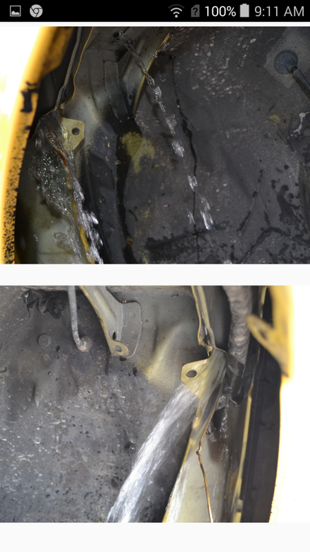

So I decided to test the roof rack since the previous owner took off the roof rack, but no luck. Tested the door if it was leaking, again no luck. But when I tested the wipercowl basing from the links above, long and behold it did leak. As I was observing the wiper cowl, it was only leaking when the water is kind of overflowing and going into where the outside air is coming inside the cabin. With that being said, I concentrated the water in full blast where the outside air is coming from and this happens:
Yup, its pretty bad. Also, I saw some rusts around where I was putting water into, I cant see it clearly becuase its on a tight spot and i cant even fit my hand to reach it, so I do not know the condition of that rust. Question is, (I know this is a stupid one, forgive me) can water really go where the outside air is coming from? Or theres some big ass hole around the vent? Thanks!

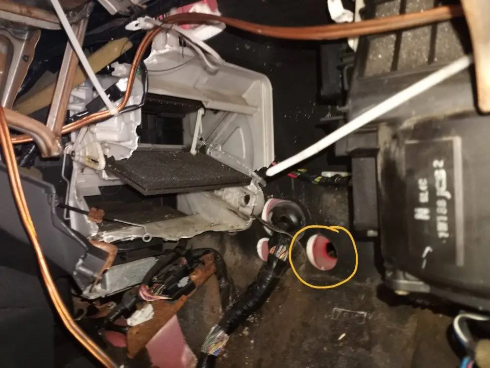

I went out to check my parts car to see what it looks like.
My brother-in-law wanted my heater core and AC condenser from my parts car for a project.
The FSM says to remove the entire dash to remove them, so we just butchered it out with a hammer, pry bar, saws-all, pliers and a grinder. Lol

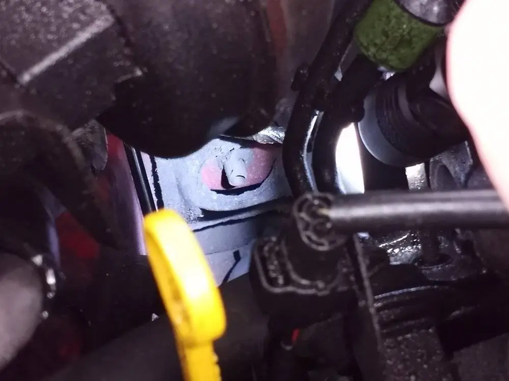

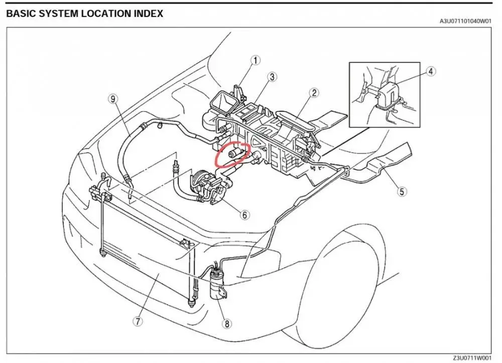

Here's what's left, but I don't remember about the drain.
I assume it is the hole in the middle that I circled.

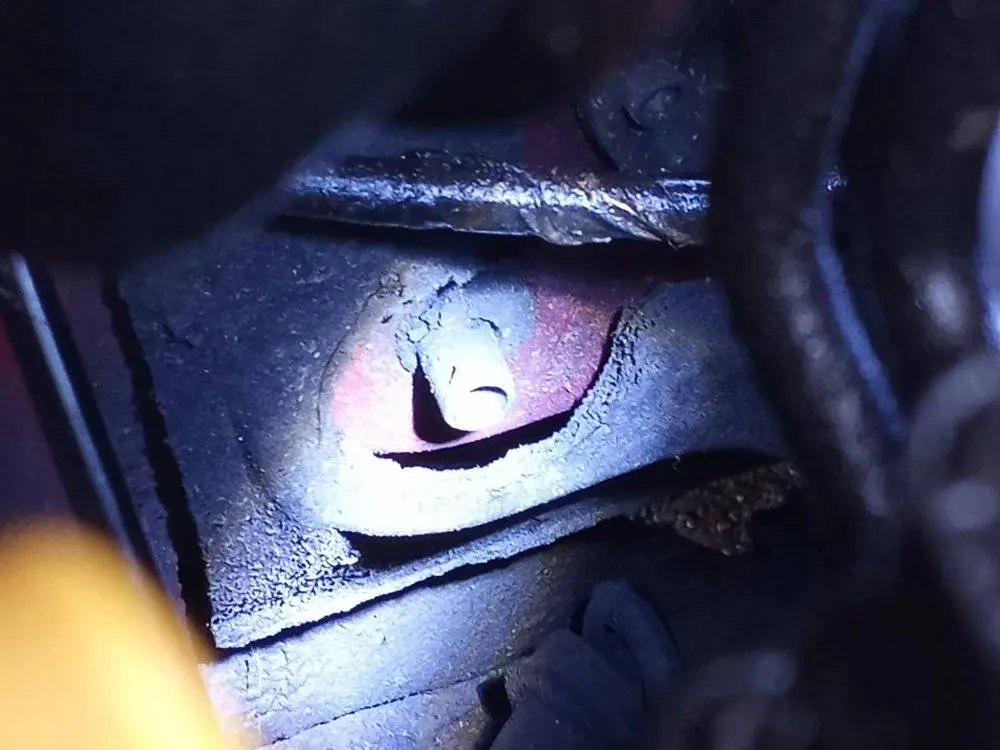

I checked my DD to see what's there and I figure this must be my drain.
I don't have that one way valve attachment on my drain port.
I don't know if it fell off, or was removed, or never came with one ?
The service manual does appear to show some sort of valve.

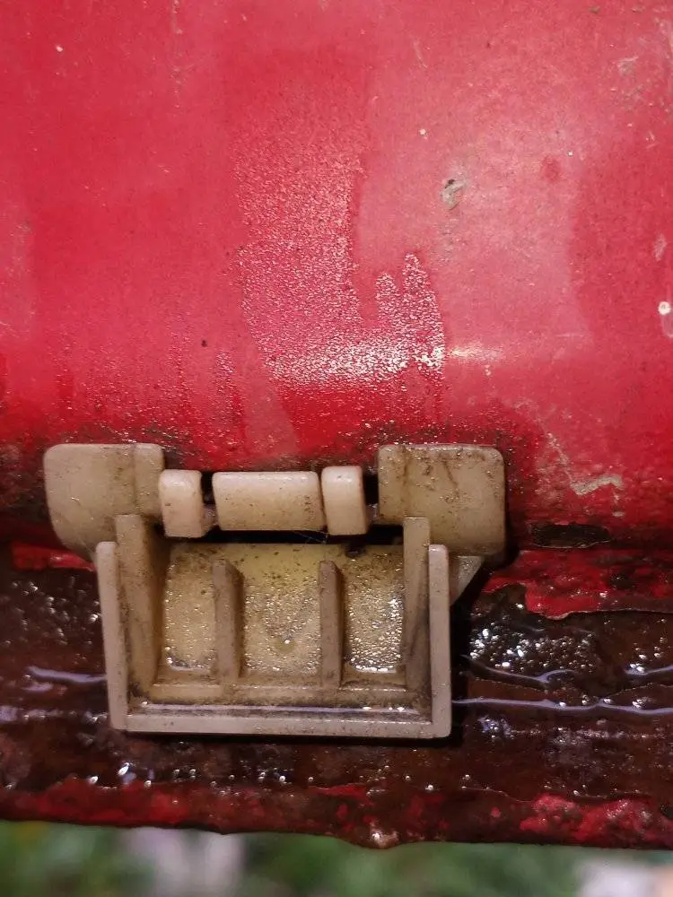

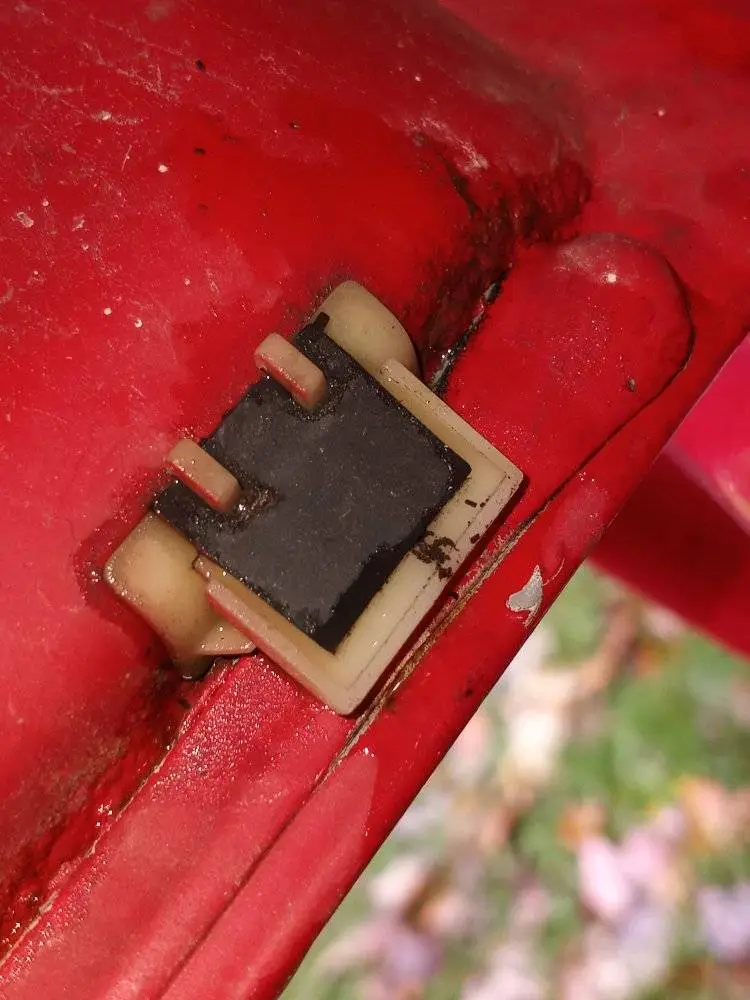

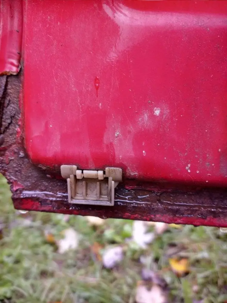

The bottom of the doors have similar one way valves for drainage, and they too can plug up with dirt then your door fills up with water.
I just removed mine.
They aren't necessary and the rectangular hole that is left is much less likely to plug up.
These are the valves on my parts car...
While investigating an issue with mine where water is dripping on the RF door speaker, I noticed the door held a lot of water, turns out my FR and RL doors have been replaced and repainted, they painted over the drains thus sealing the rubber to the plastic :ROFLMAO:. I am not new to clogged door drains so it was a first check when I saw the bad speaker. I need to set some $$ aside and order those window sweeps
