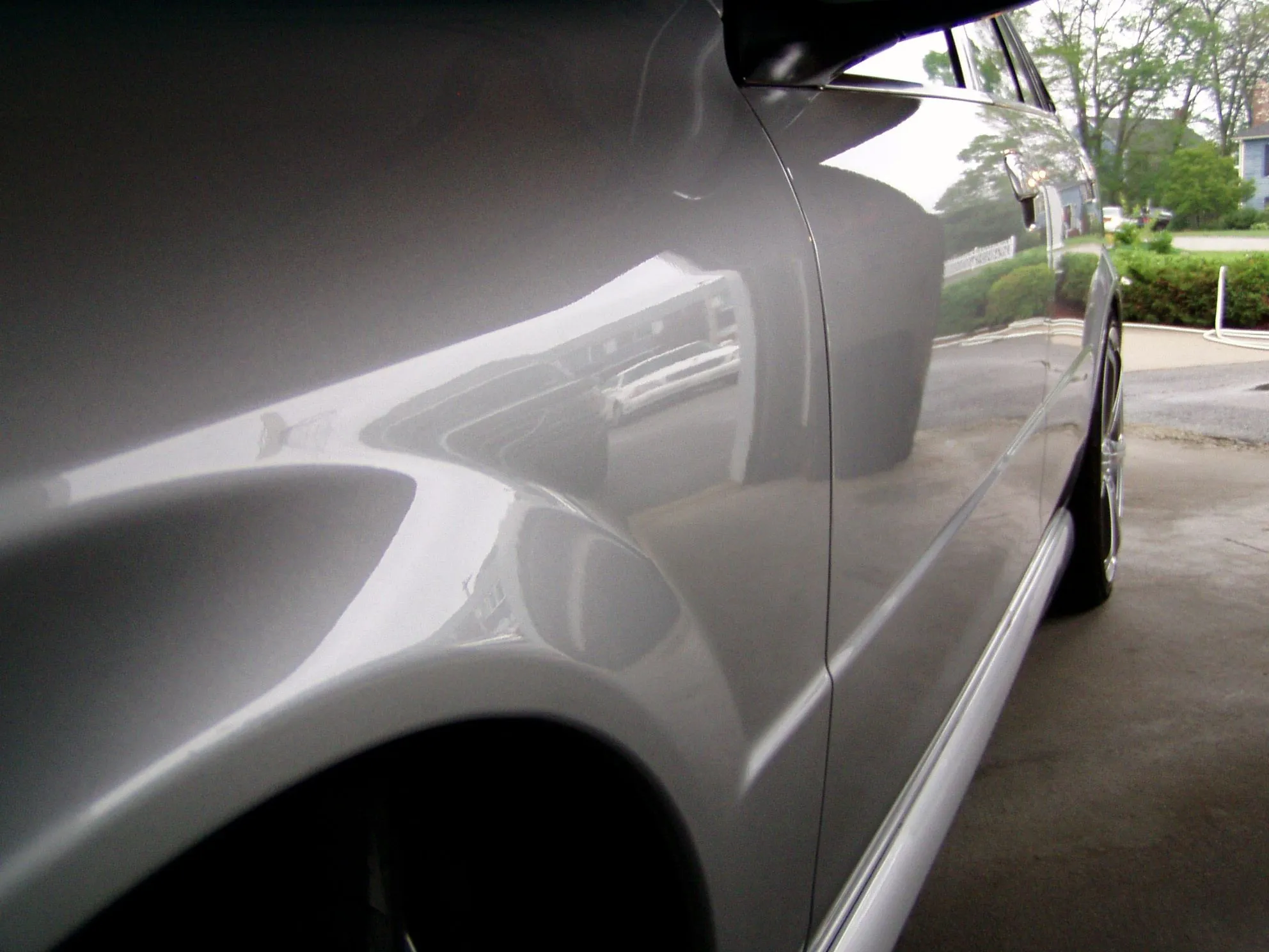

where's the pics?? ya, oleg is a mad russian detailer !! i helped him do my car earlier this summer, he's awesome!!

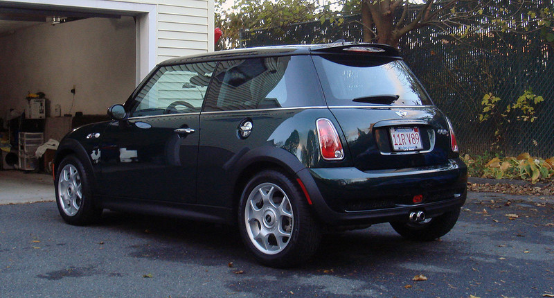

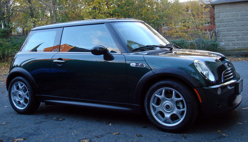

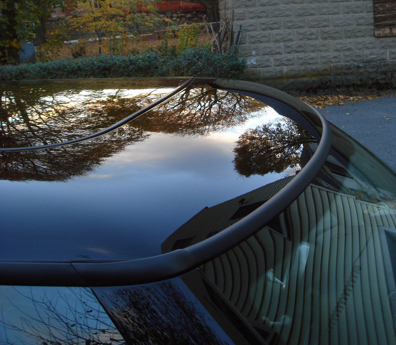

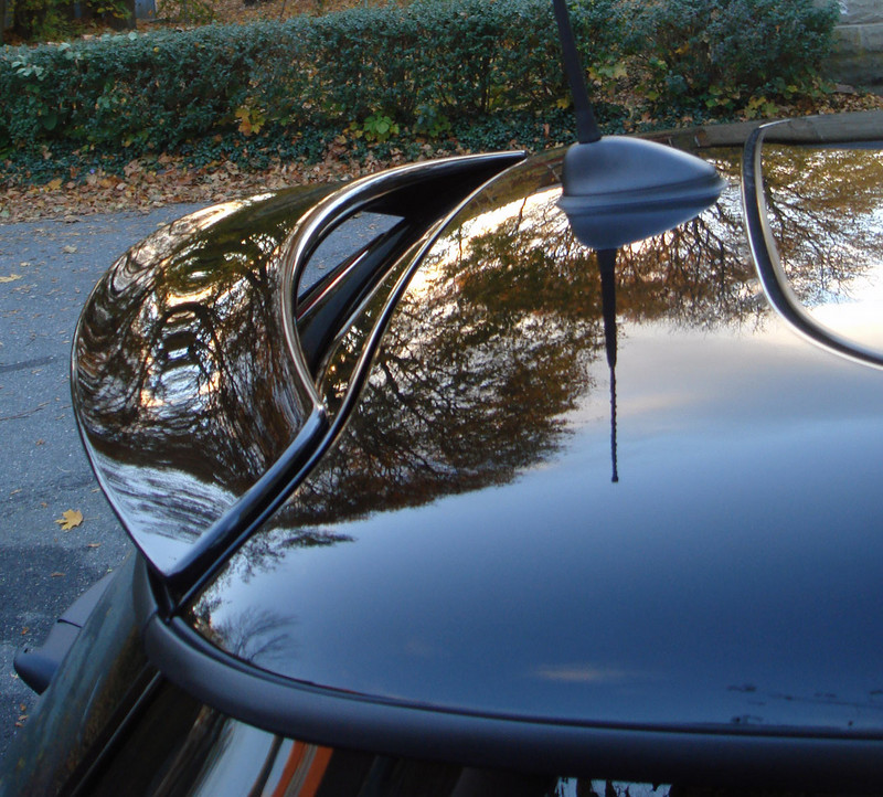

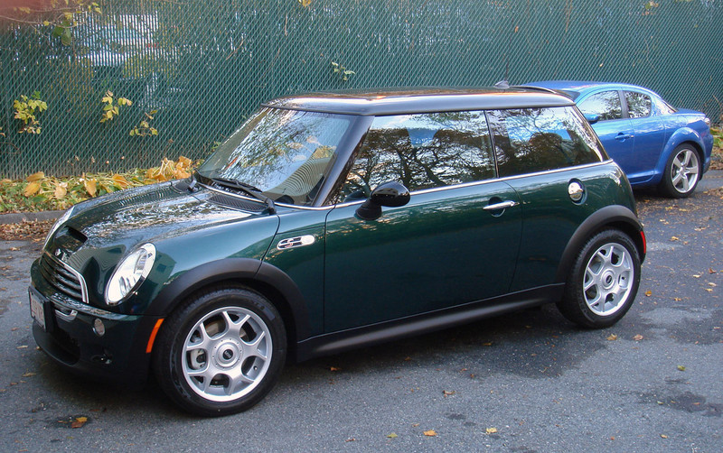

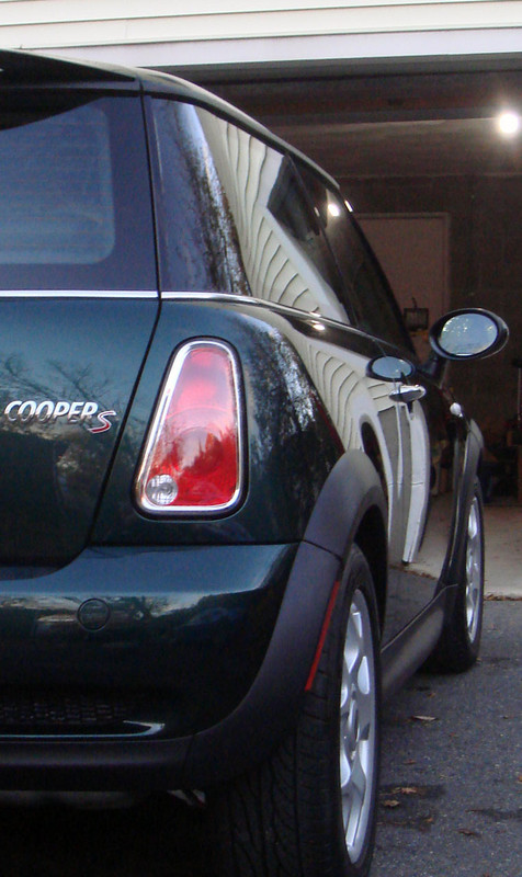

Hey Brian, no prob! You now have a car prepped for the winter :) I am going to post some pics now & I sent you the rest.
Edit: Too bad the sun was setting, it would've been nice to take full sun photos of the Zaino'd rims. They sure shined nice in the garage with the 1000W halogens! :)
So the process was:
* wash (with Zaino Z7 shampoo)
* clay a little glue residue off
* buff off some light dealer-installed scratches on the hood with Blackfire Scratch Resistant Clear Finishing Polish
* wipedown with Zaino Z6 beforehand
* wax paint with Meguiar's #21 wax (should last 4-6 months)
* wax wheels with Zaino Z2Pro x2 layers
* tires shined with Meg's Insane Shine, wiped on w/ a foam pad
* trim dressed with Poorboy's Trim Restorer
OK, here are the photos. Click each pic for full size.
Brian wiping off a missed spot:

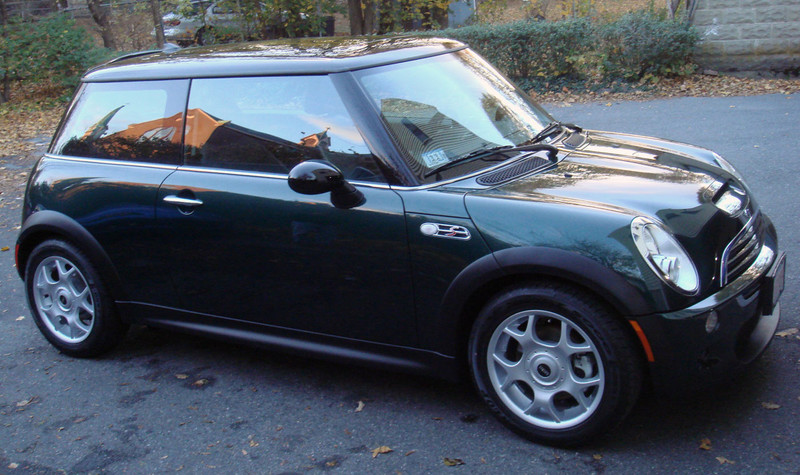

Now to check out some more reflections:
