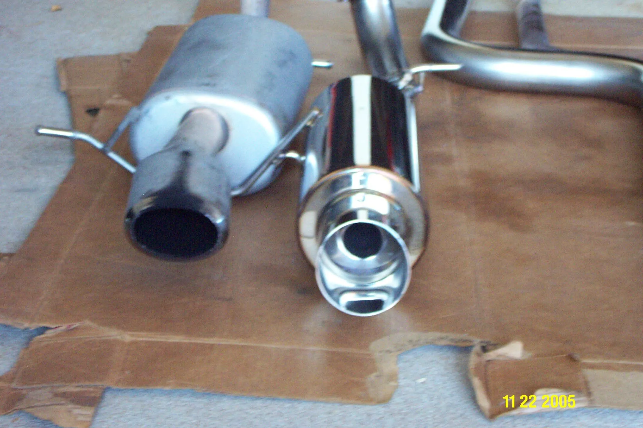

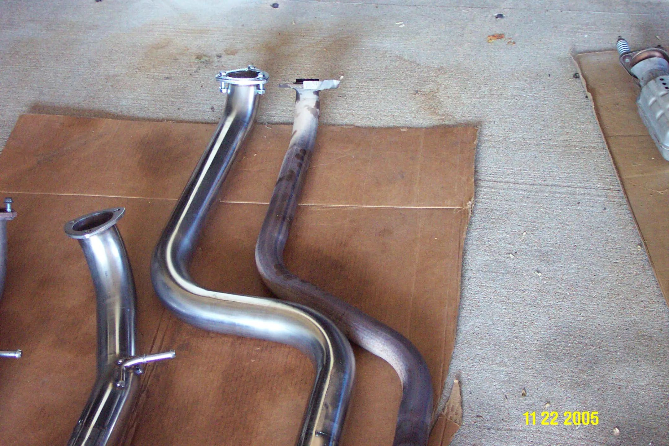

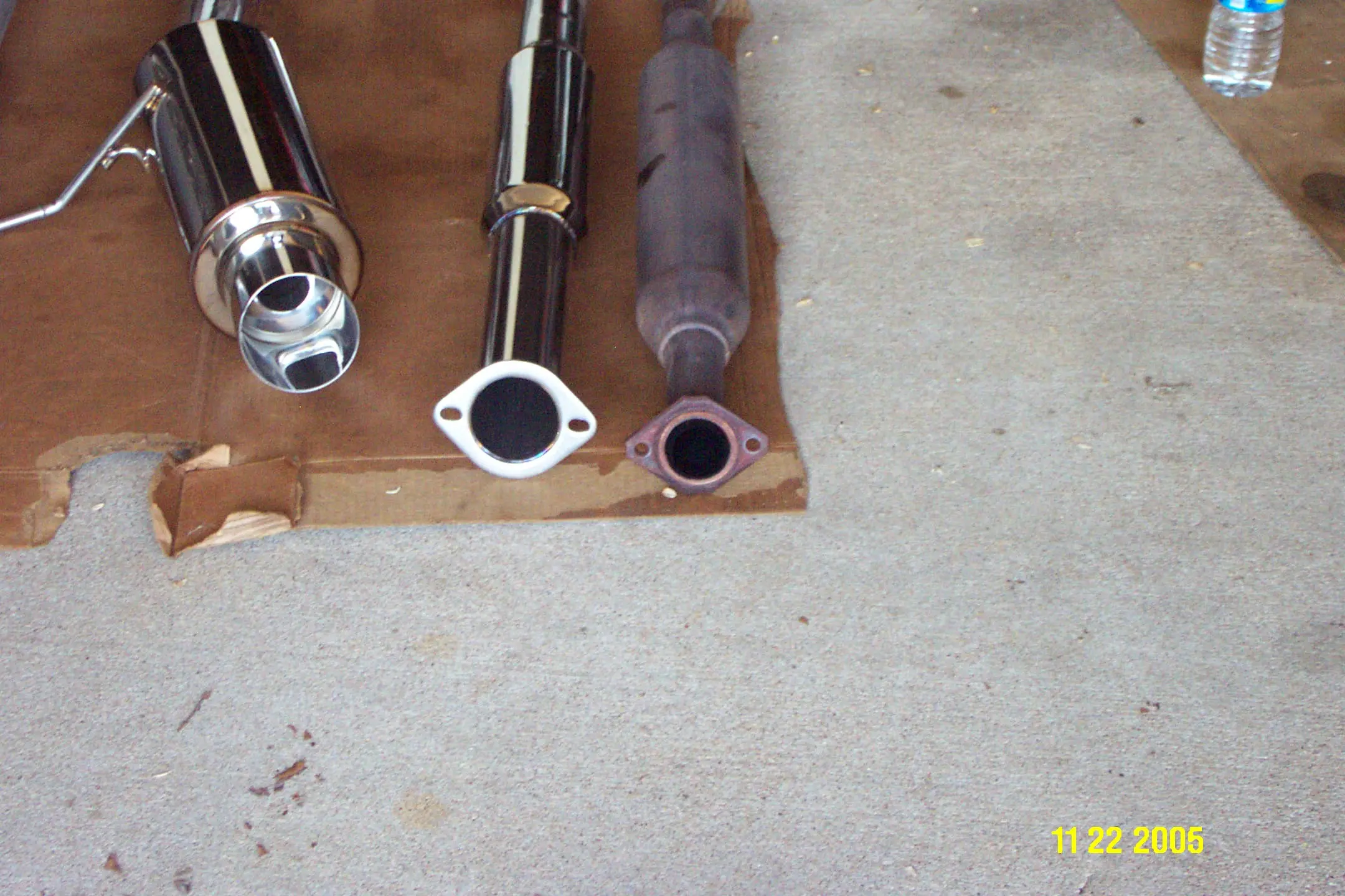

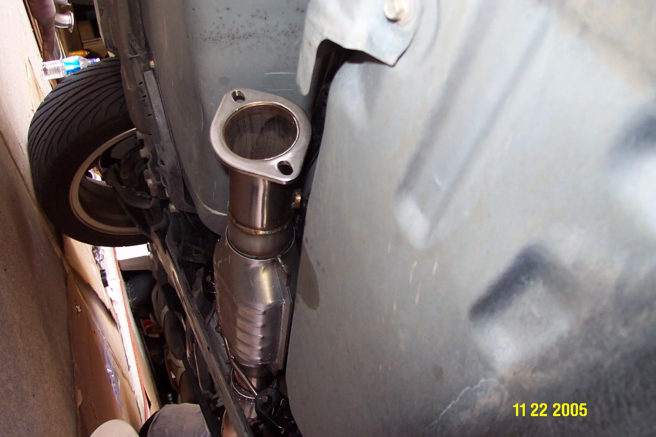

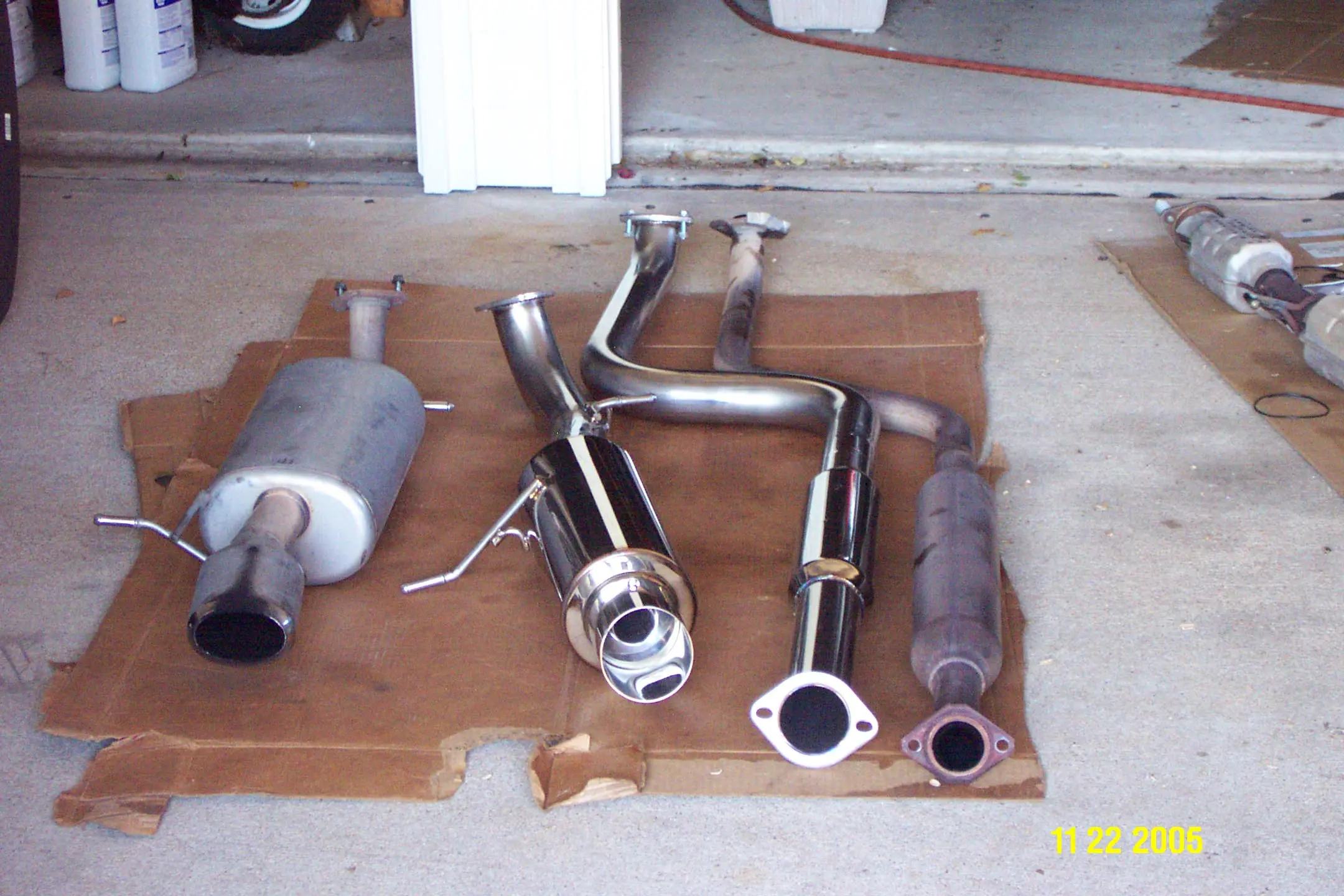

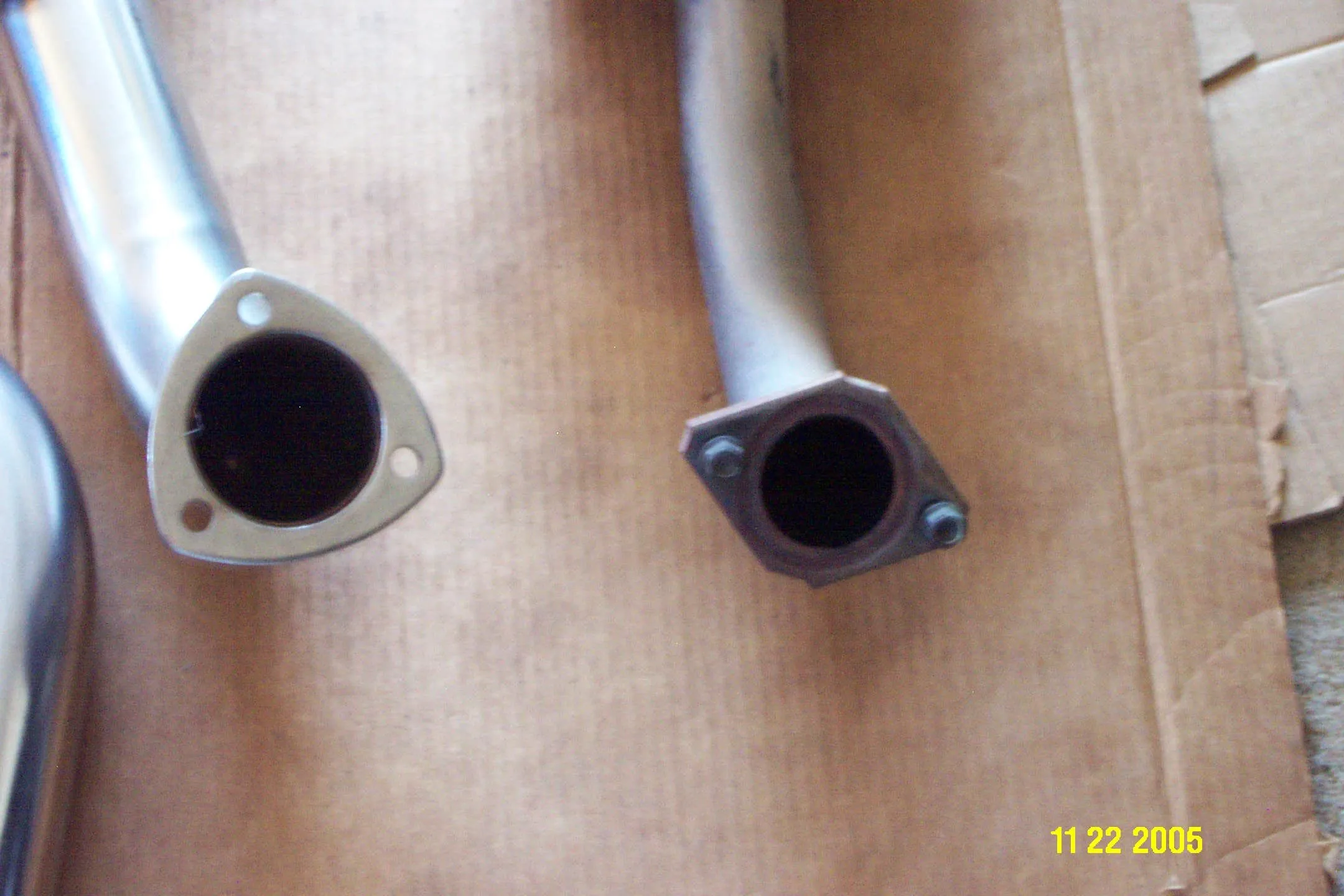

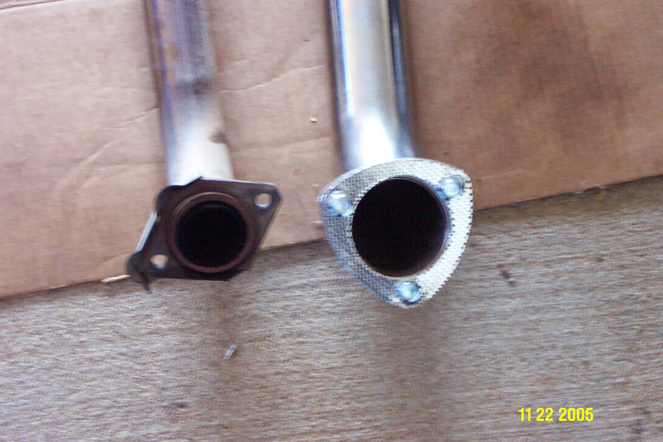

4 hours later, and the exhaust is installed. Well, kind of. All I have to say, is those KartBoy hangers are stiff as hell. It took me forever to get them on the new muffler. The j-pipe is only connected with one nut right now, because I have no way of grinding down the collars on the stock nuts and the nuts from Home Depot are too wide. I'll see if my co-worker has a grinder, otherwise I'll use my Dremel and it'll take a while. My mid-pipe gasket is a custom one from the gasket material from auto-zone, still waiting on the one that's supposed to come with it.

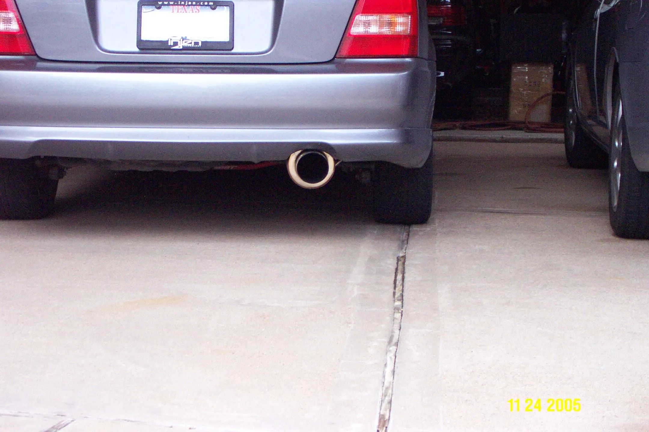

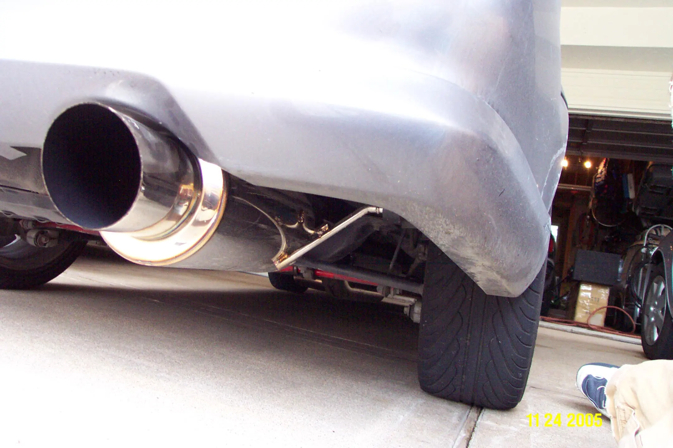

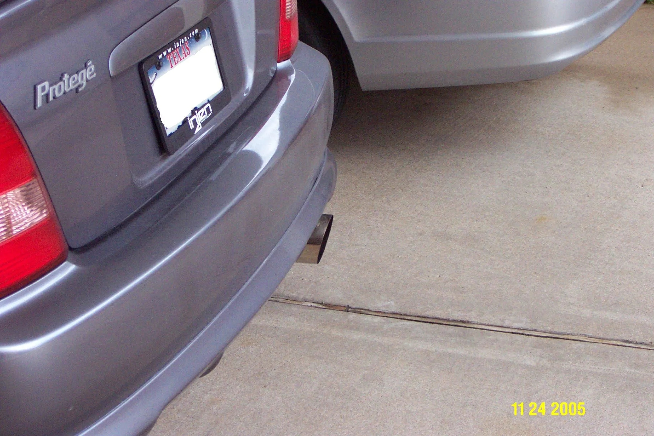

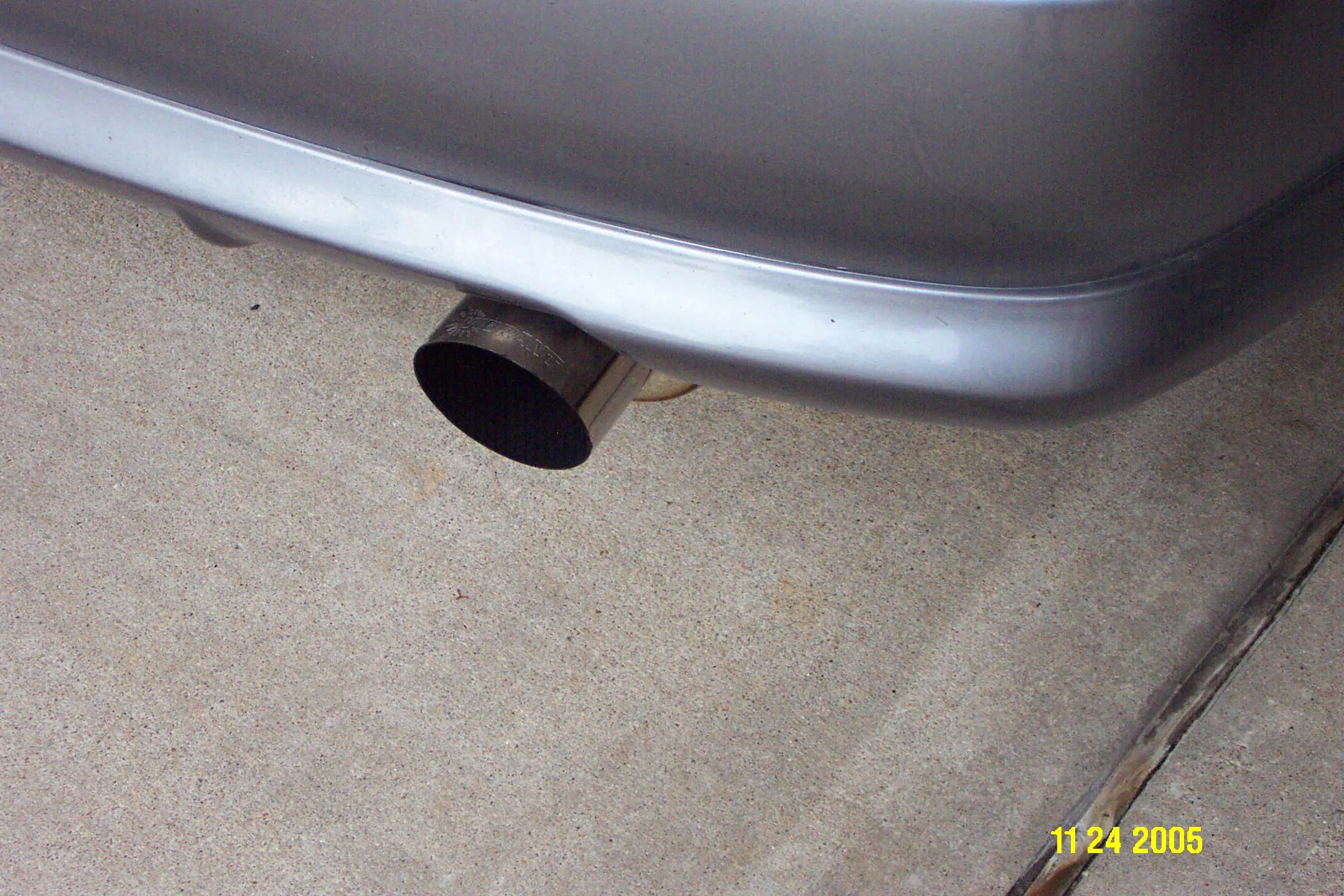

Otherwise, I'm very happy with the look. It's a bit close to the bumper, so some melting will occur, I'm not very concerned. It's about twice as loud as stock, just something I'll have to get used to. I think I'll use the silencer for daily driving and take it out on autocross/dyno/tuning days.
Dont worry no melting will occur.
You can also tru to use only the front KB bushings.
When I installed mine it did not like the way the where.
