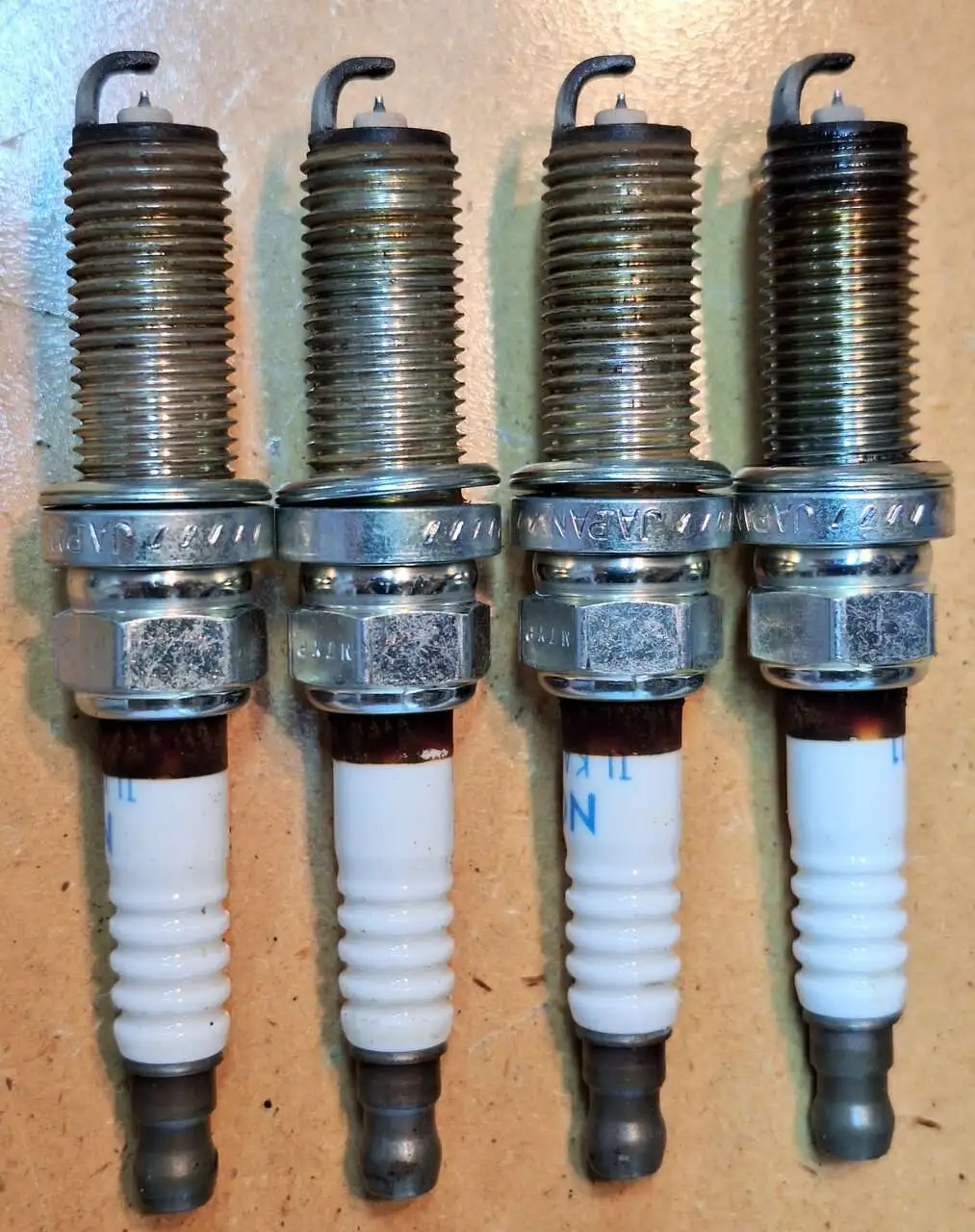

Installed them today. Pic is of the NGKs I took out with 74,715 miles on them. 30 minute job. Engine runs fine.
