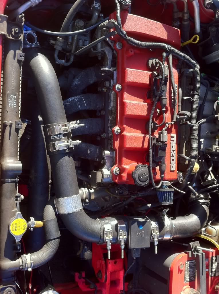

here you go.
Supercharger to Intercooler. (modified outlet pipe)
Intercooler ( this is mounted where the A/C condenser is)
IC to MAF (The bov is located right under the pipe after the blue coupler. from the maf goes to a 90* pipe to the throttle body)

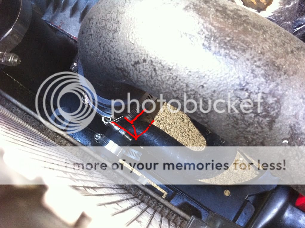

Here is a little problem that I ran into. (this can be solved by designing a different SC inlet) The lower coolant hose is kinda blocked by the SC inlet. (I had to notch it to make it fit.)
This is what it used to look like before the intercooler.
Thanks that helps. But where is your intake filter? And I need to understand how to mount the sc.
