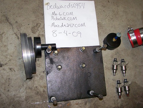

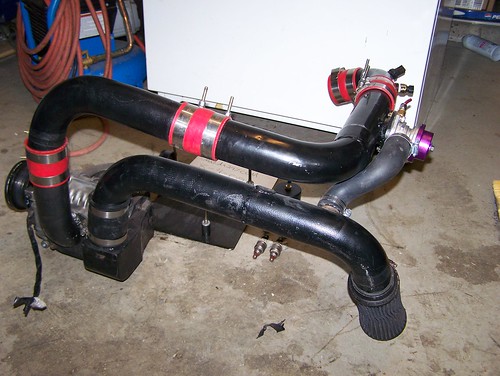

On the third to the last picture you can see the SC and the mounting plate.
As for the intake filter it is in the last picture under the pipe leading to the MAF.
so how did you make that mounting plate? Do you have a picture of it before installation? What did it hook up to.
It bolts up directly to the OEM AC mounting points.
(without the idle pulley)
What it looks like hooked up out of the car.

Supercharger: Just look at the pics above this post !!

http://i153.photobucket.com/albums/s204/kirk95gs/DSCN0048.jpg
Really the only way would be doing a shafted setup. This would mean putting the SC on the right side of the engine bay, welding brackets somewhat flush to the belts, have a shaft that goes across then have a pulley on that. That pulley would be flush with the belt line. To me that's too much work, too much clutter.
You should be able to google "shafted supercharger" and get an idea.
