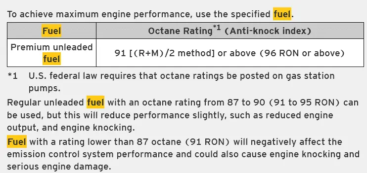

Snippet from 2020 MX-5 manual:
AVC is correct. As he said, the curve published is fact, but it is only a curve for Wide Open throttle under specific conditions. It is possible that the engine reacts differently under partial throttle when using 93 octane instead of 87. As he mentioned some cars do that specifically. That specific engine behaviour is what sometimes lead to claim of higher fuel efficiency when using premium fuel. It can when the engine can adapt and use the higher octane fuel to its advantage, but it isn't a rule for all engine. To the users there are not a lot of advantages to this, if the engine develops more torque at partial throttle with 93, then the driver usually adjust and give less throttle to match the acceleration they intended.
