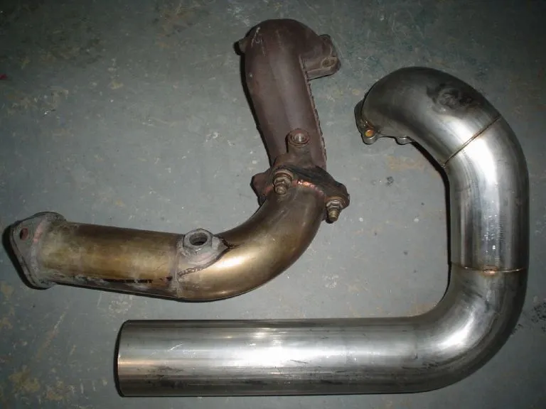

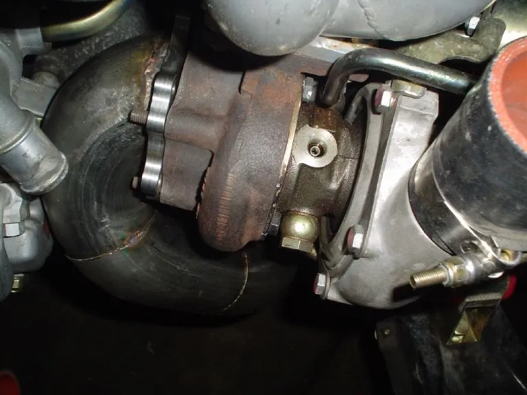

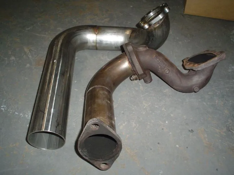

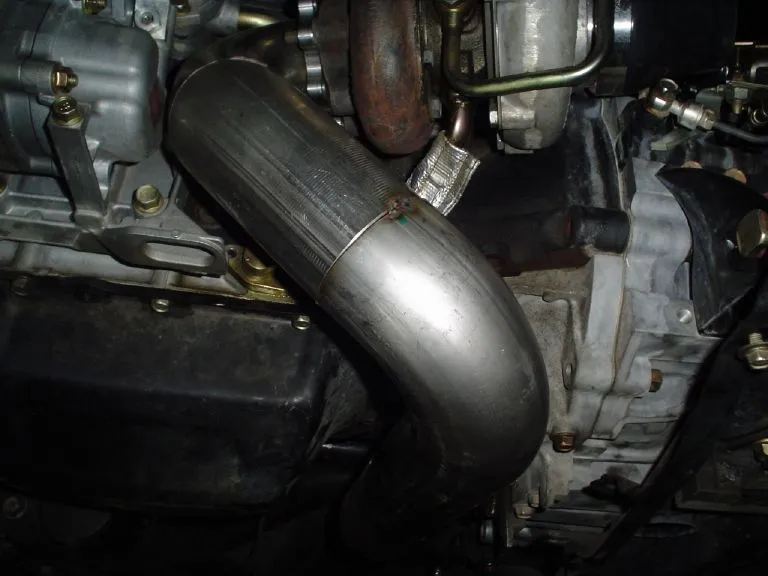

The upload files seems to be down, or the network that I am tapping in to down at the shop is blocking me from uploading for some reason. Here is a try at attaching them...

It worked.:) So I am off to go get the flanges so we can finish this badboy up... probably gonna be another late night here.

I always thought that last bend on a 3" pipe was quite a feat (hense why there are few 3" DPs).... but it looks like a long pipe was mandrel bent about 45deg then cut just outside of the bend... I am guessing I am wrong but that is what it looks like. Pipe bends are expensive, but those bends do not look as elaborate as... say, the Corksport S-pipe. Not doggin MAM at all, just wondering what the huge issue is with fabricating these parts.
fat pipes... haha... looks good. i would love to see a dyno of that on somebody's stock car.
first of all, nice looking piece.
What benefits are there to a snigle 3" compared to the split pipes of a GHL?
I've seen each of those bends go on ebay in polished ss for 35-55 a piece. Times the 3 bends say 150 and the footprint for the turbo costs ______? Then of course the mock-up time, which only needs be done once, and then welding.
Like I said it looks nice, but I don't understand your figures. any elaboration would be appreciated.
looks nice and made very well.
didnt somebody get one of those ebay dsm T25 3" downpipes for like $80 and mod the AC so it fit?
I am sorry...but i know how much piping and flanges cost and even to have flanges laser cut...and that is NOT anywhere near a pipe that is worth any more than $500....at that price it would be highway robbery...I know the intial fab time is what hurts the most but after it is made and a jig is made...that would be a relatively easy piece to make now that I see it.If that is made from steel as well...It shouldn't be that high...hell only stainless would raise the price signifigantly and even then $500 would be a stretch...Just my oipinion...definately NOT A FLAME....
Jeez guys... I said IF Beau made this piece it would be that high... and judging by everyone's comments in this thread, I won't be surprised at all if he just says screw it and doesn't even make a jig after he reads this thread. Cost of SS is very high... those bends cost more than 65 dollars A PIECE!!! 3 bend sections, a flex section, CNC cut T-2 series flange, 2 3 bolt CNC cut flanges (or a V-band)... DO THE MATH. Even if a jig was made it would still take several hours to make one properly with the SUPER tight clearances. Ovaling out the pipe so it fits in the flange also takes quite a bit of time, as does beating down the backside properly so the pipe can clear the A/C compressor (not to mention that he does it so the metal doesn't get stretched and weakened).
