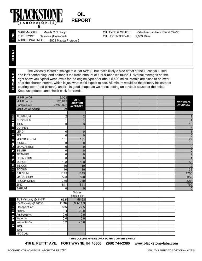

I got the oil analysis report back from Blackstone today. Here it is.
I'm somewhat relieved, but still kind of confused.
This seems to indicate that there isn't major internal engine damage, so I don't need to be too concerned about doing more damage by driving it. But I'm still wondering what the sound actually is. It's definitely still there, but at this point it must be either timing related, accessory related, or something in the head.

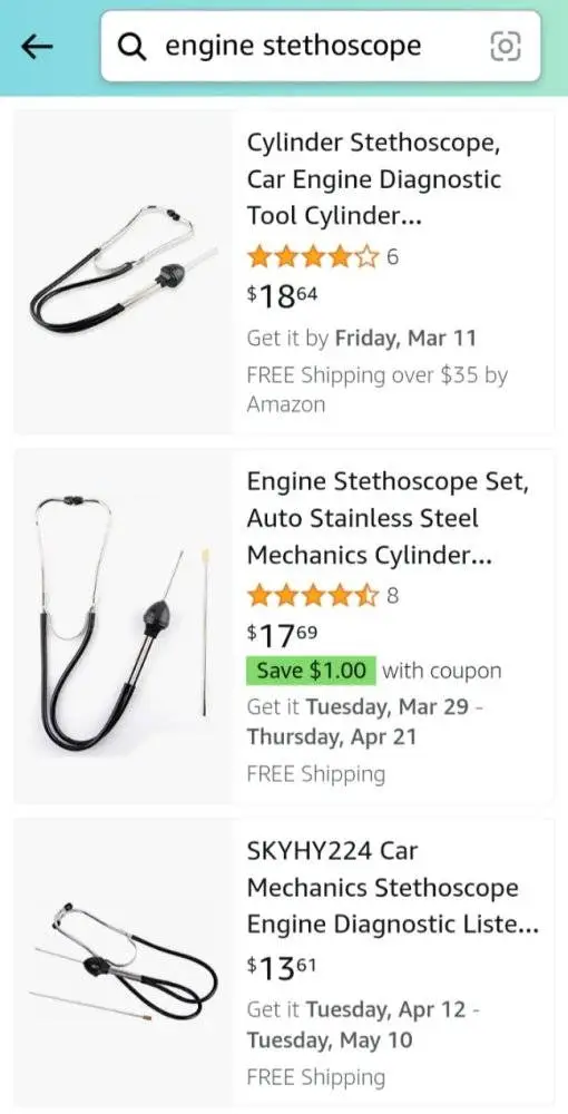

I wonder if anybody has tried one of the $5 - $7 stethoscopes sold on eBay or Amazon?
Yes!!
I have!!
Super cheap and easy!!

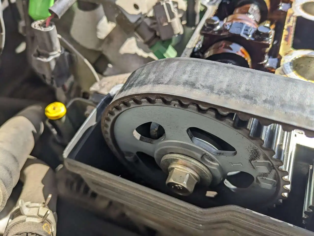

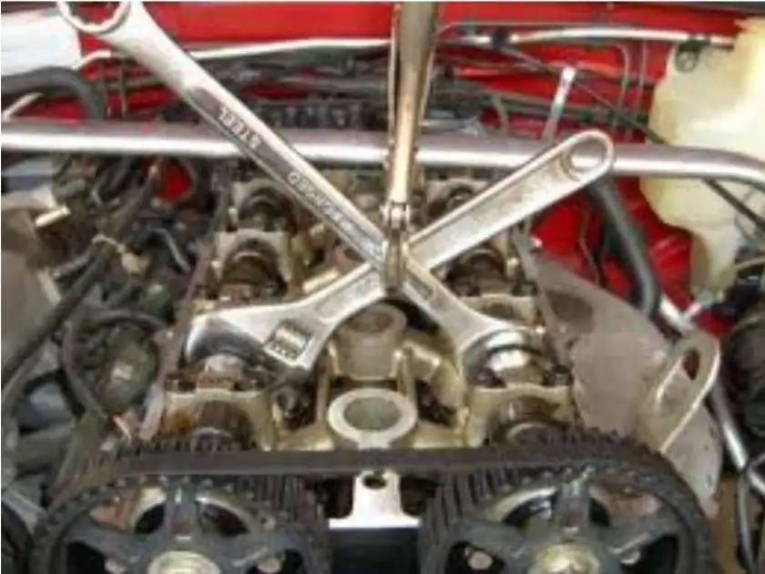

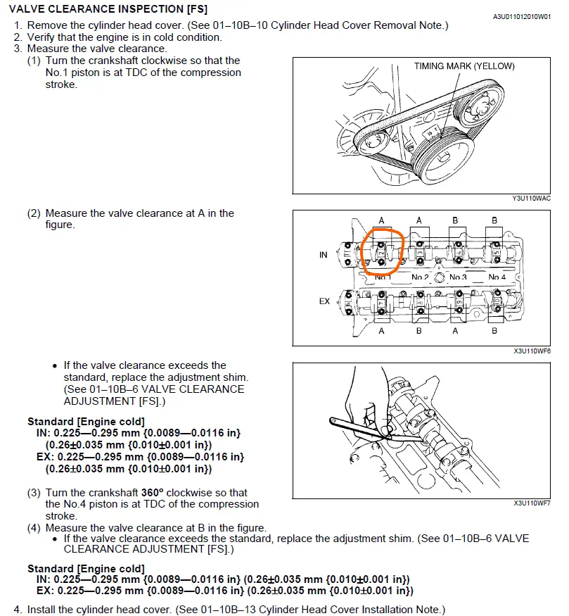

I pulled the valve cover to check valve clearance and the condition of the timing belt. I've never checked valve clearances or done a timing belt so this was a bit new to me. All valves seemed within spec (0.225-0.295mm cold) except for the #2 marked cap on the top left which would only fit a 0.179mm gauge at most with cyl #1 at TDC of compression stroke. This doesn't seem too concerning to me, though I would have expected it to have more slop rather than less.
There is a chance that my method for reaching TDC was not super accurate. I couldn't see the mark on the harmonic balancer easily so I just stuck a rod into the spark plug hole and turned the engine by hand until the rod stopped moving and stopped just before it started going downwards.

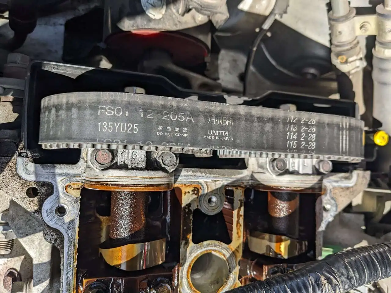

What intrigues me more is the condition of the timing belt. From the markings it seems to be a genuine OEM belt and it's definitely not new. For reference, 171k miles and no record of a timing belt job. I don't have enough experience to know whether this belt is original or not. It has printing and some lines on it but they are fading and there are small cracks on the side of the belt.
The thing that concerns me is the slop in the belt between the cam gears. I took a video of me pressing on it which I can attach if I can figure out a good way to do it. Does anyone know what is generally considered acceptable for timing belt "slop" or "give" between the gears? There is enough slop that I can slide the belt back and forth across the teeth.
I've attached some photos of the belt, but it's hard to see the details of it's condition.
I knew I would need to do a timing job eventually. If it was replaced around 100k miles, it could presumably be about time for a new one, but I'm a lot less concerned about ~71k miles on it than 171k miles. What do you guys think, based on the photos? Is there any way to know other than to disassemble further?
I don't know how exactly this plays into my sound, but I can imagine that if the belt is original, so are all of the tensioners and the water pump and who knows what else.
I think it's entirely possible that your T-belt has never been changed.
A lot of people have no idea about the timing belt and many just sell their car when it's time to change the belt because they don't want to spend the money to replace it.
The slop on the gears is kinda normal, but your belt may be stretched as well.
The cams are kinda spring-loaded and want to sit at a spot that doesn't have the timing completely lined up.
The only pressure pulling the belt tight on the left is the pressure from the little spring on the Tensioner pulley and the pressure of the valve springs is much greater.
That's why you have to do this when you change your Timing-Belt.
The cams won't stay in alignment with the belt off.
One guy had a special cam tool to hold the cams still but it was made of plastic and there was enough pressure from the valve springs to bend the plastic tool.
If your Timing-Belt is stretched along with worn teeth, your valve timing may be lagging behind.
Your ignition timing should be OK though because the cam sensor let's the ECU know exactly where the cams are.
