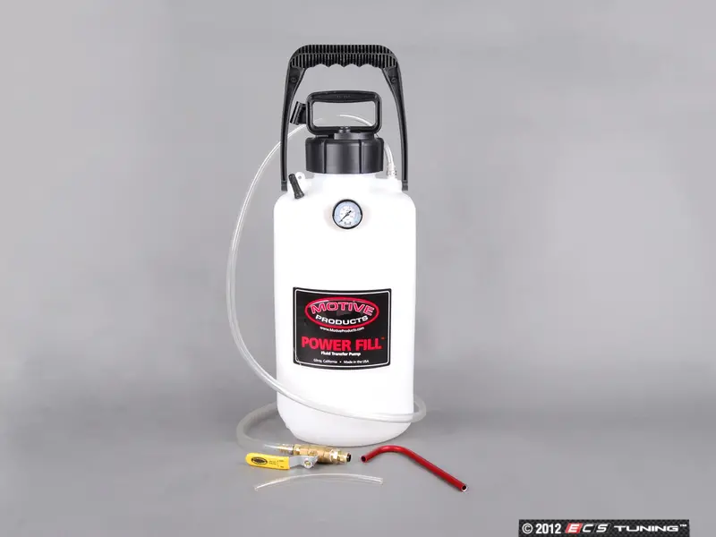

I have on order one of these Motive tanks that should make refill a lot quicker.
It is spendy but I plan to give it significant use over the years.
https://www.summitracing.com/parts/mvp-1745

* I'm gonna refill from the bottom with my Motive Powerfill.

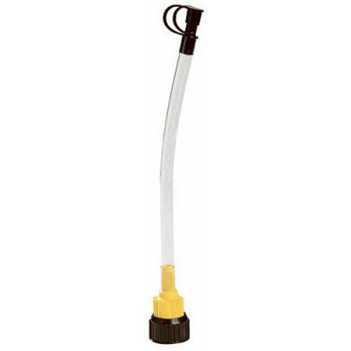

I found that this worked perfectly for the fill part of the procedure (I didn't have a long funnel), and it's an exact fit for the Mazda ATF quart bottles. WalMart and AutoZone carry it too.

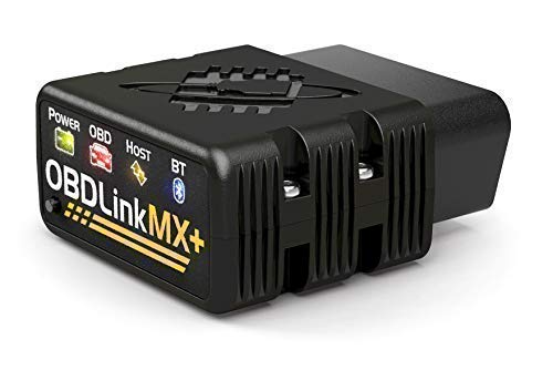

To get a precise read of the ATF temp, and with the kind assistance of Kedis82ZE8 in another thread, I used this. *** WARNING *** It's way too easy to get addicted to setting up dashboards to monitor every facet of the car's performance! (evil)
http://www.obdlink.com/mxp/

Yes I have this filler tube from WalMart and use it for filling the rear differential on my Honda CR-V.
It seems you guys like this OBDII reader, I may need to get one for the future ATF change.
