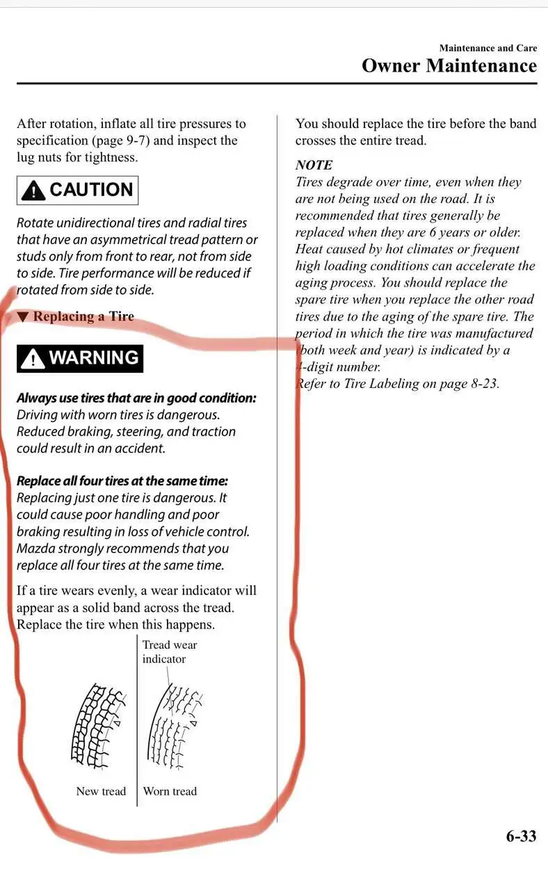

Since you mentioned “rusted frames”, most likely your experience won’t be the newer CUVs which has more sophisticated traction control system and “automatic” AWD. Even thought the CX-5 has open differential at front and rear, but it does have a clutch pack controls the power to the rear. If the overall rotation speeds are different between front and rear, the clutch may be activated by the TCS, and certain wheels which rotate a bit too fast (slippery situation) may have brake applied by the TCS too. Although these actions can be very minimum with minor circumference difference on a single new tire, but nevertheless these are unnecessary actions if all 4 tires are in the same circumference. Yes, it should be a long term effect on unnecessary wear, but the control issue could get affect more as mentioned in CX-5’s owner’s manual.

Mazda’s owner’s manual says that too, although it’s for different reason.
