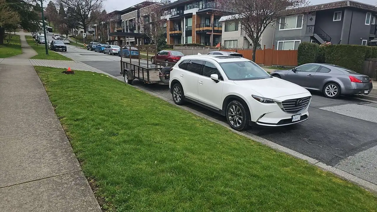

@Agape_365 tows with their CX-9 quite often. Here is one instance where the CX-9 was loaded with 1900lbs in the trunk, which is 500lbs over the recommended payload capacity.
I also have a CX-9. I've never towed anything, but I did load up with about 1200lbs of cargo and drove the car 12 hours for a move to another province. The car handled the extra weight very well.
And here's a thread with more information on towing with a 2nd gen CX-9.
Don't have any other trailer pics on my phone currently but search my username I am sure some will pop up.
This trailer is 800 lbs empty, on average I have between 8 and 1200 lbs in it.
Main drive is the coquillaha, look up the tv show hwy thru hell for an idea of what thats like. (So awesone it has its own tv show about wrecks).
