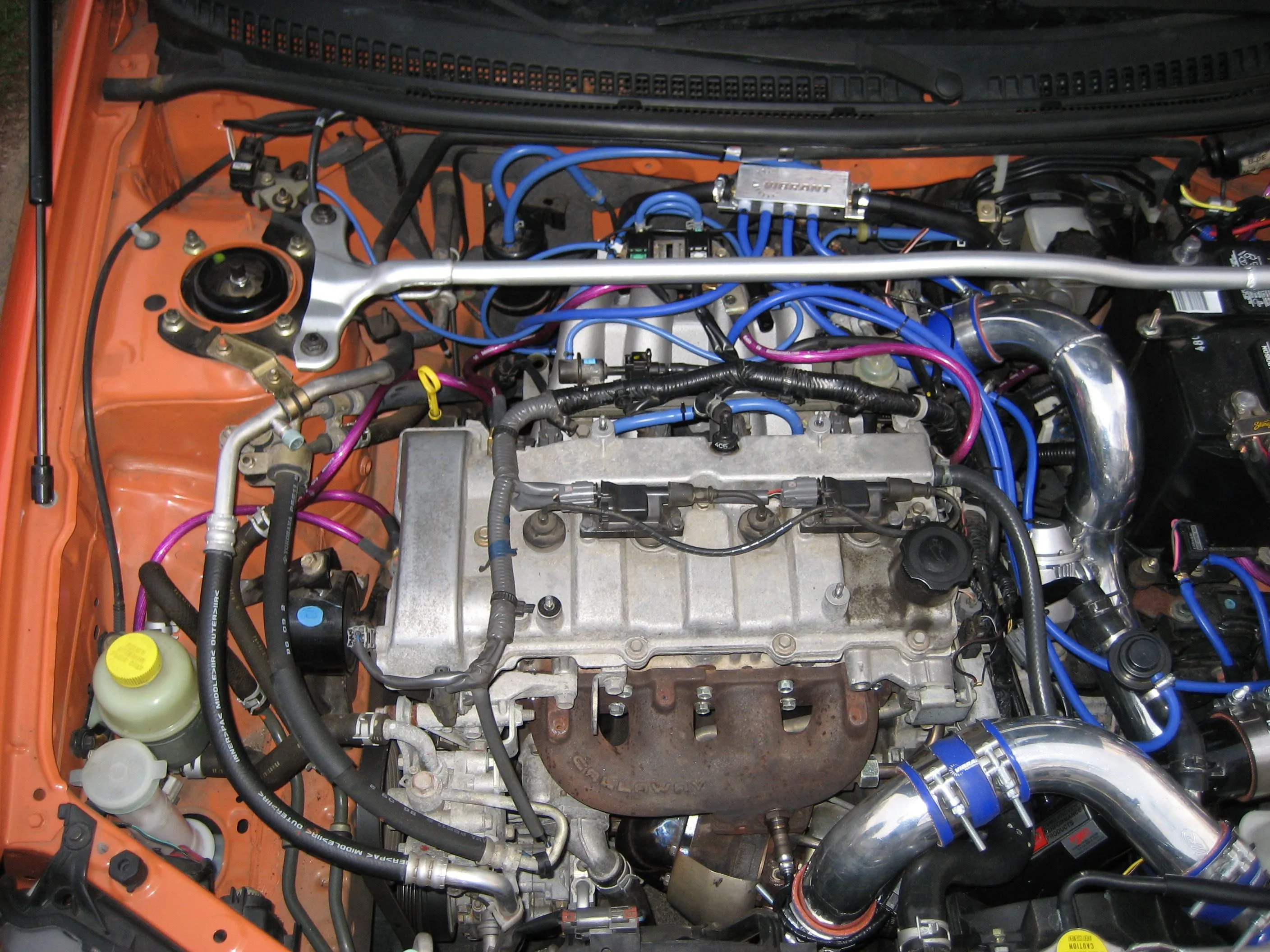

well got it installed today, took allll damn day(I went kinda slow and made sure I got everything done correctly,got it running well first shot), got a nice sunburn on my back, but it was worth it, sounds great now, and replaced all the vac lines with some nice blue ones,

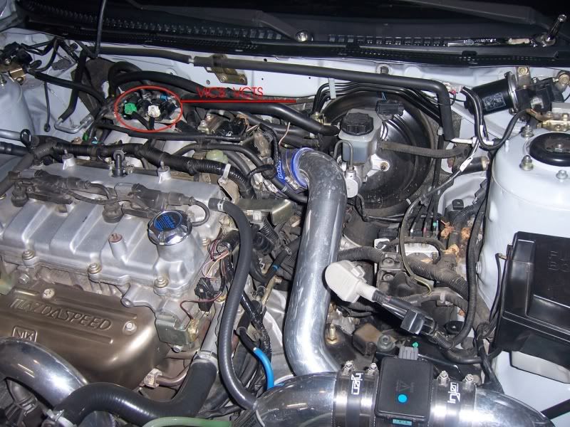

Actually that is possible, but when I saw ken at OCC he mentioned that I had connected them correctly so I will assume when they said to route them to each other it means exactly that, which would be to run a vac line to the other side, so that they see the same pressure, I guess capping them would work too, but I just feel better about my way.. here is a pic
