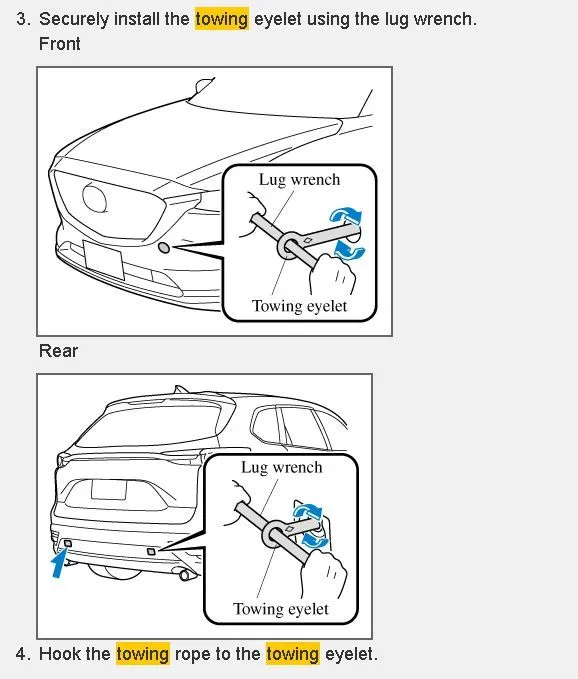

Our new 2018 cx-5 gt is missing the 2 rear and 1 front tie down eyelets from the spare tire area. Dealer says they have not seen any come with them. Anyone from the USA purchase recently have these hooks?

No, Mazda longer provides them since MY 2016 on CX-5. You can always order them from Mazda dealers, at about $20+ each.
BTW, theres only one rear tie-down eyelet provided for pre-2016 MYs, not two.
Eyelets? You mean the shipping hooks? Those aren't tie downs. They use them to ship the cars here. They remove them because that is the only purpose they serve.
They actually exist on the inside where the yellow arrows are pointing to:
The manual shows them on page 7-3 and 7-23 for emergency towing. I presume there for the flatbeds to strap to if they don't have tire straps
I went through this with my 2018 CX-9. After dealing with Mazda directly, they informed me that all 2014+ Mazda vehicles are not sold with the towing eyelets or the shipping eyelets. Shipping eyelets I understand, but not including the tow hook for recovery purposes is stupid, IMO.
https://www.mazdas247.com/forum/showthread.php?123865561-Missing-towing-eyelet
Part number is KD53-50-EJ1B (can be used for the front or rear on the 2014+ CX-5). Cost me about $23 USD from a local dealer.

No, they are for emergency towing. Straight out of the Owner's Manual, in the section titled Emergency Towing:
"The towing eyelet should be used in an emergency (to get the vehicle out of a ditch or a snow bank, for example).
When using the towing eyelets, always pull the cable or chain in a straight direction with respect to the eyelet. Never apply a sideways force."
attachment.php
The equipment that is used to tie the vehicle down on the ship deck is different from the towing eyelet that you can purchase from the dealer (shown in the picture). The tie downs and the towing eyelets use the same attachment points (one on the front and two on the rear), but the tie downs are not suitable for towing (which is why Mazda no longer leaves them in the vehicle).
