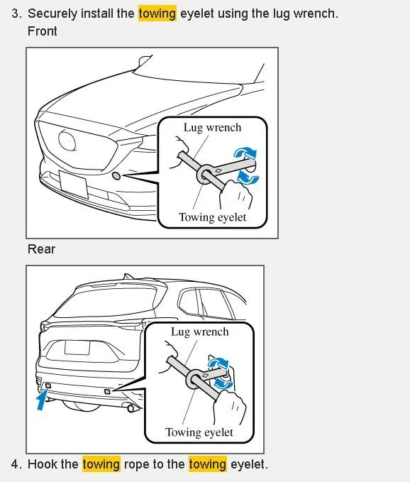

No, they are for emergency towing. Straight out of the Owner's Manual, in the section titled Emergency Towing:
"The towing eyelet should be used in an emergency (to get the vehicle out of a ditch or a snow bank, for example).
When using the towing eyelets, always pull the cable or chain in a straight direction with respect to the eyelet. Never apply a sideways force."
attachment.php
The equipment that is used to tie the vehicle down on the ship deck is different from the towing eyelet that you can purchase from the dealer (shown in the picture). The tie downs and the towing eyelets use the same attachment points (one on the front and two on the rear), but the tie downs are not suitable for towing (which is why Mazda no longer leaves them in the vehicle).
attachment.php

Ah, I think I see where the confusion is.
The tie down eyelet is the hardware that is screwed into the tow holes (identified with a blue arrow in the drawing I posted). The vehicles are tied down to the ship decks using this hardware. When the vehicles arrive, they remove the tie downs from the tow holes.
The towing eyelet is a different piece of hardware that screws into the tow holes. From the drawings in the CX-5 manual, they look exactly the same as tie down eyelets. The towing eyelet is likely manufactured for emergency towing (maybe a different grade of steel or type of metal alloy). Here's a pic of the towing eyelet (P/N KD53-50-EJ1B):
As a note, the screencap I posted came from the Mazda Canada 2018 CX-9 owner's manual, not the CX-5. I did look at the Mazda USA 2018 CX-5 owner's manual, and for some reason they only include installation instructions for the tie down eyelets. There is actually no information in the emergency towing section of that manual that tells you that you should use a towing eyelet for emergency towing - it only tells you what you can't do.
Also, to reiterate my post on the first page again, "all 2014+ Mazda vehicles are not sold with the towing eyelets or the shipping eyelets," as quoted to me by Mazda Canada. So your 2013 likely included the towing eyelet, but not the tie down eyelets. Since the manual only shows the tie down eyelets, and they look just like the towing eyelet, I can see where the confusion comes from.
The Mazda USA manual needs an amendment.
