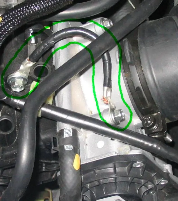

I took goldwing2000's advice and did the tb mod but a little differently and it was real easy.
Instead of goin all the way back to the battery, I figured since the engine is a nice ground - why not use it? This is cleaner and easier. I used a short piece of monster cable and wrapped in black tape to make it blend in better. Then I bolted it to the tb and used a manifold bolt for the other end (the grounding point). Took about 15 minutes.

blondee_yvr said:
The service manager at the dealership saw the write-up from here and the senior mechanic advised against it. There were a lot of issues to discuss about my 3, so I cant remember why they were against this. Next time I talk to him I will ask. But, the bottom line was NOT to install the wire. I think it's best to be safe than sorry and heed the advice.
(sleep)
Anyway, i think this mod isn't really grounding the TB per se, but you're providing a better ground for the TPS (throttle position sensor) instead, which is why mz3 members have been reporting differences in drivability.
Oh, for anyone who didn't know already there are no hp/tq gains on this mod.
flyrevs, are you sure that bolt you used is properly grounded?
thebeansoldier said:
(sleep)
Well if the engine block is grounded, then yes as the bolt goes straight into the block.
It goes into the head, actually. The only issue is that the further you get from the battery, the lower the quallity of the ground. Where you have it hooked up, you have TB-bolt-wire-bolt-head-bolt-block-bolt-wire-battery. Each connection increases resistance.
That being said, I don't think it's going to make a lot of difference, since this mod mainly dissipates static electricity moving through the plastic intake tract. As long as you make the metal-metal contact, it should do the job.
However, if you ever have any real power moving through a ground wire, you want as few connections as possible.
