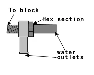

Is the banjo fitting for the coolant line on the back of the block the only banjo fitting required? Do we need copper washers for that? And what size roughly? I think i'm going to order some from ATP or ask Autozone if they have any.
edit: i forgot theres also one on turbo itself.
on the back of the block it is one banjo fitting
the banjo fitting has two outlets though...the bolt has a nipple on it, and the banjo fitting that goes over the bolt has another banjo fitting
like this: -- (if that makes sense)
you do need two copper washers for the fitting, yes
or you could go with a oil filter relocation and run the cooler in between the filter and the block

I'm really sorry but for some reason, I'm not taking in what your putting down lol. I do not have much experience w/ the many types of banjo fittings.
think of it this way
one side is threaded, then the middle has a hex section on it, then on the other side it has a barbed fitting
it also has the connection that slips onto the threaded side with an outlet as well
I'd draw a picture but I'm in class haha
please draw a pic when u get out or post a link to one! i feel so retarded right now. thanks for the help though..
Edit: if all else fails i will just get the fittings from that link and route a line to the turbo myself.
here is a crappy diagram
the light silver piece slides over the dark silver piece
where do both water outlets run too? wouldn't that be for the oil cooler setup so that one routes to oil filter location and other to turbo?
But if I decided not to run the oil cooler setup I would need a different banjo then correct? B/c I'm thinking about waiting on the cooler setup for now.
if you don't run the cooler then use the banjo fitting you linked above
just make sure it's the right size...I'll double check the sizes later tonight

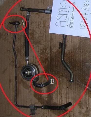

sorry for the continuous posts guys...i was looking through my pics to see if i can visual the banjo you were talking about neon and the one I have I believe is what you were talking about with an outlet at the end. So i was curious if i just go ahead and use that bolt even though the outlet part will protrude from the coolant line (A) and connect the hose in part B to it and seal it with a bolt and plumbers tape and clamp it. seems like a much cheaper scenario yes? i would then only need to purchase crush washers in which i could basically get at autozone probably. let me know if this is correct.
