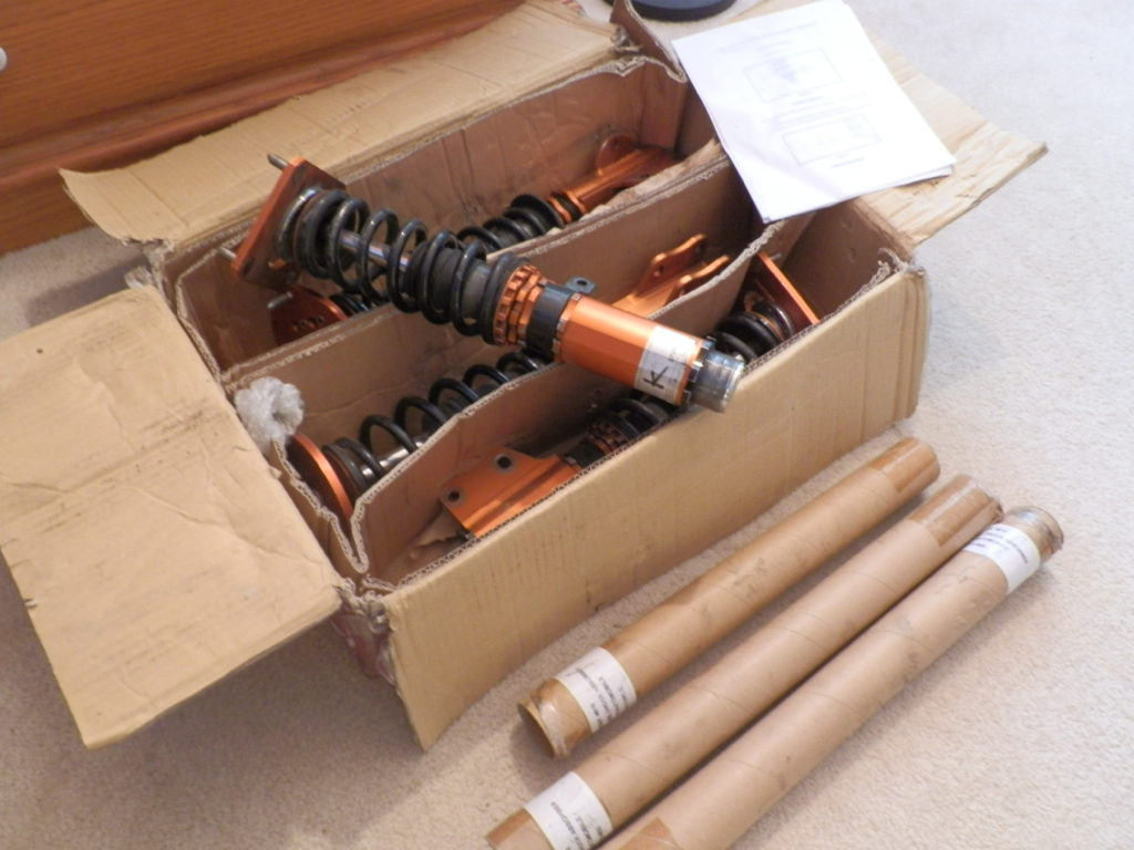

What do you guys think should i install coilovers first then wheels or the wheels first then coilovers. Reason im asking is i only have enough to fund one at a time. :(
^This!
Coilovers will allow you to run different wheel in some cases.

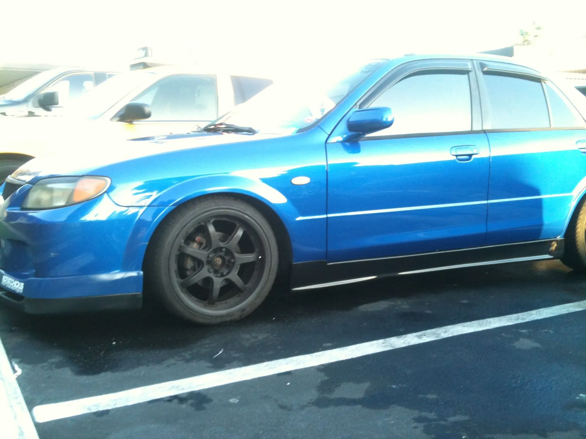

Lowered it more, more camber, adjusted the rear link kit, and got an alignment ... I am seeing 205/40's in my future in the next couple months....
There was a stock (maybe on springs?) P5 at the shop where I got my alignment... so I took a comparison pic
I love when you get to take a picture next to a stock version of your car so everyone including yourself can see how far you have come. Love this pic
Thanks man! I can't wait to get her fully finished and find a stock silver P5 to take pics with LOL
