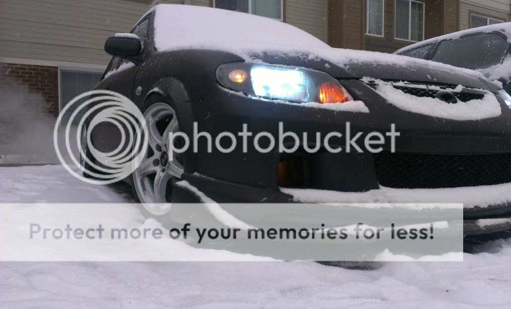

Lowered it more, more camber, adjusted the rear link kit, and got an alignment ... I am seeing 205/40's in my future in the next couple months....
There was a stock (maybe on springs?) P5 at the shop where I got my alignment... so I took a comparison pic

Dirty car is dirty... really happy with my rear fitment though... can't wait to get 205/40's so I can actually drive it at this height without destroying a fender in the front LOL...
Yeah once I go smaller tires, I'm either going to remove some camber in the rear or push the AAC links out more LOL
IIRC dont link kit push lower portion of wheels out to gain more clearnce at top for more low? If thats the case PUSH OUT lol
Pushing the links out pushes the entire hub out more. With the added clearance of the smaller tires, I can push the wheels out a couple mm :)
