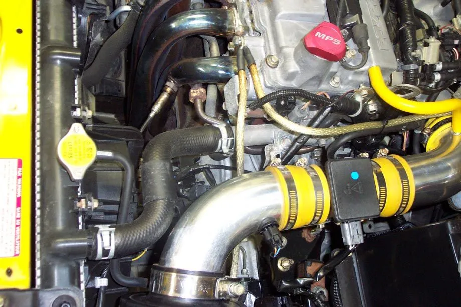

Water cooling...?
Okay now I am curious about the water cooling of this unit. There seems to be conflicting opinions about the need to utilize the water cooling. Seems to me that if it was designed to accept water cooling, then it should be used. Any specific issues that should be addressed? Also, I would like to see some good pics of anyones P5 application or at least a clear description of how it is hooked up. Maybe a "How-To"? :)
azeli73, it looks like you have a good setup, but it is not the same as my P5...
Damn! I'd go that route if I had known of them. I had a friend weld a bung to the coolant feed. the return line has a bung welded to the thermostat housing.
Only picture I have is this. No digital so I can't get you new ones. sorry.
http://www.msprotege.com/members/azeli73/April24th2005/14.jpg
RyanJayG said:
if you want to cool a GT2* turbo, use these fittings. http://www.atpturbo.com/Merchant2/merchant.mvc?Screen=PROD&Product_Code=ATP-FTG-004&Category_Code=FTG
its what I'm using. they are nice and tight to the center housing, and use a -6 (3/8" i.d.) hose. I ran them to my TB cooling loop.

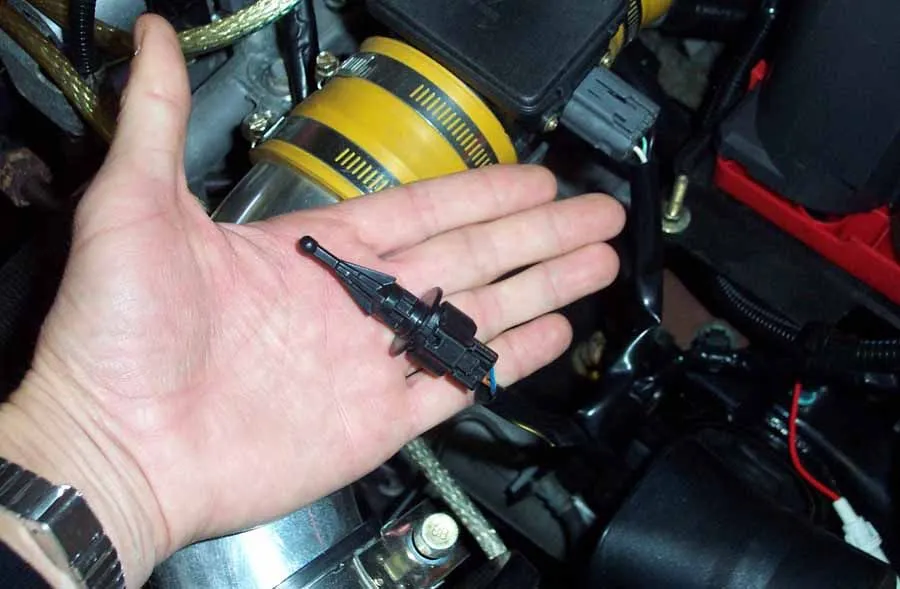

Dumb Question #11 :-)
I cannot find any reference to what is done with the IAT sensor for the install of this system in the instructions.
Anyone?
stick it down in the filter... run the wires between the going into the filter and rubber around the top of the filter
Anyone?

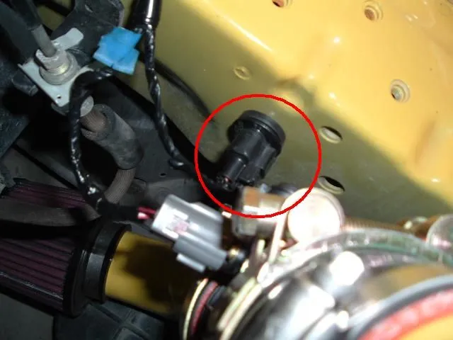

Y ou could install it into the space before the driver's side fender. There is a hole in the side that the sensor and gromet fits into perfectly.
Hmmm, am I correct in assuming then that it is not a critical part?
The filter sounds like it makes sense, but putting it in the fender well would not give an accurate intake air temperature. Or does it even matter? :confused:
Putting it in the fender will give the ECU a little bit of a cooler reading and thus give you a little more fuel, that's the reasoning of putting it there. (thumb)
